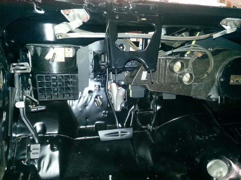

Oh and here's a slightly better picture of all my under-dash stuff in, got the brake pedal all bolted in and rigged up. Hard to get a decent shot with the lighting but I'm loving the satin black on everything

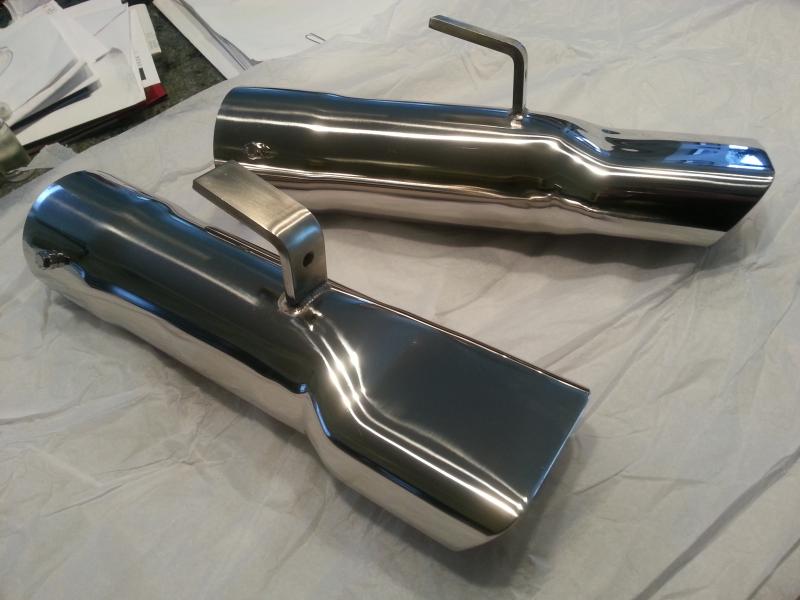

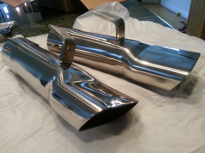

And I looked around online for discount code but didn't have any luck, just a bunch of expired black friday codes. But with shipping I think I paid like $130 or something for the pair, so not too bad I think and worth it to have such sharp looking correct tips compared to an "off the shelf" muffler shop special haha

I like both of the wheels you've chosen "should look good in your black cockpit" and love the Super 40 sound (had them in my last car). Your under dash looks great, I know nobody will ever see it but it gives you a little piece of mind knowing it's done right and looks great anyhow. Looking Sweet
Thanks Devin! Thats for sure, the peace of mind is worth more than anything knowing it's all done right and not all rusty and cobbled together haha. I'm kindof leaning towards the 1st steering wheel with the lightening holes since I'm planning on machining some interior door handles with similar holes. Might tie it all together pretty well :shruggy: I just don't want it to be "too much". And that's good to hear, my buddy at the exhaust shop has 40's on his 440+6 '68 Roadrunner and it sounds awesome, no drone complaints from him either so we'll see!

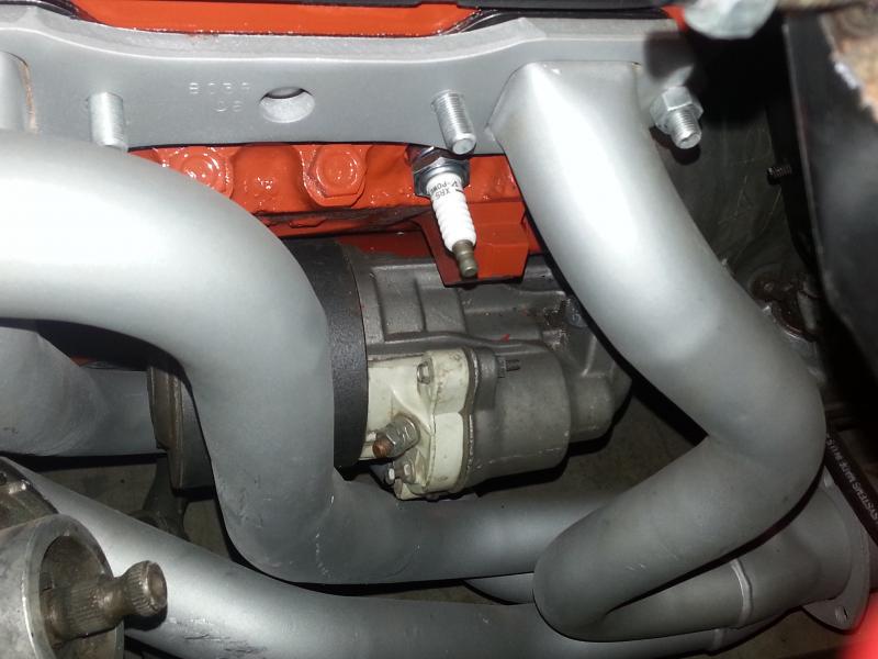

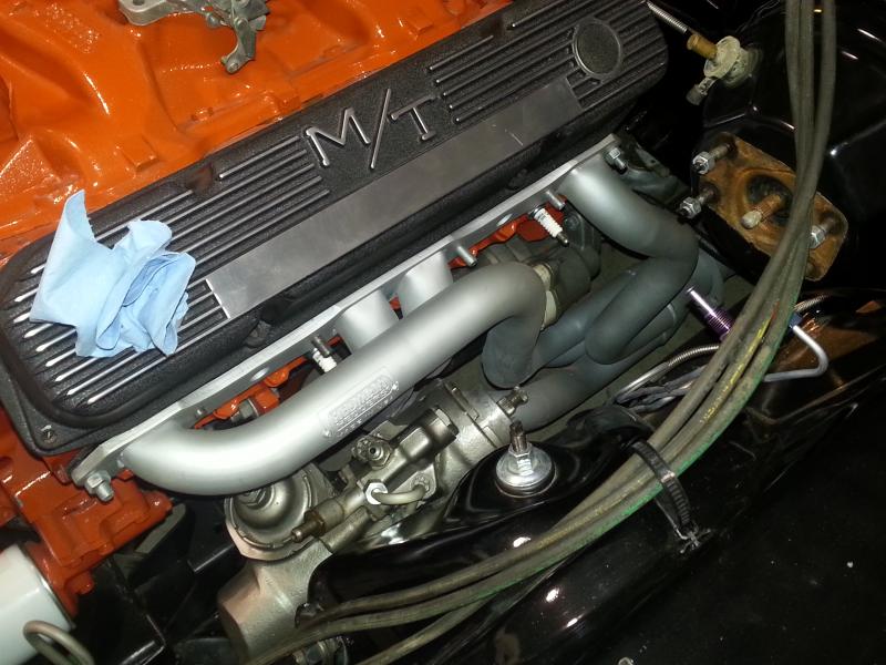

Alright, one more question for everyone to wrap or not to wrap? I'm picking up a roll of 2"x50' black header wrap from Napa later and was planning on just wrapping the area of header around my starter since there's no way in hell a heat shield will fit, and I worry about a starter blanket actually holding in heat with the hotter temperatures of summer, long driving conditions etc.
But now I'm considering wrapping both headers entirely (might as well?). Figure it'll help underhood (air intake) temp and help protect my starter. Is this a good idea? Does it work well? Is it a pain in the @ss as far as wanting to come undone? Opinions on how itd look in my engine bay? Any experiences with it, opinions, etc anyone could share would be appreciated!

I wrapped mine for two reasons #1 like you mentioned the heat insulation #2 I can't afford stainless or ceramic headers and hate rusty exhaust haha "it does look really good thou". Be prepared for allot of smoke off of them, itchy hands and be careful around the stainless zip ties if trimming them "they're like little razors". I'm also planning on making my own door handles so I'll have to keep my eye open for what you come up with.

Thanks for those links Brian, I actually meant to ask about the corrosion problem in my original post. I don't plan on driving through any monsoons, but it still seems like a valid concern.. with how close my starter is to those headers I really need to do something though. :thinker: maybe I'll mess with some cadboard as a heat shield template and see if it's going to be as impossible as I thought. Or maybe just wrap the closest parts of the header closest to the starter?

You're really moving along Speedy. I don't know to think about the header wrap, it seems most people say the wrap holds condensation and makes the headers rust out rather quickly. I ended up buying ceramic coated ones because of this.

I wrapped my headers,also used a starter off 96 dodge 360 p/u.seems to have more room than yours.
That's interesting Charlie, are you running the same hedman headers?
Should have mentioned I'm also running a mini starter "plenty of clearance". I've heard the same about rotting the headers out but if they are going to rust "which they will anyhow" I at least don't want to see it haha. I'm honestly just doing it to buy me time until I can buy either stainless or ceramic but for now it's all about driving it this Spring.
Oh I see, and yeah I'm planning on some ceramic tti's when I tear everything back apart for the procharger hopefully next winter. I'm right there with ya in the "I just wanna drive it!" boat haha. So right now I think I'm decided on just wrapping the area of header closest to the starter and calling it good. It'd be a royal PITA to fully wrap both of them when they're already in the car anyway haha.
