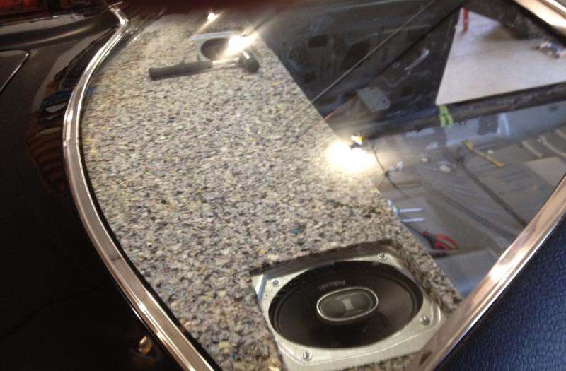

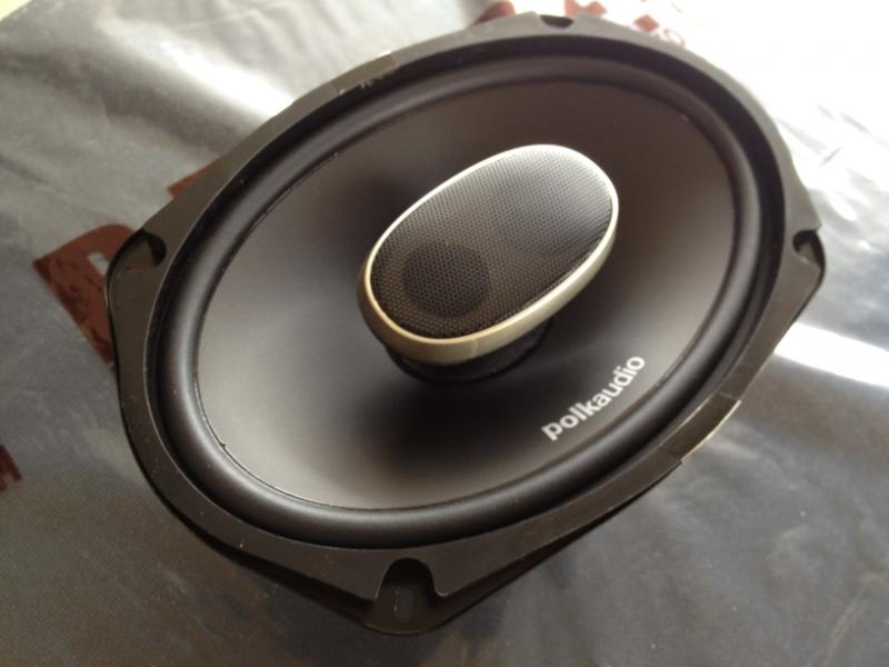

Sound Kickass man! I'm really happy with them. I also put two 4.5" Kenwood Excelon's in the kick panels, two polk audio 3.5" in place of the center dash speaker and a 12" Kenwood Excelon Subwoofer in a sealed box in the trunk. Powered by a Kenwood Excelon 996 head unit w/pandora, Bluetooth, hands free calling, IPOD and USB hookup. There's a Kenwood Excelon 1200 Watt 5 Channel amp mounted in the trunk as well. I went the same route you're thinking......not all thumpity thump, just a really good crystal clear sounding system. I installed a Tuff 100AMP single wire alternator and a Kinetic 1800 High performance Audio battery. Electrical system has no issue keeping up with the system (even at night with the lights on and wipers running). Love here the rumble of the big block under the hood, but it's also cool to dial up the volume knob from time to time and fire up some Fred Bear or Mississippi Queen
