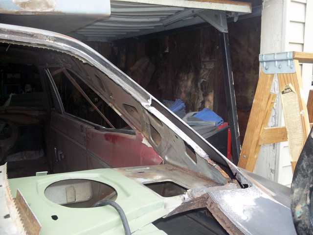

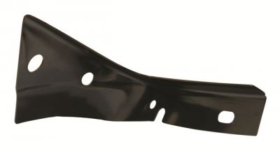

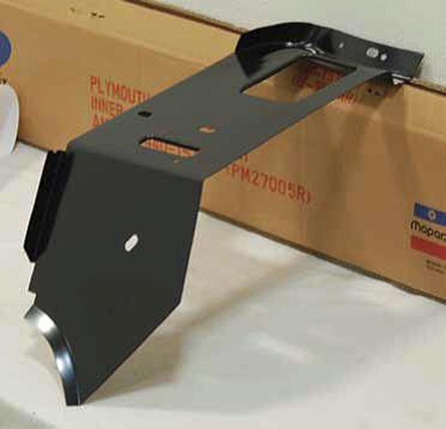

Now it's time to move on to the rear window channel. The rear corners are going to be fun. Including the package tray end pieces there are four parts that make up each corner
From there I'll still have to fabricate the upper window channel.
Fun fun, making some solid progress.

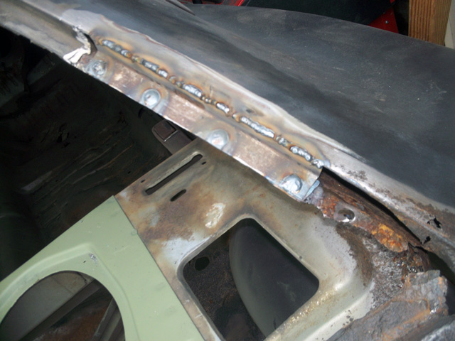

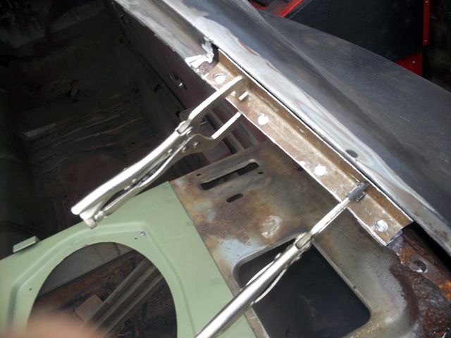

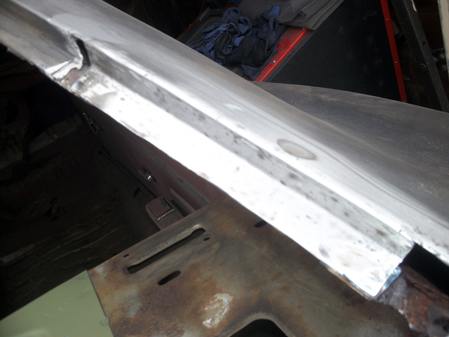

On with the show. I started repairing the rear window channel today. After talking with hunt2elk I may have a way to do the upper corners. here's what I've done so far.

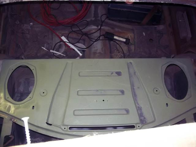

Now that you mention it I'm going to watch Two Lane Blacktop tonight. I just finished welding in the new speaker hole in my package tray. Roadrunnerman sent it to me along with some other metal patches. It arrived today so when I got home from work I started patching it in place. Too tired to take pictures so I'll post some later.
John, glad to hear that you were able to use the metal and can't wait to see how it looks with the speaker holes the same direction.

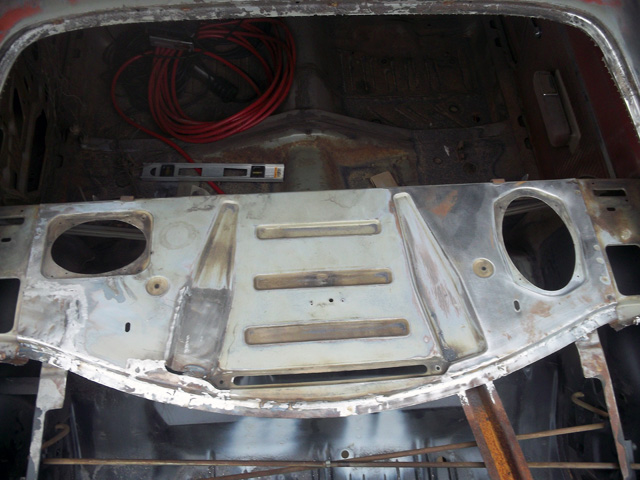

Here is my package tray with the new speaker hole welded in and primered. hopefully if all goes well I can order the shrinker and stretcher from Eastwood and the corner window pieces for the rear window. Fingers crossed :)
The new speaker hole looks bigger than the other one. :BangHead:
Nice job, funny the time spent on little things that you'll never see but like you said "you'll know". I'm the same way.
