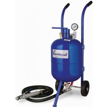

John, Check this out for media blasting.. I bought one and im very happy with how it works, It may set you back a little bit but its worth every penny to get some blasting done quickly.. My compressor isn't very big and its old but if i watch what im doing i can get some work done quickly, working in one area at a time, to blast a whole car? My outfit wouldn't do it, just not large enough.
http://www.eastwood.com/eastwood-50lb-pressure-abrasive-blaster.html
Honestly, I wouldn't use it for that. It would be capable, but it's going to take quite a bit of time/media to accomplish. If you're able to recycle your media, have a good open space to do it and don't mind the several hours + it's going to take, go for it. As a comparison for you, it took me 30 minutes to blast a shock crossmember with that unit. A front header panel on a fairlane took me 45 minutes. I'm running an 80 Gallon two stage compressor that had enough CFM to blast it, but definitely gave it a work out. My water traps, Air/water/oil separators and desiccant filter were quite taxed.
Just from my own standpoint, I have a kinda local shop that will plastic media blast a fender, hood, trunk lid or door and epoxy coat for about $125-200 a panel. When I have the luxury of being able to afford it, that's the route I go. If not, a trusty wire wheel or DA sander, but they do not get in all the nooks and crannies on the parts with a lot of geometry. Don't get me wrong, like mentioned...you could blast a fender or door with that. Just be prepared for a pretty long process.

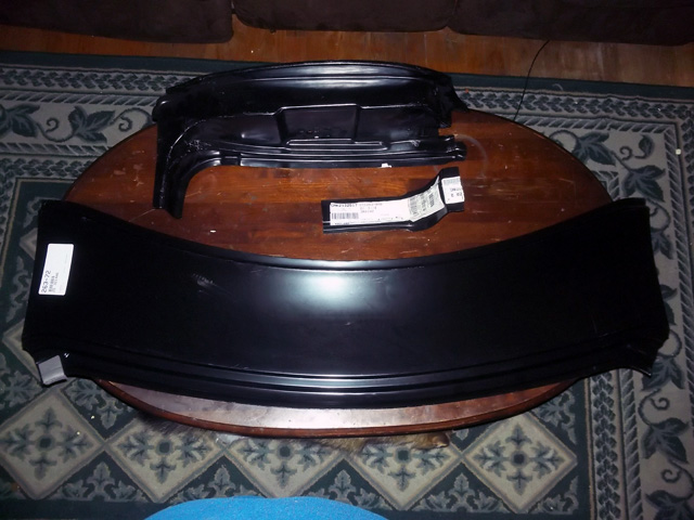

I gots me some new parts today. :) The harness that 747 sent me showed up and I also have a brand new Deck Filler Panel, Right side Door Jam, and a Floor Support. Now I need warmer weather so I can weld. Come on spring!!!!!!!!!
Thats good of Devin to help you out and im with you with spring time, cant wait until it gets here this year myself! Good luck John...
