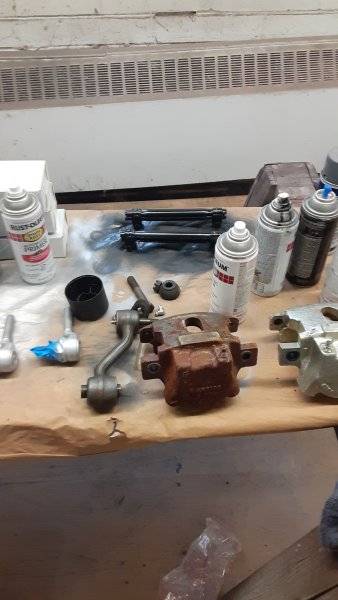

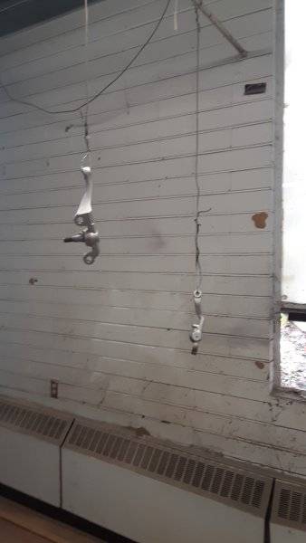

I have been making up for my shameless slacking during the week,by glass beading front suspension components! Pictures to follow!
After I did the rear brakes on my truck and put on my winter tires, I went back to the exciting task of glass beading more front suspension components! I'm literally having a fuc*in blast! Lol
I rounded up all the blasted front end components and will get them prepped and painted soon. I got the bell housing which was already blasted inside and out and just needs painting too. I have the clutch and brake pedal assembly in the blast cabinet along with the clutch fork, hopefully I can blast them tonight after work.

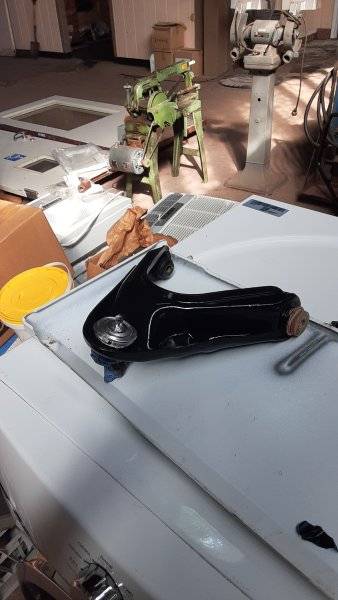

Just a few of the front end parts that have been blasted,cleaned, primed and painted, more are done but are drying.
