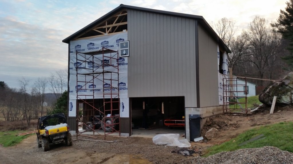

And so it begins..... my new garage

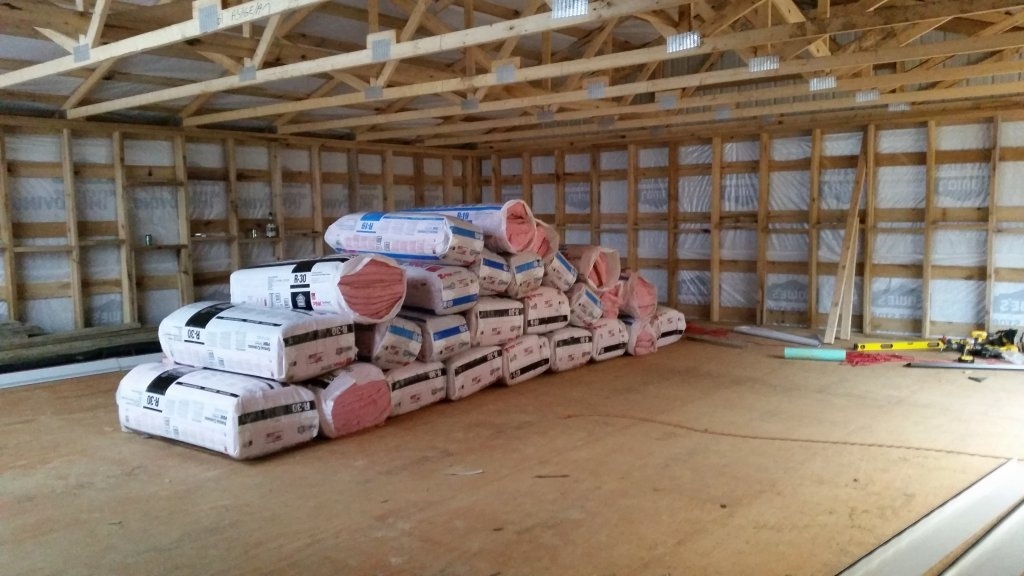

I had help loading all of the insulation into the upstairs last night, looking at that mammoth size pile of insulation just shows how much is left to be done.

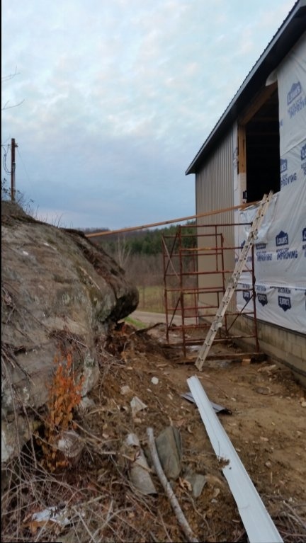

I hope that 2x6 is a #1 grade lol
Lol, I don't think a 2X6 will cut it. I was thinking more on the lines of 2X12s laminated together which no doubt would do it especially if running 3-4 laminated joist length wise. 2X6s would do it if used to build a truss beam like we did inside and would be even stronger yet??? Really thinking about just going with wood after contemplating it, I could anchor angled brace to both the rock and wall reducing the spanned length to around 8ft or so. Thinking:realcrazy:
I really think it would be more appealing on the eye than a metal bridge.
I was talking about the one from the window to the rock. Isn't that the one that was being used as a 'walkway'? lol
I bet other kids at the school are jelly when you give your kids a ride in this beauty.
Ironically kids seam to care more about having me blow the dixie horn lol. Yes my kids beg to be driven everywhere in it which makes my day. Thanks
Ahhhh..... no way in hell I'm walking over that let alone driving!! Sorry, totally forgot about that picture. We actually laid that across to slide the roofing into the upstairs... go figure somebody would walk it.

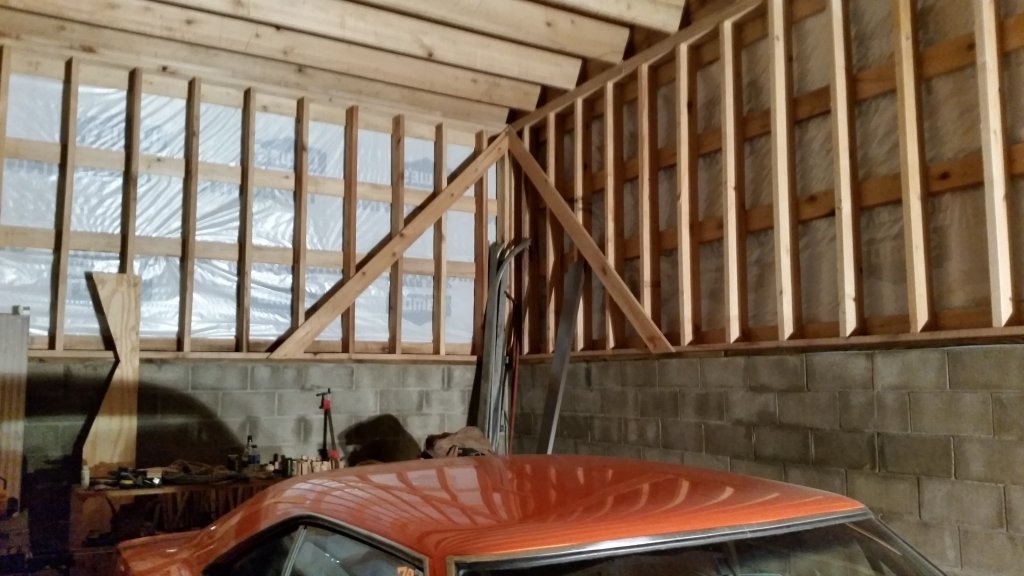

Im just wodering if you are installing any lateral strapping/supports?
Im no engineer but have have been in/around construnction for many years...the concern is about the lateral loads since the walls are so high. Especially the energy transfered to the upper portion if pulling a vehicle in and stopping...
Ive seen sheetmetal ties (10 ") wide 12 ga. strip run from upper corner down to the opposite lower corner... I think it is mainly for wind loads pushing against the sides which is a lateral load of sorts..

I know exactly what your saying and have already been thinking about it. Stopping a 1,200 lbs side by side on a 13' tall wall will tend to move it a bit. I don't recall if it shows up in the pics but I added diagonal braces spanning from the ceiling to the sill on every corner however once the metal is on they really don't add much. With the building only being 34' long it's very rigid but I still plan on installing diagonal braces at least in the area that it will be parked plus where it enters is very close to the rear wall and right over the block post downstairs.

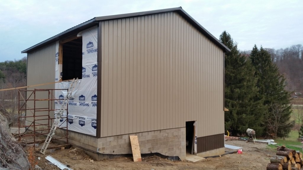

Here's a few pics. I'm really happy with the way it's turning out but really don't like the fact that the only 2 sides I see everytime I look out the window are the unfinished ones.
I really don't enjoy cutting into a metal building to tuck flashing or purlins in so I'll just deal with looking at this until Spring. Everything is there to just tie in and run with it, even the door is framed under the plywood.

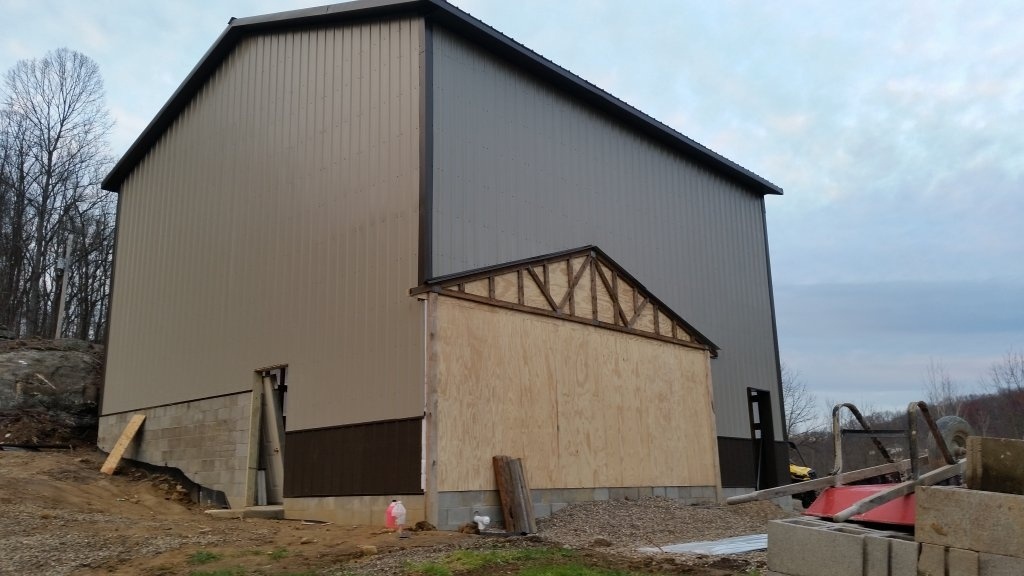

Here's a better pic of where the bridge will be, it should sit almost perfectly level once you figure in the height of a beam sitting on the rock and even with the floor.
