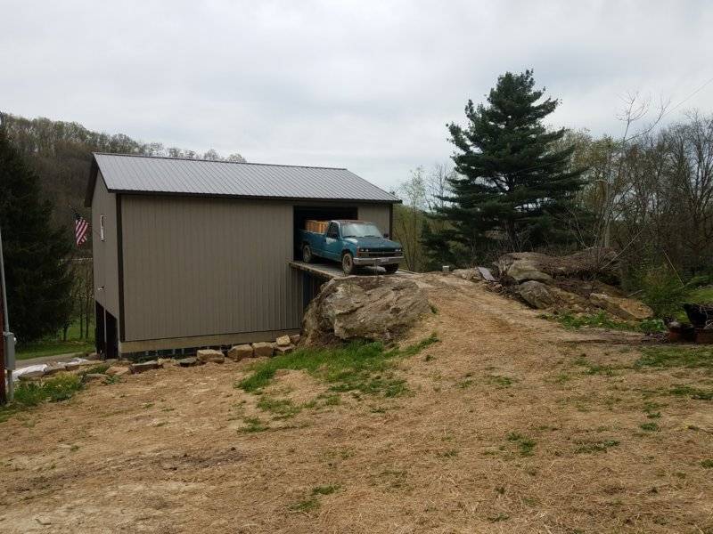

Thought I'd move the bench in today with the floor being done but had no help so why not just back the truck right into the garage where I can load it myself? The bridge has officially been ODOT approved lol.... or BSH approved as my good friend Larry would say. It was built for a 1,200 lbs Can Am, guess this means it's an overkill but I always figured there would likely be a truck or tractor on it at some time.
That is always a good thing
Last house the brother inlaw designed the suspended slab with a 5000 lb point load and said you may jack the truck up when it is loaded
I knew it was good when a railway bridge builder said it would hold a D9 cat
AND a good start point for kids to sled ride down towards driveway in the winter.

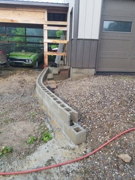

Nothing impressive but did decide to start on the side entrance, tired of the stairs. This will get back filled with gravel then whenever the apron out front is poured it will wrap around the side... no stairs:thumbsup:.
Never fails, I have a curse... my concrete work always summons the rain. It was a beautiful day so I dug the footer, rounded up the supplies and started mixing and no sooner than I got it mostly poured the sky opened up without warning creating a mess. I quickly threw loose tin on it and walked away cussing:mad:. I came back after it quit and mixed a dry batch to help thicken the mix back up and called it done. Next day was another beautiful so I started laying the block and wouldn't you know it it cut loose again:BangHead::BangHead:. I shoveled dirt in around what I had done to keep the rain from puddling and said piss on it!

When I dug the footer for my retaining wall I had a ton of water pouring into the footer, no biggie it's been raining and it is under the roof right?? Not so, I decided to lay another coarse and add another footer and whataya know more water:BangHead:. My first suspicion was that I had a hole in my footer drain pipe... nope so I kept digging and found this! The water is dumping out of a hole in the block foundation:BangHead::mad::realcrazy::nutkick::(
If you haven't followed this thread I live on an oasis, freaking springs everywhere where drainage is always a problem. I sealed the foundation walls tight with heavy water barrier and dimple sheat then put 6 mil plastic under the concrete which has probably 20-30 tons of #57 gravel under it. Because the footer ditches were also back filled with clean gravel I don't think this will be an issue? I believe if I knock a 4" hole in the block, dig in a ways and put a drain pipe under the slab I'll be good. While laying the footer and block all of the springs drained as they should so my only guess is one redirected itself under the footer? Zero signs of any moisture inside so that's my plan. I'll get a better picture of the hole once I get it drained better to see if the hole was from freezing or maybe bumped with the Steiner bucket, whatever the case it's good that there's a hole otherwise I wouldn't know I need to add a drain. The big bummer is this means installing yet another drain away from the driveway!
