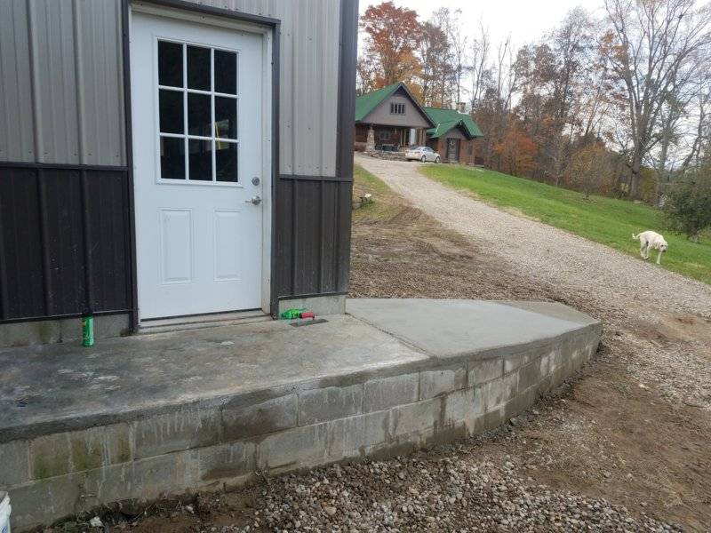

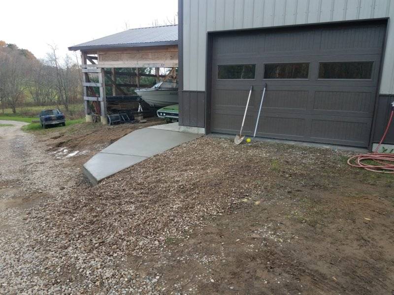

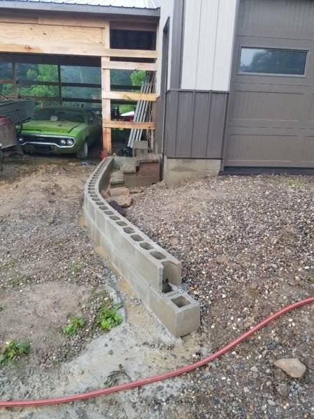

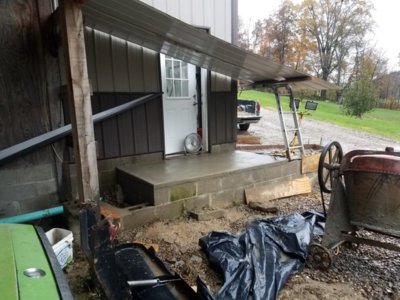

A little progress, broke out the old trusty mixer (my grandfather bought) and took care of another project. I didn't like the steps going into the garage so I put the block wall up earlier this year but never had the funds to pour the apron, with winter coming I couldn't leave the blocks exposed or I'd be redoing those too. 2 truck loads of gravel a huge truck load of sand and lots of Portland cement and it's done. I sure hope funds are there to finish the addition next summer.:praying:

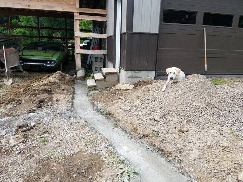

Oh yeah and the curse of the shovel lives on, first pour required a make shift roof because it rained the whole time I was pouring... I was drenched!:mad:
Amazingly it didn't rain a drop this weekend so that was a huge relief, rain the rest of the week though:BangHead:

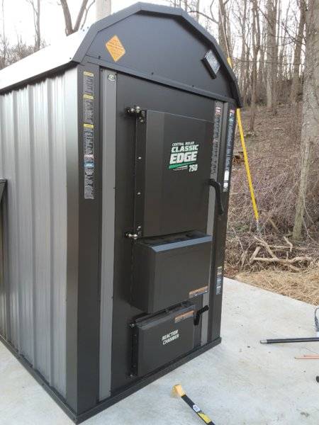

Milestone met!!!! I now have heat and not just temporary.
Here's the heat source for those who didn't see it in an earlier post. It's a Central Boiler 750 Edge HD.

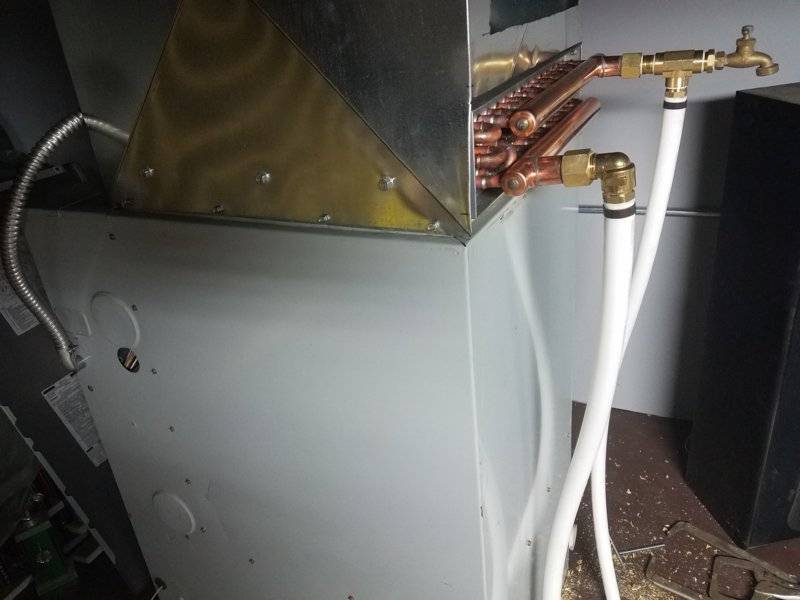

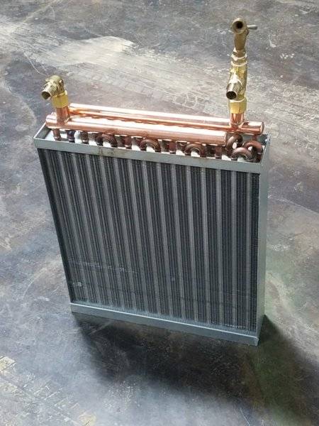

For delivery I bought a 100,000 BTU propane furnace off Craigslist and a 140,000 BTU exchanger (interchangeable with the home). Given the tight space I had to work with I formed my own plenum that hopefully someday will get a horizontal A coil added for air.
The furnace will eventually get hooked up to propane for backup but for now it's wired so only the fan runs when calling for heat. I had concerns about heat distribution, not anymore... a 100,000 BTU furnace can push enough air that you can feel it hitting the opposite wall pushing to the floor!

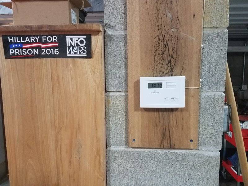

And finally any temp you desire at your finger tip.:thumbsup:

Thought I'd post a video of what the Central Boiler's reaction chamber looks like in action. Basically this thing burns upside down, it burns the wood in the firebox then the unburned fumes go down into the ash pan/reaction chamber where they are burned then pass through the rear heat exchanger. Pretty cool.

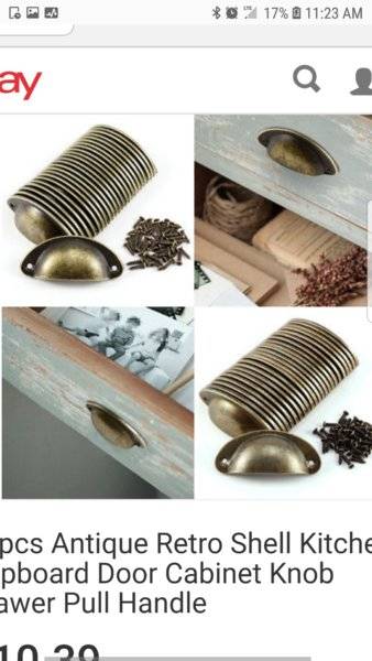

Next week I'll be grinning ear to ear, finally ordered all the drawer slides and drawer pulls to make all 32 drawers useable. 100 lbs full extension ball bearing slides:thumbsup:. This will be a HUGE game changer because I've go crap everywhere and nowhere to put it! I chose these both for the rustic look I'm sticking with and because they should take something falling on them without breaking.
