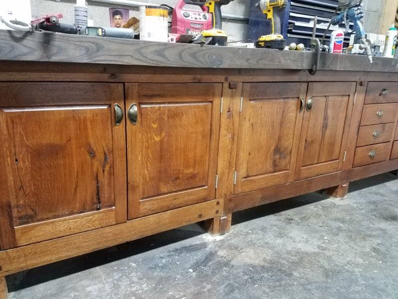

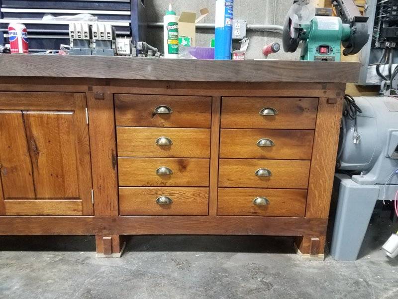

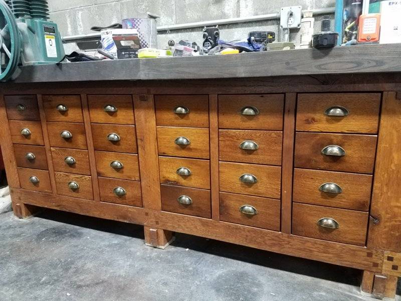

Another milestone accomplished and it feels good! I posted these pictures in my other thread but they need to be here as well.
Man, I'd be looking for stuff for the rest of my life with all those drawers to store stuff in!! Beautiful bench and workmanship.

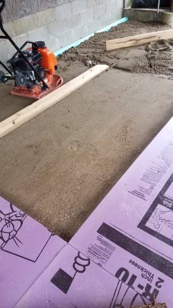

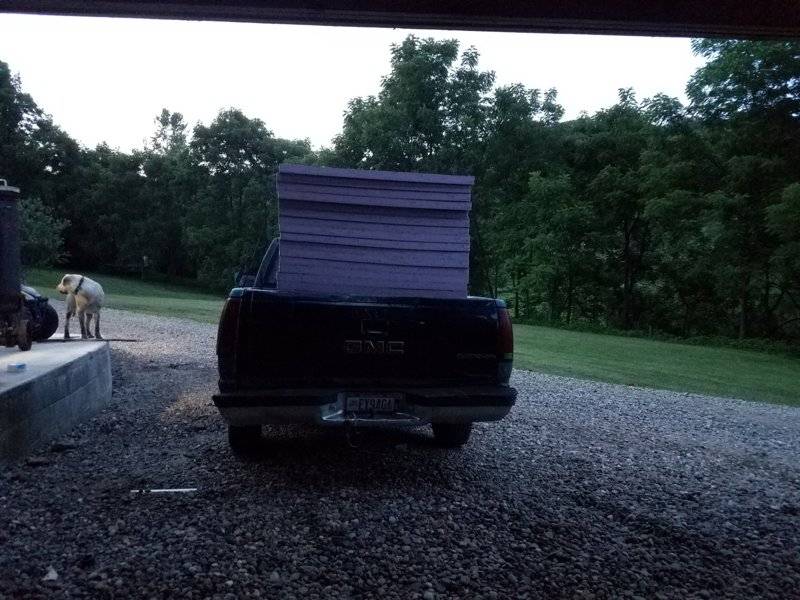

Finally back on the garage, gravel is down and I just picked up a load of foam for the radiant floor. :thumbsup:

The drawers should be numbered and a book with what is in each one. I need to follow my own advice. I have but much more to do!!
I'm going to have to put a drawer labeling system in place, I already can't find anything without opening 10 drawers! We had probably as many in our other shop I just haven't memorized these ones yet.

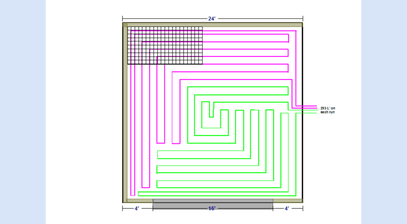

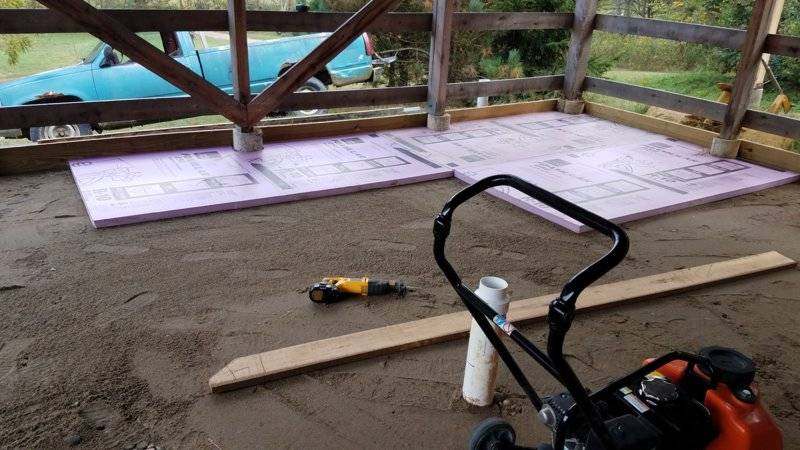

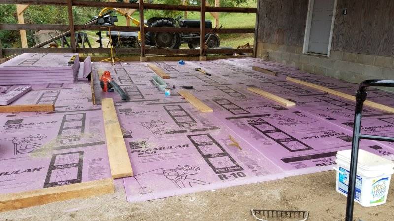

Finally getting the ball rolling again, the addition to the addition is framed and the floor is leveled, compacted and insulated.

I refreshed my memory, here's what I had figured. I was told 1 linear ft of 1/2" PEX per square foot of floor was the basic formula so that figures up to just under 600ft of PEX divided by 3 runs equaling 200ft ea? I'm going to confirm all of this through a few sources but that's what I've got for now. My reason for wanting a contractor out here to look at it is if I put down the wire on top of the rebar there's nowhere to walk? I'm wondering if laying the PEX directly on the 16" center rebar would be adequate? Worst comes to worse I'll build planks to work the concrete from above?

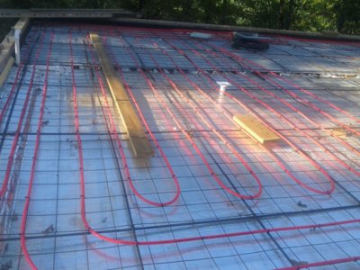

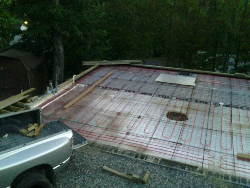

I'm at 4 300' loops on mine...the sq. ft. to linear foot ratio works out close for both your plan and my layout I put in my floor. Not sure about the 3 loops at 200' vs. the 2 loops at 300'...
Do you know where you want the loops to terminate? At what area of the drawing I sent you are you bringing your hot water in at? Once you figure out where you want to install the manifold I can start from there and then return there...
Biggest thing I have seen is you want the perimeter loops closer together as that is where the majority of the heat loss is concentrated...Out in the center the loops would be farther apart...
You might want to look at how your going to buy your pex...mine came in 300' lengths and that was what I ended up using.
Let me know what you decide and I'll try to modify the sketch accordingly...

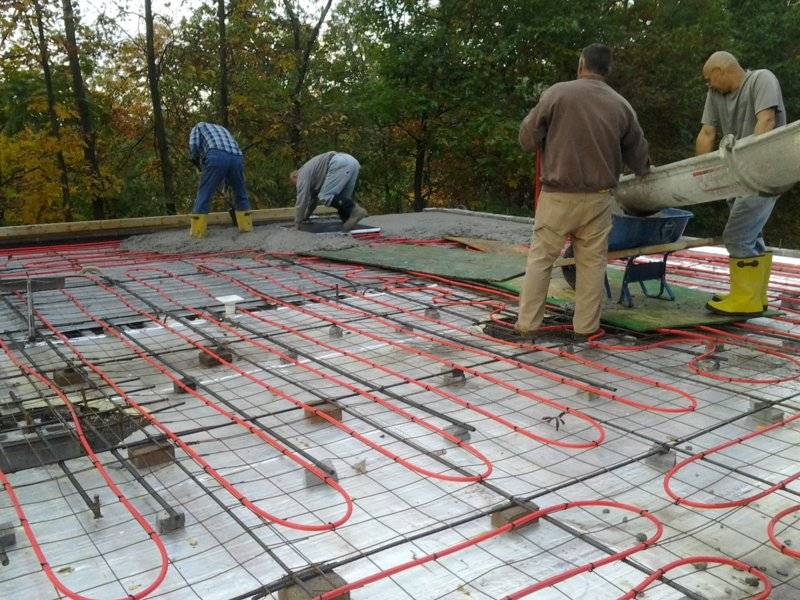

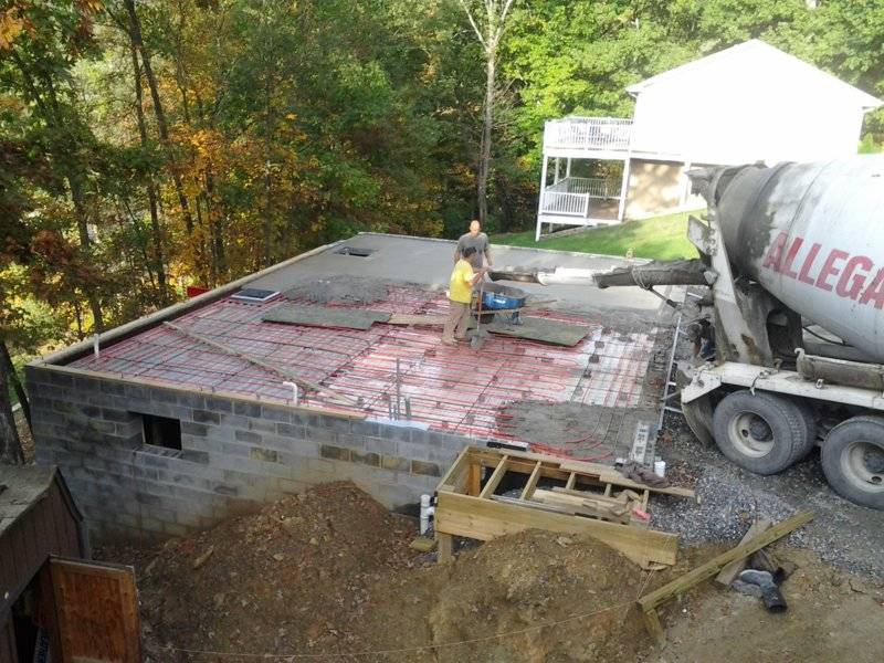

I put my rebar down then added the 6"x6" wire mesh...Ran the pex on the mesh and then after everything was done lifted the rebar up and sat it on bricks to get into the middle of the slab...
They make the rebar stands but from what I've seen they don't work worth a **** on top of the insulation...
We also used some scrap plywood on top of the pex when we had to wheelbarrow the concrete where the truck couldn't reach...

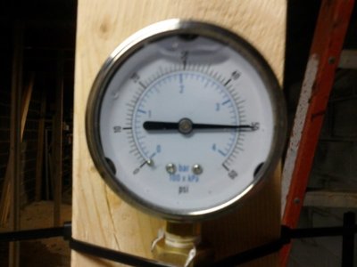

Be sure to pressurize your loops with air the night before and then check it periodically to make sure it maintains pressure....I set mine at 50#'s...
The pex is tough and if you have at least 30psi on it good
