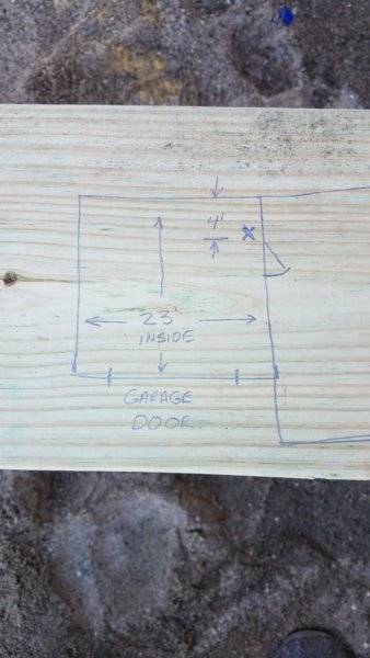

I want all of the terminations 4' in from the back corner and up close to the main garage wall, here's a generic sketch (x marks the spot). This will put it where I can run the plumbing through the mezzanine floor inside and still have it out of harm's way in the addition. I'll likely build a small workbench over the plumbing since I'll need one anyways and it will also protect the plumbing. Garage door is 16' and centered.

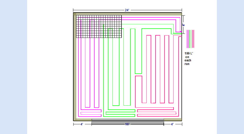

See how this looks to you...
I allowed 4' vertical supply and return for each loop to the manifold...
Each loop came in at 199 linear feet but since you will be radius's and my software can only do corners it may realistically be about 195 or so...
I tried to even up the amount of loops at the perimeter walls but the pink loop may return a slight bit cooler having more exterior wall exposure...This can be controlled with water speed at the valve...
FWIW I was told that in a perfect world your temperatures at the return side should be pretty even...
The 6 loops where they return to the wall where your X was located would be supply at the top and then return of that loop...next would be supply of loop 2 and loop 2 return...return of loop 3 and supply of loop 3 at the bottom...
You can move them around at the manifold however you need them as it won't really affect the overall length...
I try to set them up as supply going to the coldest areas 1st and returning thru the middle of the slab...

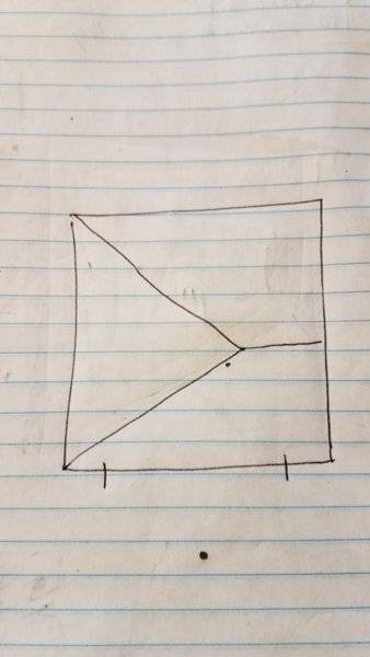

In my head I was think 3 pie shapes where the long side of each run would be on an outside wall then all triangulate back? Another generic sketch that just shows the zones lol.

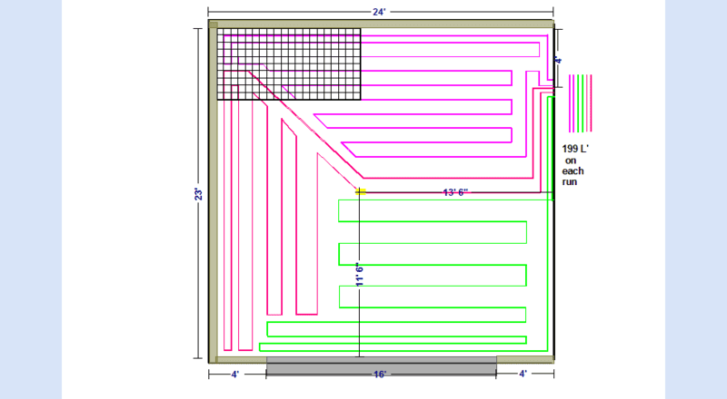

You can try this...Hopefully the 3rd time is a charm...
Note the loop 1 supply is 1st then loop 1 return...
loop 2 supply and then loop 2 return
loop 3 return and then loop 3 supply...all read top to bottom.
The key to keeping this straight in your head and not ending up short at the end will be positioning of the loop 1 point at the location of the yellow rectangle...use those dimensions from the existing building and the garage door to locate that point.
Loops are the same 199 Linear foot each...191 in the floor and 4' each on supply and return heading up the wall... The start stop point at 4' from the corner is what makes it a little more difficult as your loop 2 supply runs through a good section of the slab before reaching the outside wall...ditto for loop 3 against the existing garage...
In the end we very well may be over thinking this a little but I'd rather be safe than sorry...

That looks perfect, not that the other one didn't bit this one looks like the picture in my head lol. We probably are overthinking it but I've seen people install these and think it was a waste of money and people who swear by them, to me that's the difference between someone who took the time to think it through and those who didn't.
The biggest thing is equal flow
Same length and first loop out of header is the last one on return so it is balanced
outer walls with greatest heat loss most important the rest no much

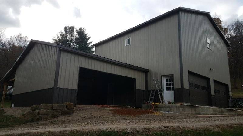

Here's what else got done... sided:thumbsup:

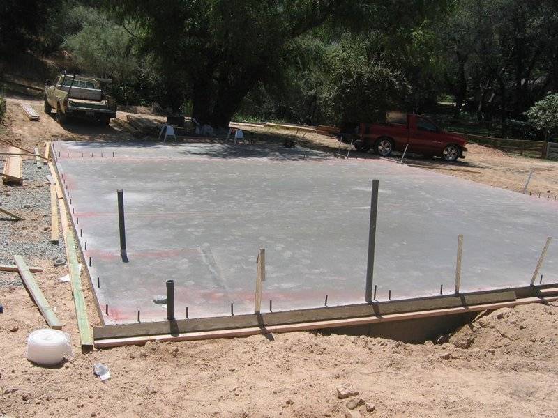

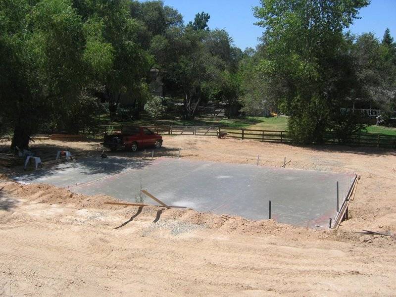

It's a go, the stars finally aligned and the floor is getting poured next Friday!! Next up is figuring out the plumbing so I can get the PEX configuration right where it exits the concrete. This weekend I'll get it back on the rebar chairsonly a lot more of them and play around with laying plywood on it so I know we can safely walk on it.
:bananadance:Finally no more talk about radiant heat.. onto the rest of the garage addition.

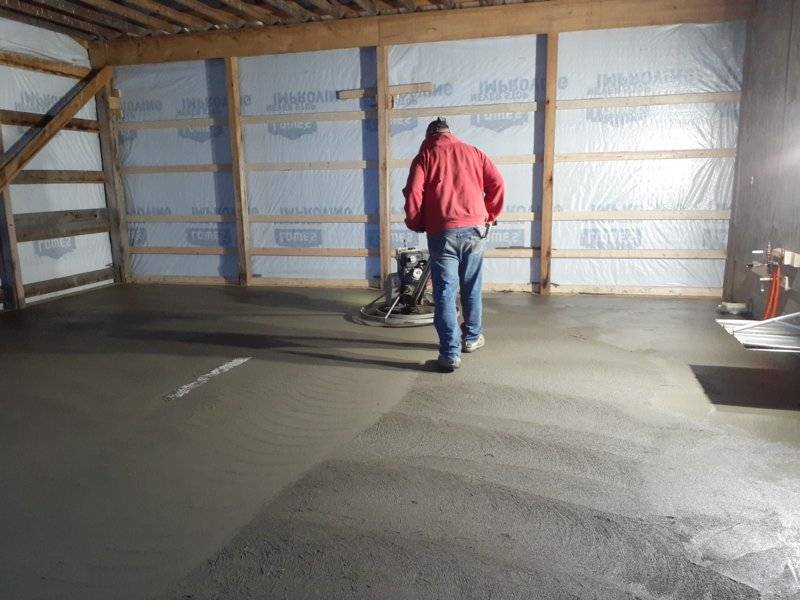

I was stressing out about getting the concrete down while walking on the suspended mesh but it went really smooth. Only hiccup was his power troweler broke a pulley, fortunately he was almost done so it's not even noticeable.

View attachment 874606 View attachment 874607
Why do you guys place the concrete in two sessions?

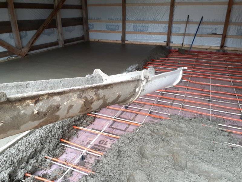

You assume to much lol. The concrete came in 2 6yd batches 30 minutes apart, we poured one side and no sooner than he leveled the first we were pouring the 2nd so no it's one pour. He did it this way to minimize walking on the PEX.
You assume too much lol. The concrete came in 2 6yd batches 30 minutes apart, we poured one side and no sooner than he leveled the first we were pouring the 2nd so no it's one pour. He did it this way to minimize walking on the PEX.
No, my point is that out here, the entire slab is poured before any framing is done. All perimeter walls rest ON the concrete.
You don't have much rain sooo framing and then pouring the stab is one reason. Another is cold weather, they can add calcium to the concrete.
