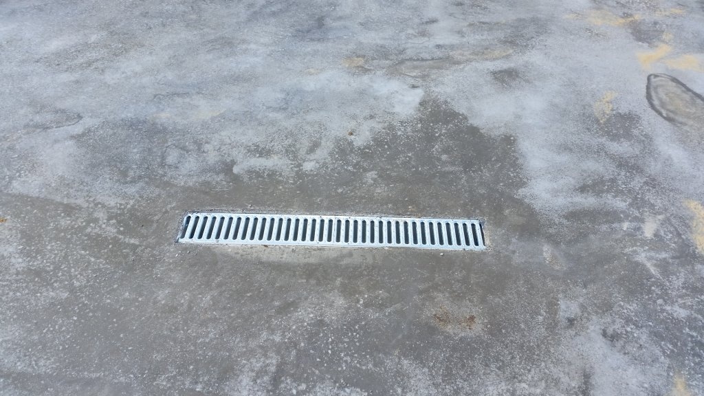

Looking good! And trough drains are the only way to go in my opinion.

I've learned my lesson after trying to push water into 4" holes not to mention the stink that comes out of them..... put a P trap in this one
A little secret is you can take mineral oil. 1/2 cup and pour it down the drain...it will keep odors and critters from coming out of the drain. You can do it every couple of months as a pm...

I see you used a trough drain have to love them
First rain and no puddles you will be so happy

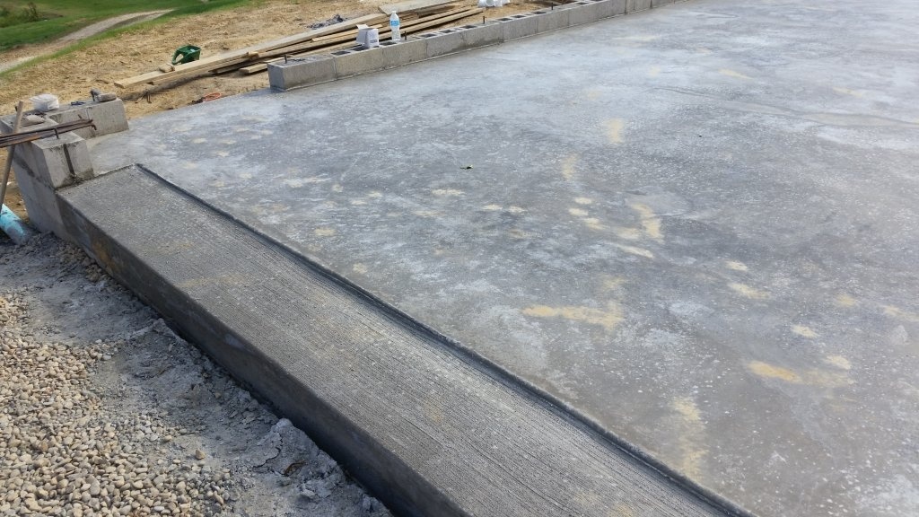

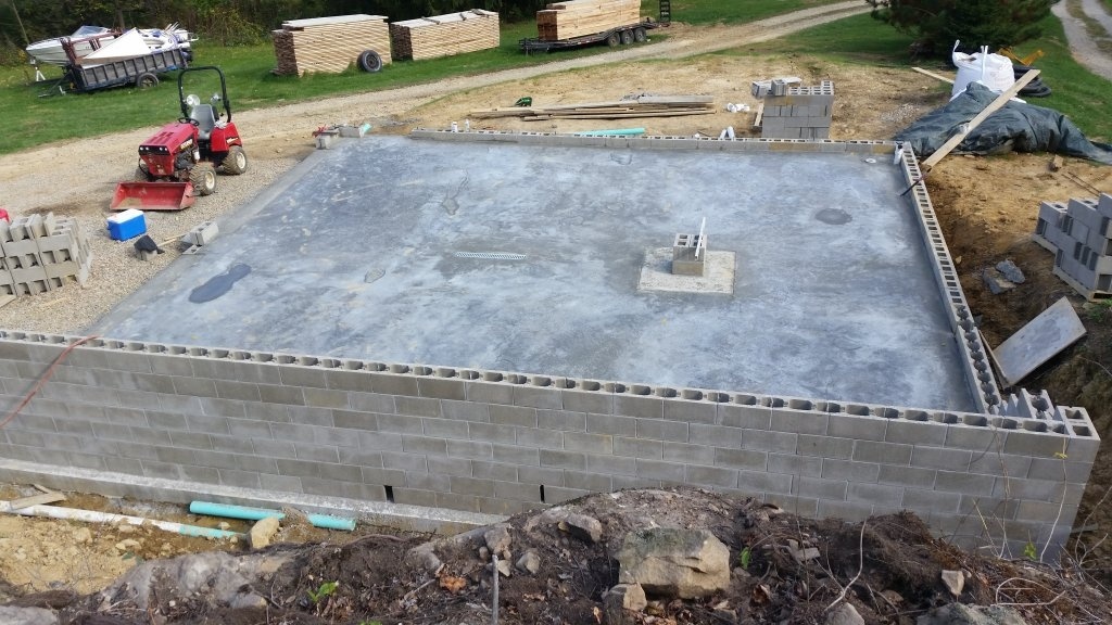

This was a rough weekend, stayed up untill 4:30 in the morning leveling gravel, installing the drain, conduit, water line, vapor barrier and rebar then woke up at 7:30 to start pouring...
Ended up just pouring the whole floor 5 inches thick with 1/2 rebar so it should be no problem supporting the lift, I'll just use epoxy to set the anchors and call it done. As you can see the post survived, thought on it long and hard, just to much weight for a beam spanning 32 ft that also has to support another beam.. I know I'll hate it but whataya gonna do?

Depressing night, I sat down to right out some checks and square away my records:(. I'm spending like a drunken sailor...... on the plus side the extra money has gone to making a very stout foundation but now I'll be cutting it close now. The 24X24 parking garage is off till next summer because of the fill dirt needing to settle but there's no funds for it anyhow although I have the lumber and trusses. Looks like I bought more blocks than I needed so I'll just keep laying or try to sell them???

Plan is lay the rest of the block by Friday then have the walls poured and anchors installed by the end of tge the weekend. Then it's framing time.
I put a level on the floor and it's got about an 1/8" slope to the drain in 4ft so they did well, should drain. I definitely like the trough drain.

As far as the money goes it's been mostly gravel and concrete adding up. The rain washing my footer walls in and the mud ate up gravel then the decision to go with a thicker floor just added up not to mention a **** ton of rebar. Like I said this is the foundation and you don't want to skimp here.

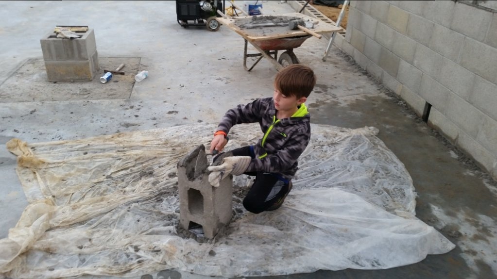

Decided to lay 2 extra coarses to use up the blocks, finishing it today!!!! I'll start filling block afterwards and be framing in days.:thumbsup: My boy came out again and pitched in, he's getting it down.

That's awesome your son is learning to use his hands for something other than a smart phone of video game. Get him some gloves that fit and he'll be a happy camper.
