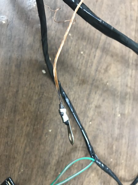

Check out this wire on an Evan’s wire harness that went to the positive side of the coil over the years
I never saw this until I removed the wire insulation . Look at the resistance/heat it caused because of of a bad connection or crimp .
View attachment 1633513Dammmmmmm
