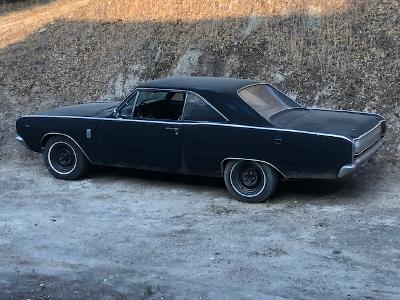

I've had points in this turd since I put the car together in 2005....
Granted, I don't drive it much and not far from home but I've never touched the points in 19 years. The car always starts and runs. Simplicity at it's finest!
