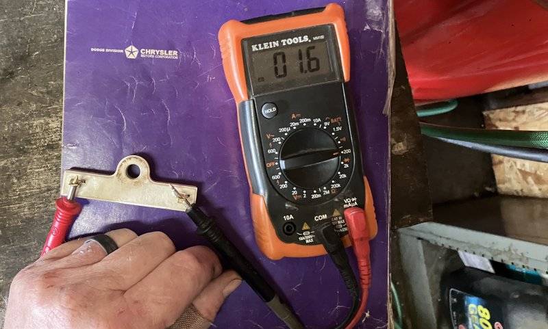

the ballast resistor I use with my Firecore unit is 1 ohm. I imagine Rick's will be 0.8-1 ohm. Does the Rick E distributor have slots with screws to allow for adjustable mechanical advance without welding and grinding to set it?

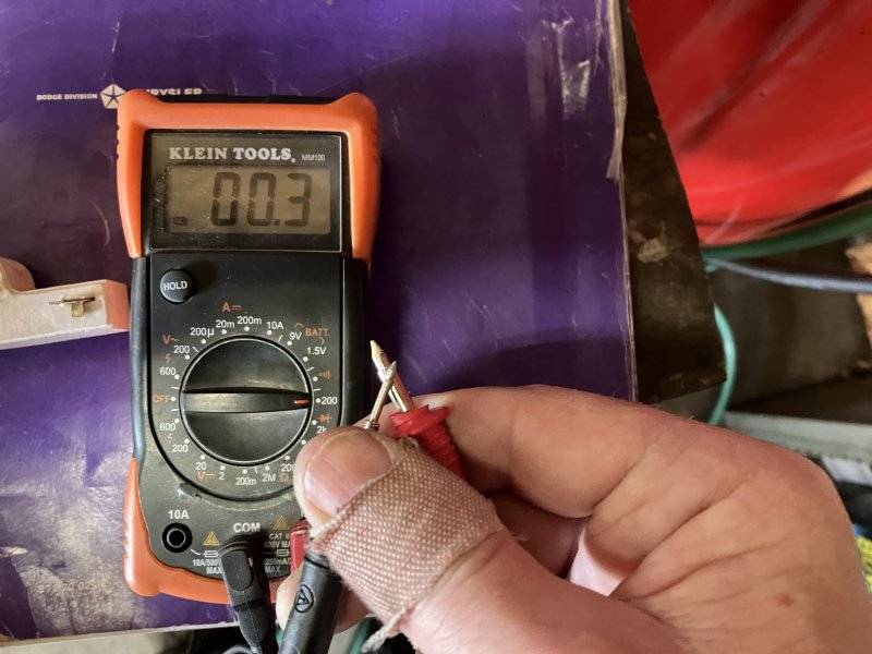

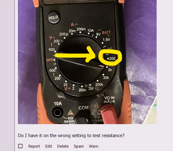

Wild readings at times....lolYes when the meter battery goes down you can get wonky readings
I did have it wrong. I thought the 2K was the lowest setting.
No. Inside it looks like a stock unit. To use it, I would need to narrow the slots. I run 19 degree initial and 34 total. No detonation in 9.8 to 1. I’d need to shorten the advance curve via modifying or using that FBO plate. I’d need to look into that.the ballast resistor I use with my Firecore unit is 1 ohm. I imagine Rick's will be 0.8-1 ohm. Does the Rick E distributor have slots with screws to allow for adjustable mechanical advance without welding and grinding to set it?

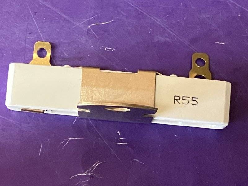

So the Ballast resistor 'R55' is likely 0.55 ohms.I did have it wrong. I thought the 2K was the lowest setting.
Here we go. Here is the one that was in the car. View attachment 1633799
Here is the one from the RE distributor kit.

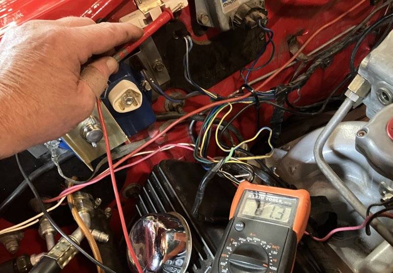

It is strange that the RE ballast tests different than the print on it.
Correct - otherwise you are adding to the total resistance.Roger stated that this is to be deducted from the total?

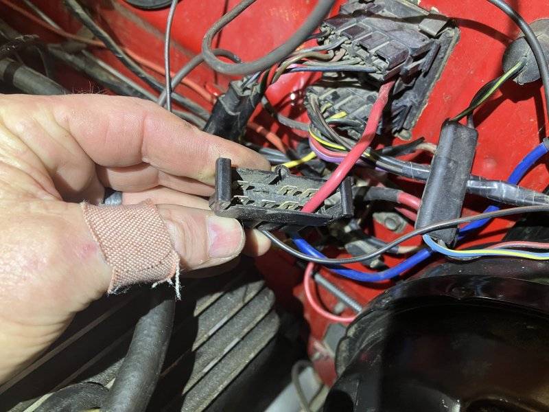

I still think the issue is at the bulkhead connector.
The slightest movement or change in temperature can make a change and either allow or deny you the ability to start the engine.
Dry here too but is the thinking to displace moisture or take up slack or both. The female could be “mushed a bit and the male maybe enlarged to carefully. I know they sell that harness but if you need another I have a good spare for ya just DM me and I’ll get it out to youI just read a tech topic response in Mopar Action that the terminals need to be cleaned and the pockets filled with some type of grease, even Vaseline. I know some if not all new cars did. Mine have always been dry.

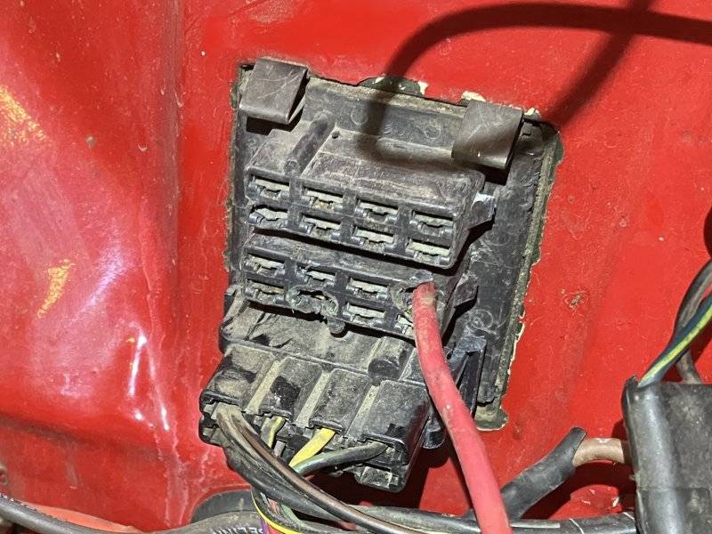

Check block two second from left looks pushed inHumidity isn’t bad here.

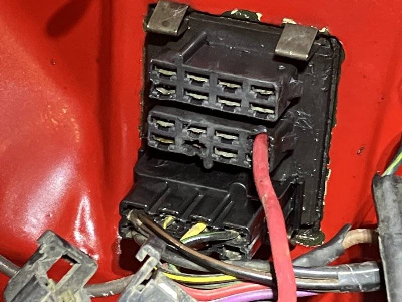

Here is the bulkhead as I unplugged the top two plugs.
It looks dusty but not corroded.

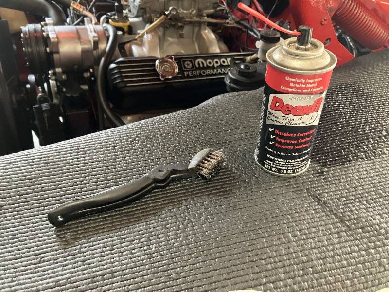

I had this stuff…
Okay, that does look better. Off to get that grease…
