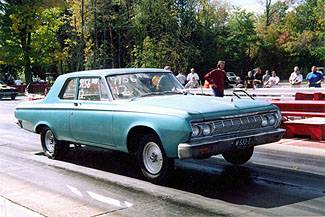

Nice job Paul ! Feels good hitting every gear perfectly and getting a win to prove how good you are at rowing the gears. In the early 90's I went 11 rounds for the win at 42 running in Pro-ET . What a great feeling that is.
Gus
Wow that’s a lot of shifting!
What were you driving back then? My friends growing up and I raced a little at 42 back then, street cars. That’s where I caught the bug for sure. I had the same car but it was still green.
Different era for sure. To put it in perspective, I only had to win 4 rounds, but still didn’t finish until 10:39 pm. I don’t know why everything takes so much time now.
I've had the same Savoy same paint for 33 years and it's always been a stick car. I always drive it to the track and most of the time I can still drive it home. Yeah back in '96-'97 eliminations started at 1:00 and things went pretty smooth because I was home before dark that day. I was running mid 11's back then.
Gus
