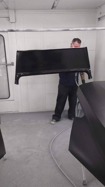

I stripped the e-coat off the quarters, deck filler and valance corners, and sprayed with epoxy primer. I took it all the way to bare metal. I know, I probably could have just scuffed them up but I wanted no possible problems.

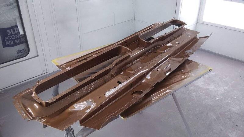

Then I got some single stage color sprayed on the back side
I will get color sprayed on the back side of everything I can.
No one else seems to do this but that's what the guy who is helping me suggests.
The quarters will go back to get sprayed color on the back side. But for now they are going back home with me for a wheel well fitment.
Once all the panels are painted then they can get welded on. At least that's the plan

Thanks Pat, it's T7 Dark Bronze Poly
And with a white vinyl top and white bumble bee stripe, I think it will look good

Hi SGT, I had the same question. But the guy helping me says that if you don't shoot it when you have the panels off the car, you will never get paint back down in around and behind all those hard to reach spots. After it's welded in I will have to go back and do some touch up spots like around the burn off from the welds.
And after seeing some of the cars he has built..... well all I can say is HE IS THE BOSS!
Nice to see color going on!
Yes it is quite a WELCOME change
Actually the only spots that will need "special" attention will be on the tail panel, where it will be welded to the trunk floor lip. This will be the most visible area.
All the other welded burn spots will be along the perimeter of each panel and will not be seen.
These perimeter spots will still get touched up but will not need to look good.
All of the burned painted spots will get wire wheeled back to bare metal. Then they will get coated with epoxy. The tail panel along the trunk pan lip will get sanded smooth, then resprayed.
At least that's what I am told. We will see............
