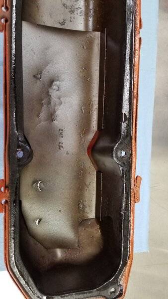

So I need to get all this stuff settled, but first I need to deal with the valve covers. Yes, you warned me about potential interference :poke:, and so we checked it twice and there seemed to be no issues when turning the engine by hand. However, we hear something under the breather - probably the baffle below the breather that is not providing enough clearance.

One of the things I said in an earlier post was how qkcuda had warned me about clearance with the valve train and stock valve covers. Well I twice turned the engine around by hand (each time a full rotation) to listen/check for issues, and didn't hear any. Therefore, I assumed I was OK. Well, I was not - live and learn. See pictures below. Now remember, I have a really crappy, beat up set of 70 valve covers (I have been looking for new ones for quite some time) but you can clearly see the deep new marks left by the valvetrain. 4 on the one valve cover, 3 on the other (the previously bashed in part saved that valve). In all cases, the interference was with the baffle.
I put the PO's valve covers on (I actually think they look really nice - just not the "stock" look I was going for). I have decided I am done with my old beat up valve covers. I will buy a new set from AMD and modify them to fit as needed. This way, I can take my time doing this as a separate project without impacting my ability to drive around. (Note I still have the blue painter's tape on the coil wires in this picture so I can quickly remove and replace the wires.)

My concern now is that the engine still seems "noisy". It sounds a bit like a solid lifter engine. I'm worried I may have impacted a few pushrods with the valve cover clearance issues. I am considering pulling a valve cover and checking one side of the engine's pushrods. Appreciate any advice or thoughts anyone has. I realize that the engine might be 100% fine - it is not my stock 383! However, I'd rather be careful just in case.

It looks to me like you just hit the baffle plates with the pushrod end of the rocker.
Why not just take a small hole saw and pop some holes where the witness marks are?
Seems like that would solve the problem.
It's possible you bent the pushrods but I doubt it.

Hawk, the valve train was always noisy since day one. Part of it is the lifters. Part of it is the Crane gold rockers. They always had a sewing machine sound at cruising speeds. I'm sure the pushrods are fine, they are heavy 3/8. You may want to adjust the rockers, it has been a while. The other thing you may be hearing is piston slap from the super short skirts.

Thanks Don. I had the exact same idea, but then just figured I wanted to spend time modifying a nice set of valve covers. These are 1970 valve covers, but they were rusty and really beat up when I got them. I figured they were better than nothing (and they were), but I really don't want to spend any more time with them since they are in such bad shape. I will get a new set and modify them.
Awesome - thanks! This makes me feel much better. I didn't think the marks looked too bad on my valve covers, but I have learned that sometimes looks can be deceiving!
I will put the rocker adjustment on my list of things to do. My father-in-law said they seemed fine, but he just did a quick "feel". He also checked out the pattern made on the cam and lifters and said everything there also looked really good. Having said that, it is always good to double-check.
