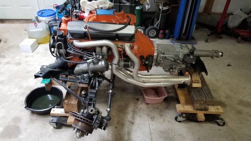

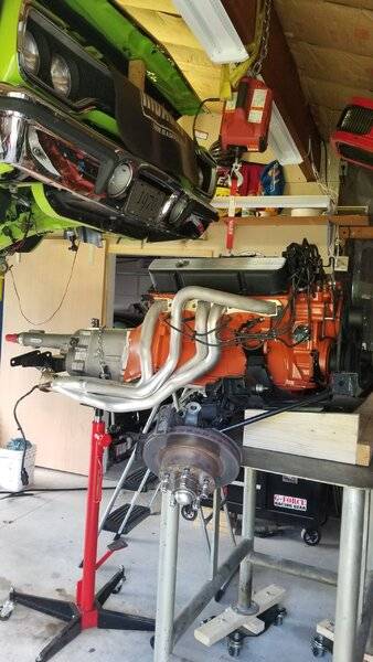

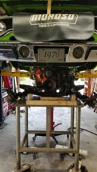

Here are a few pictures dropping the K-member. This time, I decided to drop it on to my welding table. This way, I didn't have to crawl around like a worm trying to loosen and remove the final bolts. It worked great!
Below is a view from the back. The K-member is on the welding table (with 4 car skates to move it around), and the transmission is on a regular transmission jack.

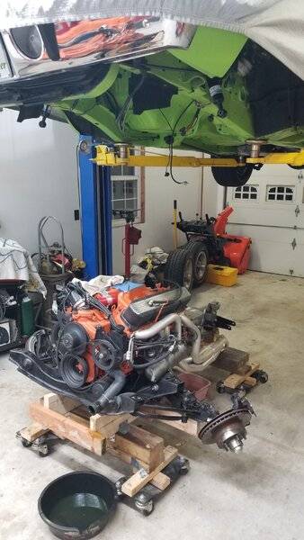

Here is the setup from the front of the car and after we pulled the whole assembly forward.
We simply unbolted the bellhousing and pulled the tranny straight back, and then lifted the engine and stuck it in a transportation cradle. Monday after father's day I will bring it to my father-in-law's shop and we will replace the rear main seal and change the cam. Then time to throw it all back into the car!
