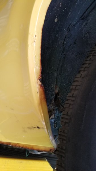

I fixed rust on it in the early 90s and it was then a daily driver for my son for 7 years, used in snow, salt, etc. The rust has returned and it has a small spot on the door, and rust around both wheel wells. Don't get me wrong, it is still a solid car, and we drove it over 11,000 miles with its stroker 340 last year. But the body definitely needs some attention...

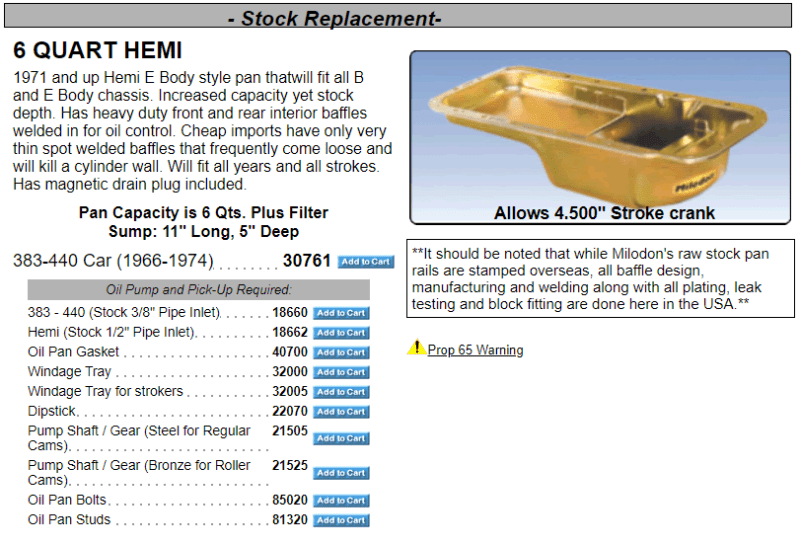

One last thought Hawk. Do you think 7 quarts of oil is too much? I know you said you had a deep pan, but wouldn't 6 be enough? I ran 5 in a stock pan.
I say 7 quarts, but the pan holds 6 plus the filter. See pan below.
I am still using my stock dipstick in the stock location, and I have filled oil until it reads full (and no more), so I wouldn't think the level would be too high. With a high volume oil pump, I really don't want to run the engine lower than that. I think I'd rather have a little oil leak than starve this beauty of an engine of oil. I obviously must have screwed up when I installed the timing chain cover. So hopefully a wintertime project to get this right is in order. It's a painful lesson learned about sealing up the timing chain covers though... :rolleyes:
