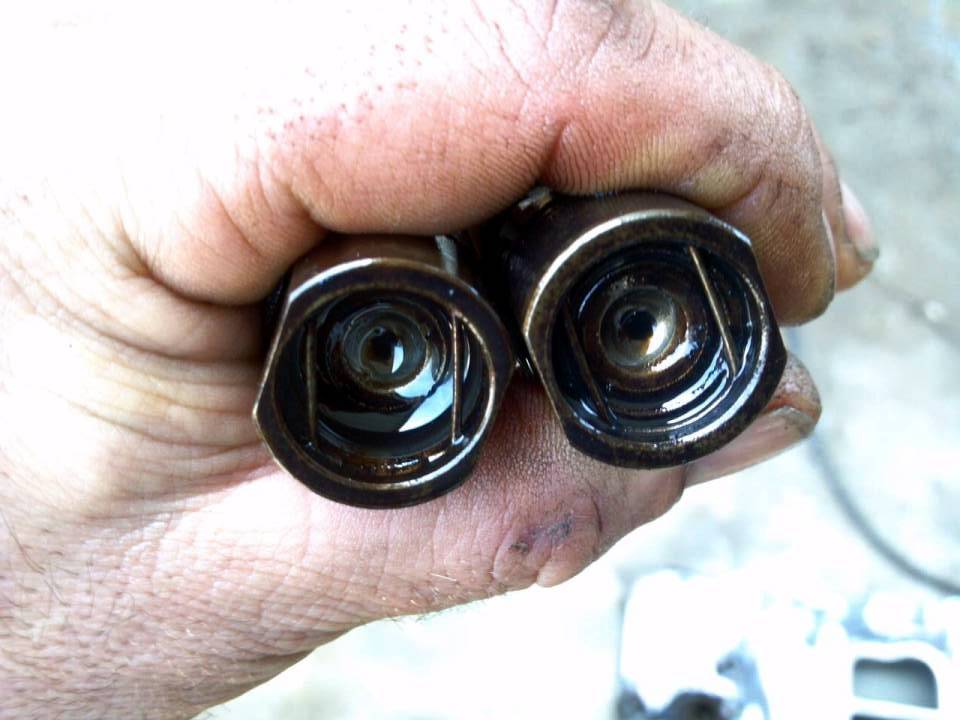

Also, the loose lifter originally in question...The little plunger sits way further down into the lifter vs the other lifter next to it...A picture below to explain...
ok....now i'm totally confused....there is no internal "spring" in these lifters(i checked both intake and exhaust lifter for a internal spring)....Is their supposed to be..?
I guess it would be safe to assume the cam is most likely still good, knowing the lifter is collapsed.

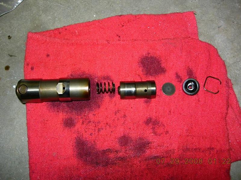

Yeah, there's a preload spring in there somewhere. lol If the plunger will not come up against the wire retainer, the lifter is bad. Your lifter should be similar to this:
