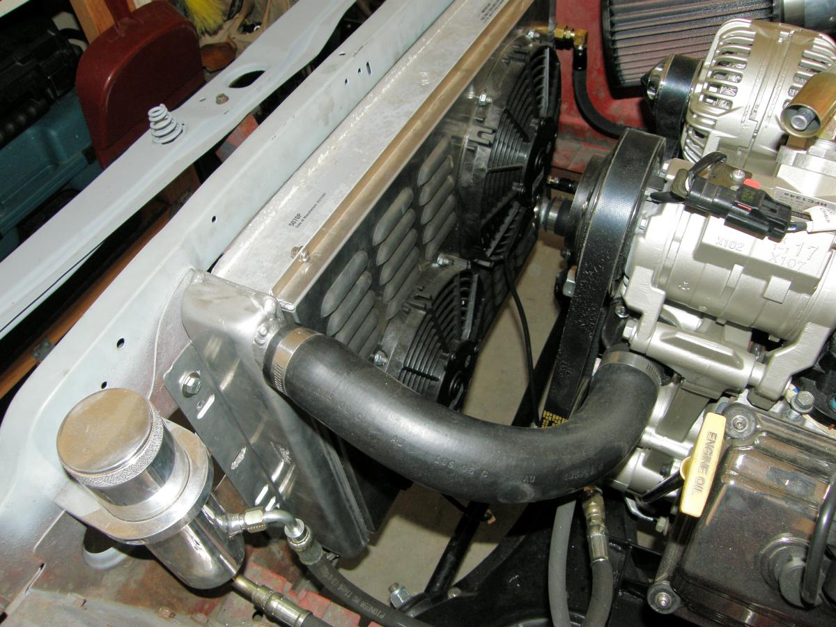

On Page two, you have a shot looking down at the radiator support and radiator. I have created a template for the lower support piece on my '65, and was going to have the support made from the template, using 1 1/2" x 1 1/2" x .120 steel. I appears from the shot you have made this support with a hand formed upper crossmember. Is that the case or is it something you created with a press. "Handformed" I meant, by cutting and welding to get the arch correct.
Thanks
Bob
Well I cheated big time on that. I got a piece of 14 gauge sheetmetal from work that was the overall length and width, then cut a few inches off one end so I could run wires through it, used c clamps to hold it, then traced the outline, cut accordingly, double checked everything, fired up the welder, then grinder, the bondo(to smooth it out a bit), then primer. Not that the factory support wasn't good, it's just that it had WAY to much flex, so I just boxed it in. It really is a simple job and adds loads of strength. Thanks for noticing, not many people catch that. I guess I should take it as a compliment that it looks factory.
5.7
Thanks for the reply. I made myself a homemade torsion bar removal tool this evening after getting off work, popped the bars loose, and will be dropping the front suspension in the next day or two. I wanted to get that front piece welded in before I roll the car on the rotis' and your information will help me reach that goal a little quicker. I appreciate the info...and believe me, I have looked at every detail on the photo's you've provided us. Great job....
Bob
Well you'll be happy to hear this, I'm working on getting the front frame rails tied together. That should stiffen it up like the little blue pills. It will be down low, inbetween the radiator and k frame, and I'm leaning towards a bolt on piece, but I gotta install the front bumper to see where and if it can fit.
Somewhere between the sway bar and radiator, it should work, cross your fingers.
