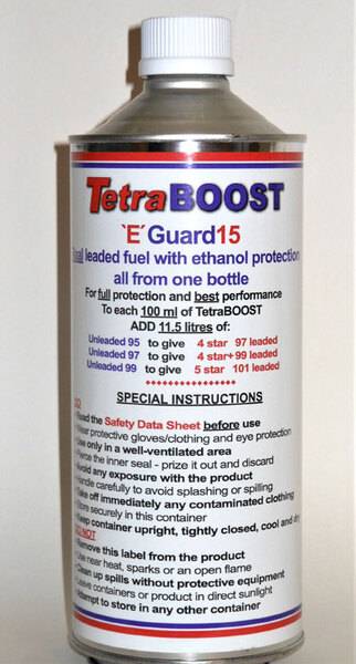

This is why i tend to use a real lead additive like this one:
But man, read those instructions on the can.
they scare me quite a bit.
Is it really that dangerous that you have to wear gloves and a mask and change "contaminated" clothes?
Or do they just have to print this on there because of laws and its not that dangerous?
I also dont know if its a good idea to wear a mask and gloves at the gas station. :p

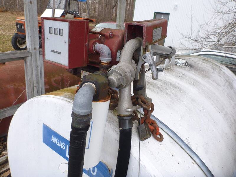

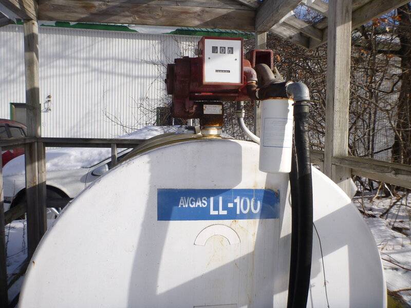

My engine should run fine on pump premium, but now that i have access to 100LL avgas, i sweeten the tank with a couple gallons of avgas per 8gal tankful. (fuel cell). Just a hedge against the watered down cat piss california calls premium gasoline. I will hav e to stop the avgas use temporarily if i get a uego hooked up, for tuning purposes.
I run about 25%.. 5 gallons AV100LL to 15 Gallons of 92 Premium UL. Jerry runs 50/50

I just basically have to decide if i will try it with the lead substitute or go for a real lead additive as posted above.
Im just scared about possible health issues when using a real lead additive.

So you would advice against carrying this in the trunk (maybe even next to food or drinks) and putting it in at the gas station without wearing protective clothes?
It won't kill in 5 seconds. However you obviously do need to be careful around it.
I would not get it on your hands or anywhere near food.
The problem with lead is it builds up in us. Exposure leads to lead poisoning as time goes on.
The AV110 is aviation fuel (airplane)that I understand is still leaded.

Michael.. does your engine have hardened valve seats from a recent rebuild?? If so you don't need lead. If it's an older original engine you do. 100LL has about 10x the lead in it that good old leaded premium use to have in it and why a mix not only gives you the lead needed but boosts the octane of the crap 90 to 92 octane we have today. If the stuff was gonna kill you I'd have been dead many moons ago, I use 100LL to clean parts as it has toulene in it.
If you think you need it, wear some gloves, and when it's done wash your hands. I'm 73 and haven't died of it yet. Just take some precautions and you will be fine.
Well i think that the Engine in Question does NOT have hardened valves. Im not 100% sure but if it has not been rebuilt or upgraded (which is what i think) it definitely needs leaded gas.
I will look if i can find further information but if i cant find any proofs for hardened valves i think i will buy the lead additive and some good gloves. :)
