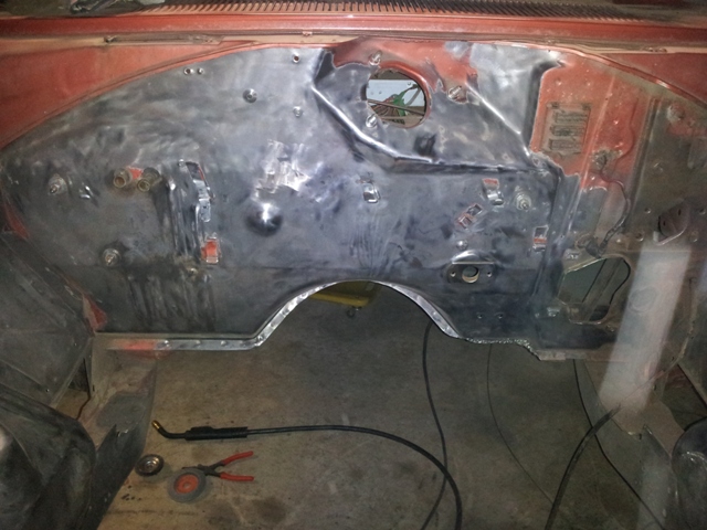

First I continued with the removal of paint from the firewall . . .

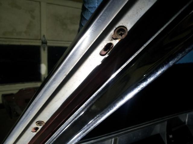

So, on a convertible, apparently things are a little different . . . open the door as follows:
grab and pull out the weather stripping as shown:

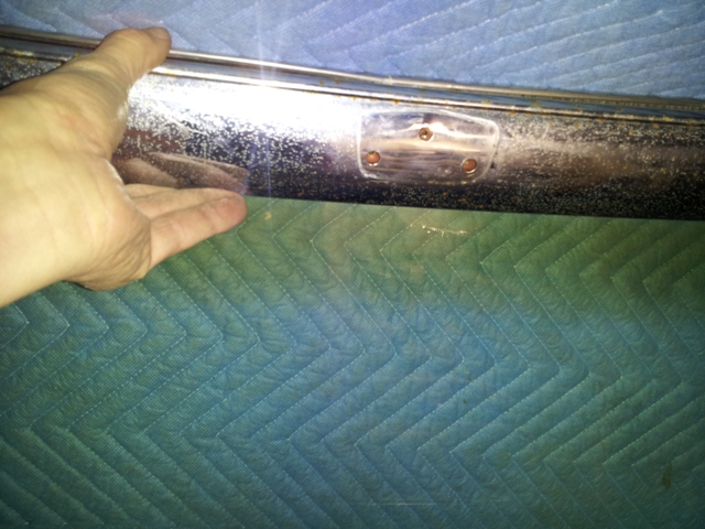

Underneath you'll find a set of screws that hold in the first piece of trim:
Note: the one on the bottom is a bracket that holds the bottom window trim in place.
The screws on the top are removed to get the first trim piece out of the way.
Pull this piece of trim out of the way.

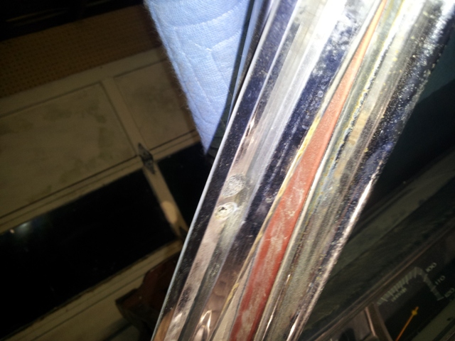

And you'll find yet another set of screws - these hold the side trim in place.

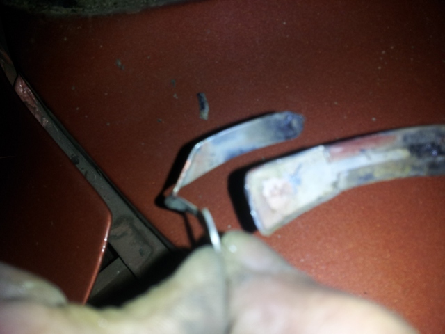

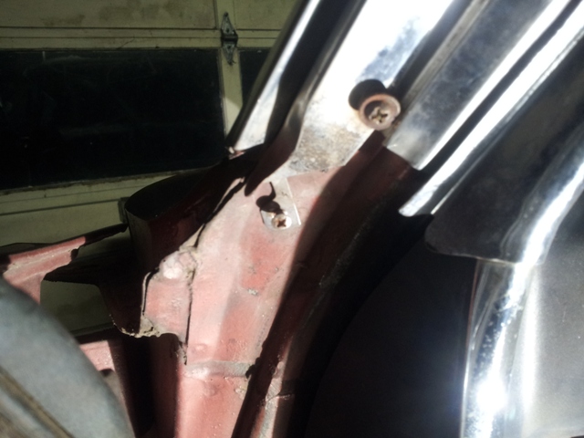

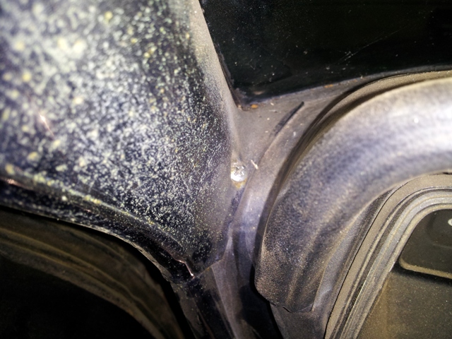

Removing them will help in removing the trim - however, the trim is held in place by some "interesting" stuff that looks like tar and acts like double sided tape. This holds the trim piece in place. Also the side trim is tucked up into the top piece of trim. To remove you must get the sticky stuff loose and pull the trim up and down so that it'll come out of the connection from the top trim piece.

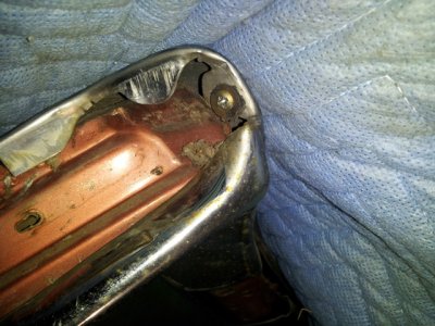

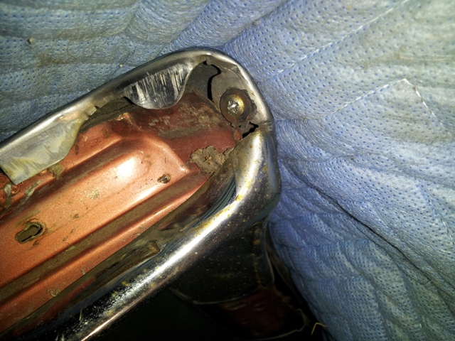

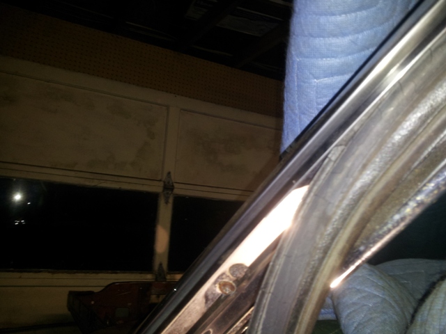

Here's a pic of that "interesting" stuff on the body and trim piece:
Here's a picture of the bracket that holds the bottom piece of trim in place.

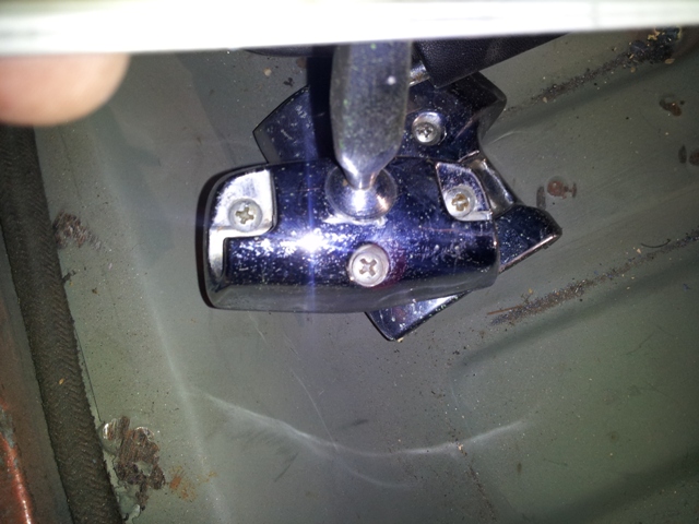

First you need to remove the sun visors, and rear view mirror - very simple, but here's the pictures:
Visor - very simple - 3 screws and they pull out.
Rearview mirror = 3 screws and it pulls out:

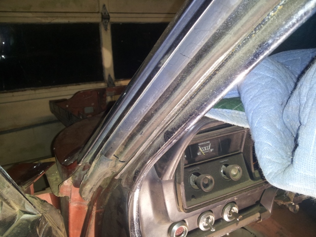

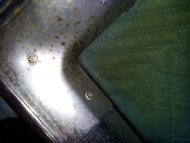

This screw is tucked in the top of the door jamb and actually holds the top outside trim piece in place.

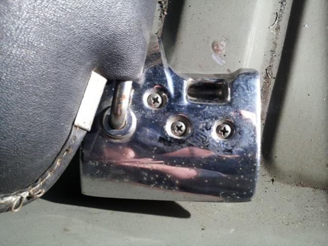

These two screws hold the corner piece in place for the inside molding.
And one more screw down here at the dash area.
And last there are some screws that are between the visors and rearview mirror.
The I grabbed the trim, pulled the front of it ( near the window ) down and then pulled back and it came out

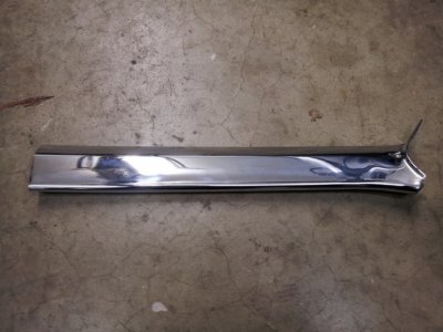

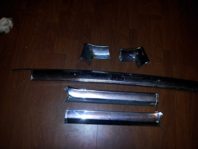

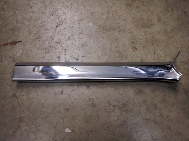

The corner pieces came out with the side trim very easily.
The other pics showed the shape of the pieces - but here they all are together.

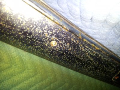

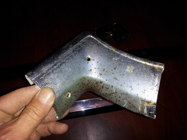

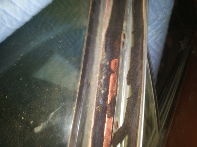

And this is probably the worst piece - as far as condition ( today ) . . . we'll work on that.
There's 5 screws on the top trim piece, got them out, but that tar/stick stuff is holding it down so I left it place till I can figure out what to do with it.

Thanks 747Mopar - I've been buffing them by hand for the last little bit - some of it cleans up, but the deep pitting will be "interesting".
Let me know how your buffing goes - I'll be interested to find out. May need to break out the buffing wheel myself.

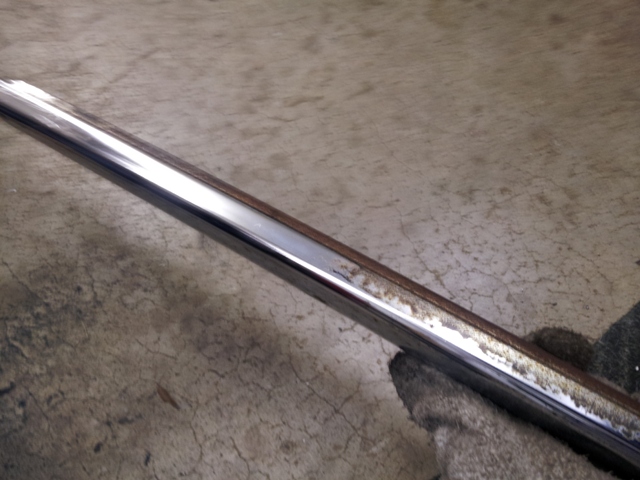

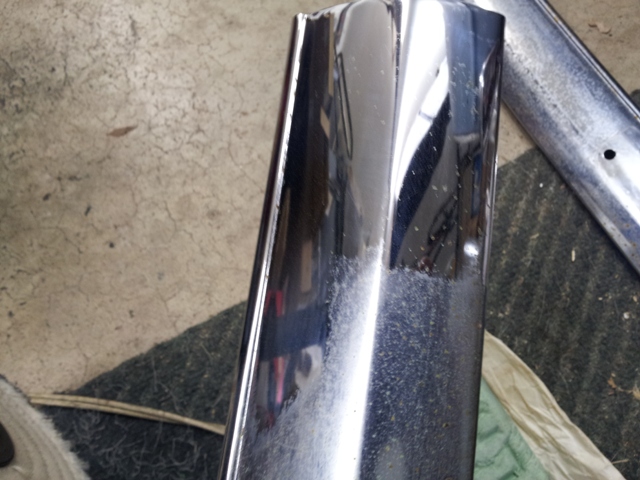

Tried my hand at some chrome buffing . . .
With the rain falling outside, and the temperatures falling I decided to take a little time in the garage and buff on some of the newly removed chrome pieces from the car to see how'd they turn out. Some of them are pretty rough, and I'm going to have to do some more research on this buffing stuff . . . but I took a stab at it.

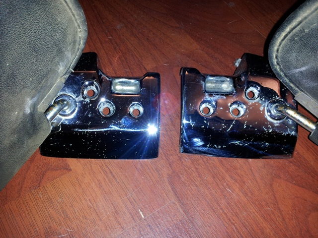

Here's a couple of the pieces that I worked on to let you see the difference - this is pretty obvious on the change:
As is the edge on this piece of trim:

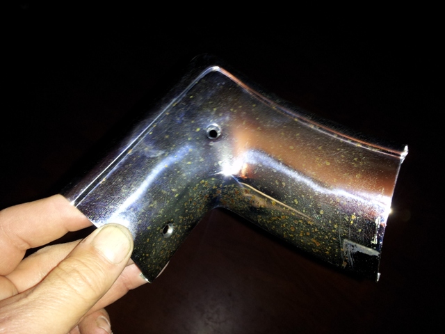

This piece turned out rather well - but the pitting is pretty deep - may need to decide what to do:
Here's a side by side of the worst piece so far . . . more research to find out what types of things I can do to help the process:
sm_polish4.jpgView attachment 151290
Yes it's better . . . but, it's got a long way to go . . .

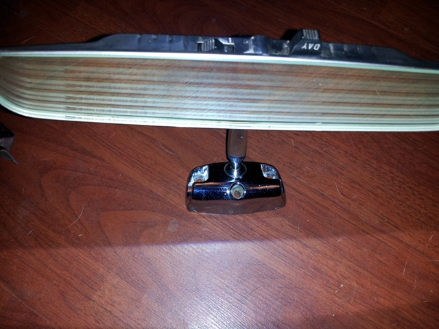

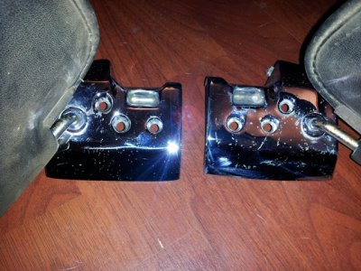

Grabbed the rear view mirror and the sun visors to see how'd they'd polish up.
Not too bad - I think I can live with these:
Even the bases of the sun visors look pretty good - I think these will work:
