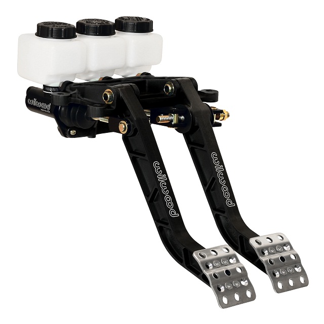

remember you said mine is gonna look more like a race car. that gave me an idea for mine so this is what im thinking for mine.

Those look pretty sweet, what's the third reservoir for (just extra capacity)?????????

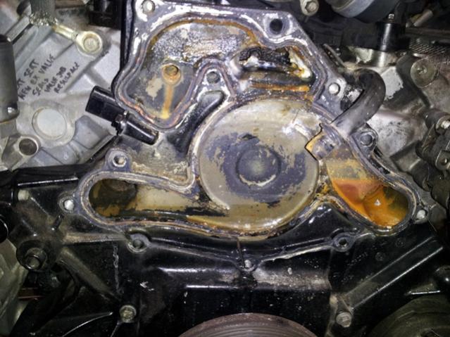

Got into the Hemi tonight - got the new water pump, so it's time to swap it out . . . and I'm not too sure I like what I see . . .
Here's what the block looks like after the pump was removed . . .

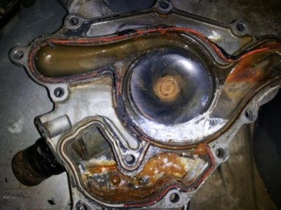

And what the inside of the water pump looked like . . .
Can you say "YUCK" . . .

The second reservoir is probably the way that they did the dual brakes - with 2 single reservoirs - that's my guess . . . One drives the fronts, the other the backs ? ?

USARR - WOW. . . now that is really cool ! ! I've seen those - and I really like the looks of them . . .

I'm looking at the pics on my phone so it's kinda hard to see, is that the milky color of mixed oil and coolant in the water pump? Hope not!
And USArr that bottom wilwood pedal assembly with the speed hole pedals is awesome! Any link to it??

they are on wilwoods website under pedals. they have alot of nice stuff...

Hey Speedy - I don't think it's oil mixed in - there was still some water that drained out when I removed the water pump and I did not see any indications of oil in the water. Glad that I'm swapping the pump as the old one had all kinds of silicone on it and I'll bet money that the pulley seal will be leaking like a sieve ! ! !
Gonna take a little time and clean up the casting edges on the new pump to assure good water flow . . . might as well why the pump is still accessible ! !

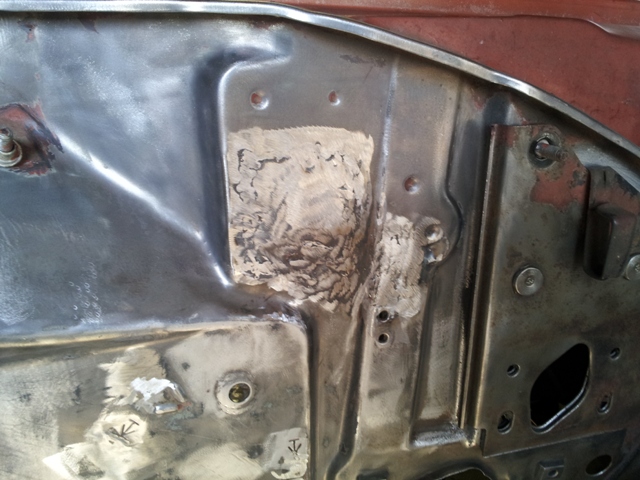

Well, got that done, and was able to make my way back out to the garage and burn some holes in my clothes while welding up some things . . .
Here's what I was able to get done . . .
I got a bunch of other little things done - mostly welding and finishing up some stuff that needed to get done.
