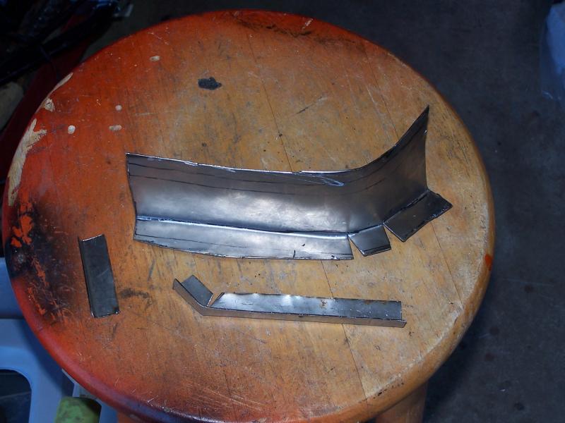

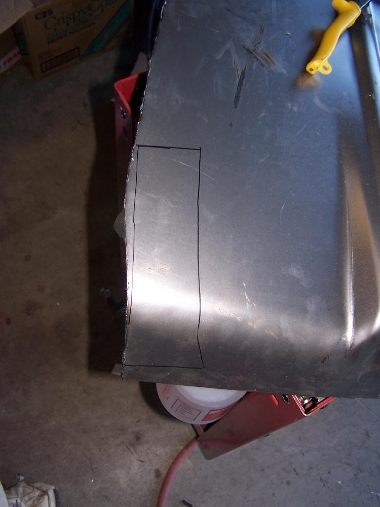

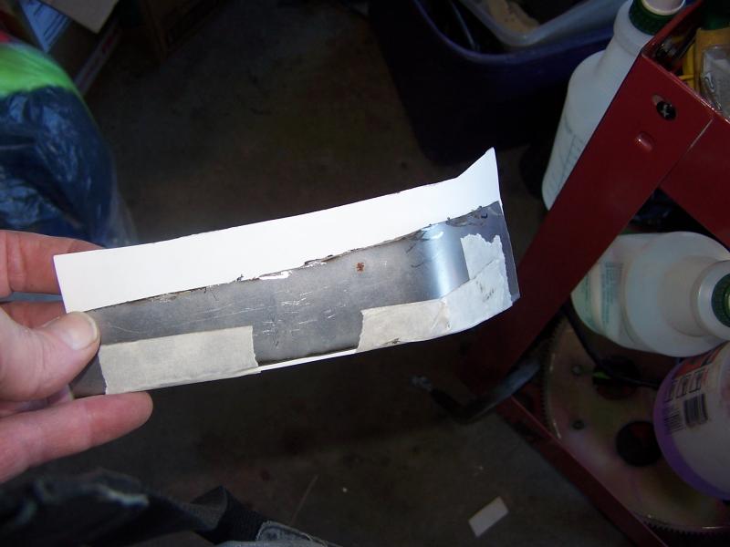

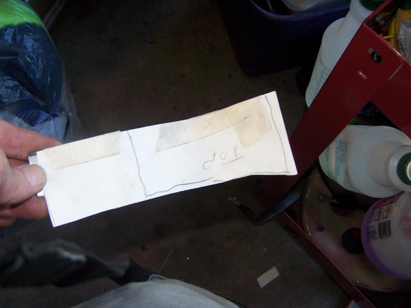

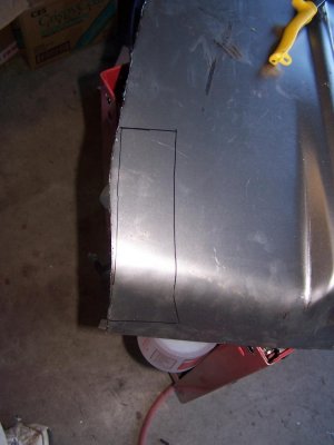

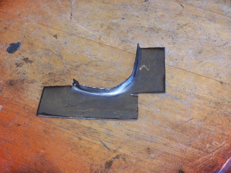

Advanced template action... Need to follow the curve of the floor

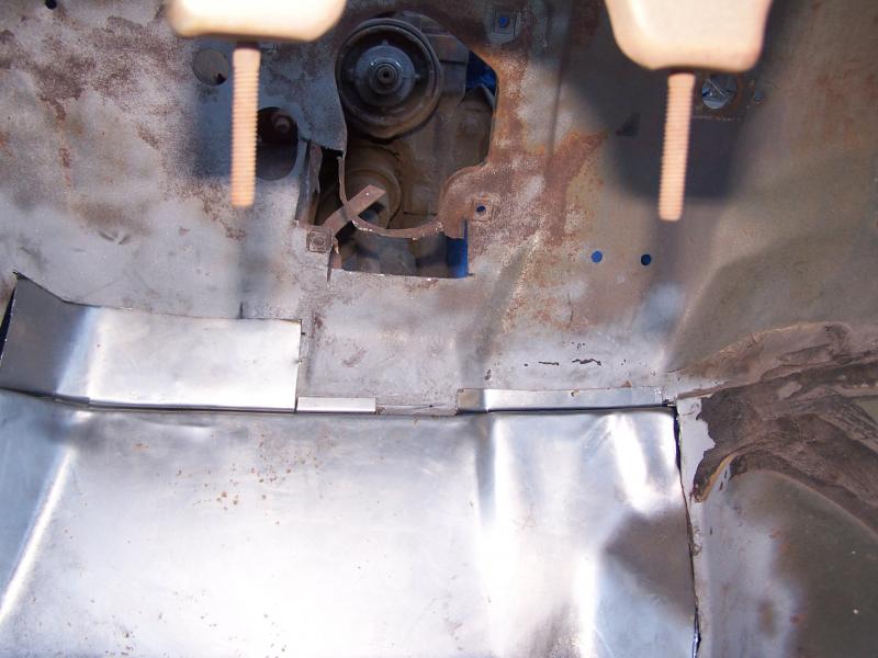

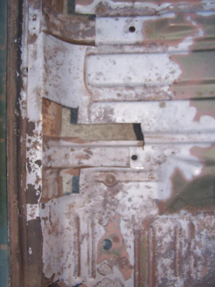

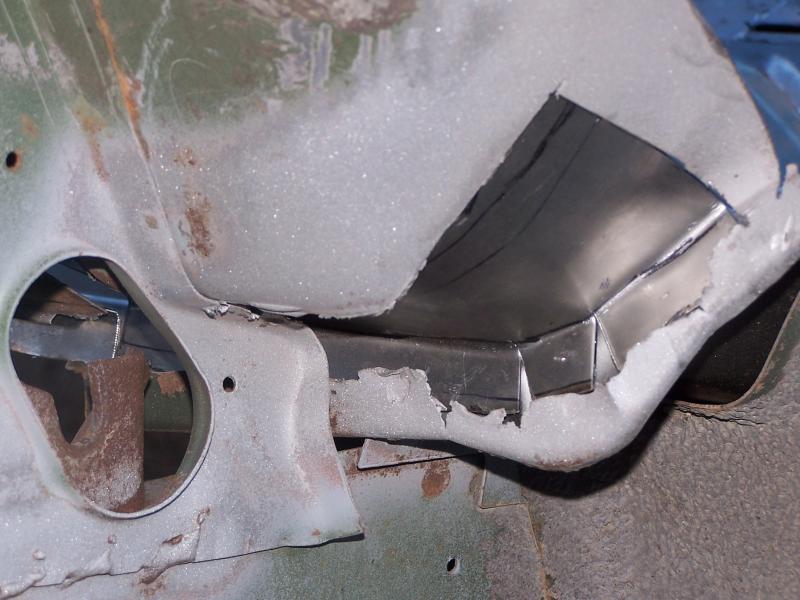

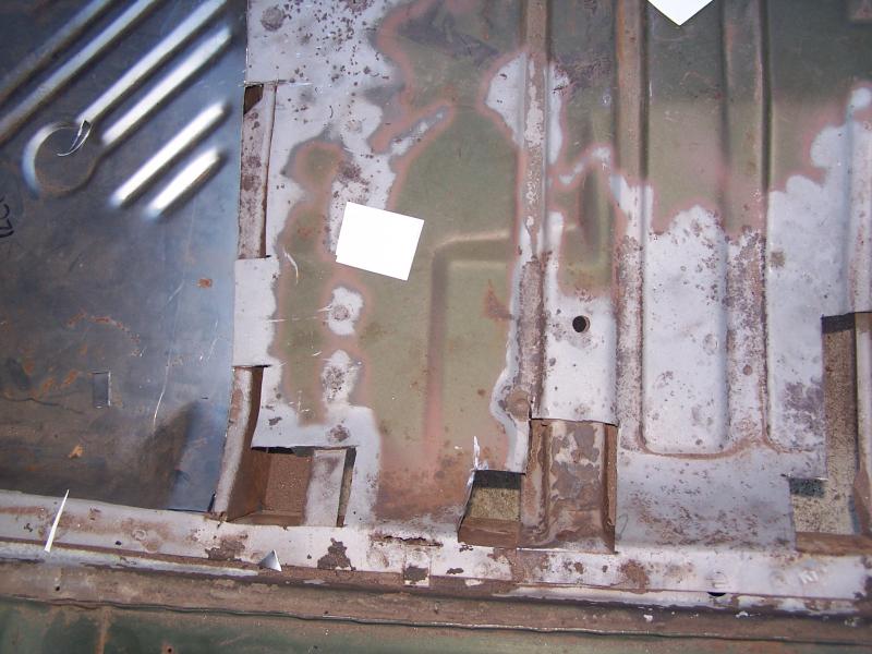

I now have the lip for the floor to butt up against. I'll cut out the rest of the bad metal before welding
more patch work to come

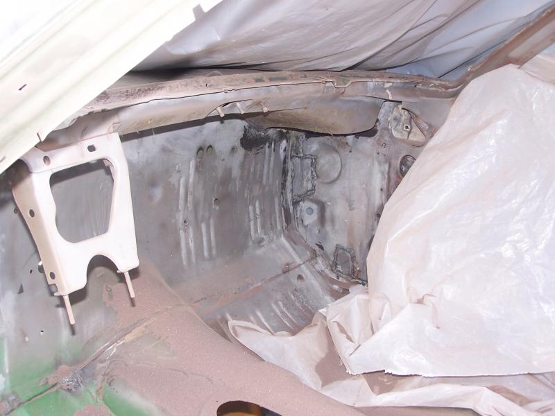

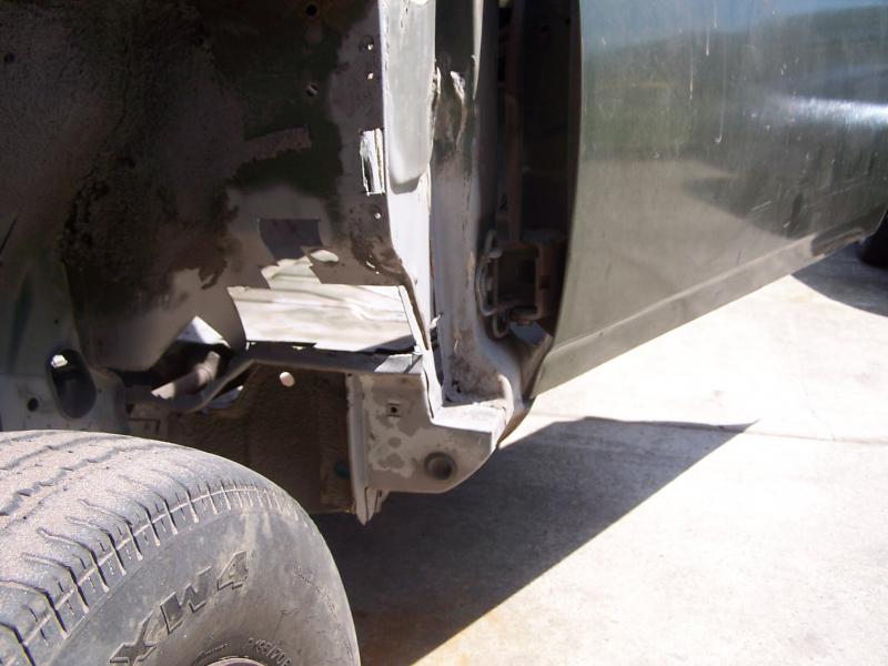

Been welding and grinding and re-welding and more grinding and welding... it would have been a whole lot easier to replace the entire floor section but..... most of it was good and I cant see wasting good Detroit steel for the sake of convenience. None of the welds will ever be seen. Car has undercoating and that will cover all the welds and the sounds deadening on the interior will handle that part..... BUT it would have been incredibly easier than cutting patches and me learning how to metal work and shape and no matter how many times I cut it.... it was still to damn short.... LOL
But I am making progress :) I'll post some pics although some of it isn't pretty its effective and again.. ain't gonna be seen

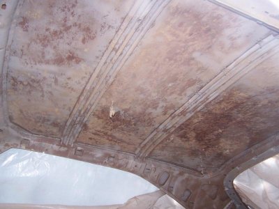

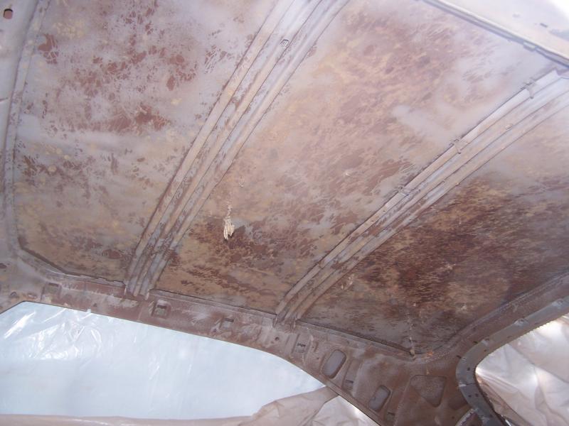

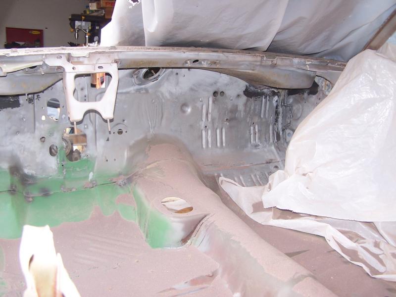

Been working on it.... sand blasting and using picklex20 on it... Will blast the roof one more time then pickle it and then its time for primer and paint on the interior :)

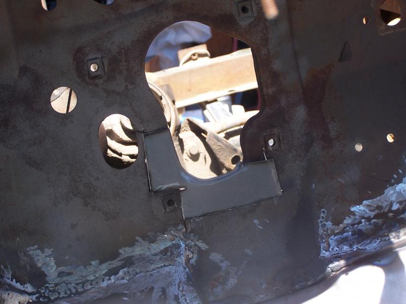

That's some real great looking patch work. Like how you did the steering column hole.
Nice progress you have been making. What is this pickle stuff? I've never heard of it.
