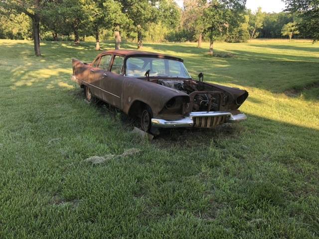

My first 58 Belvidere
Someone save the bee!500$ would get it I bet if he got the Plymouth for that... I have no room but some needs to save it.. or offer 3000 and take everything to keep them from the crusher. Old tow trucks that feature a Holmes wrecker bed are highly highly collectible!
Nice ! Save them all!

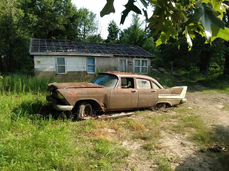

First wash.....gonna get the shop vac and broom out here in a bit and start cleaning under the hood and interior
Nice project! I’ve got a ‘57 Savoy lawn ornament wayyy too far gone. Destined to be a couch or wall art in the shop.

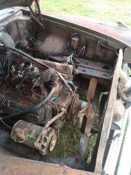

I lied. It just had 2 breathers sitting there.

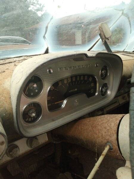

Question, will the lights come on without the key in or on?
That’s a Poly. Go through the carb. Change the fluids and it should light up. But first make sure it turns over by hand. If not put penetrating oil in the cylinders - there are threads all over FBBO as to the best penetrating oil to use and how to get it to turn. Polys seem to run forever.
