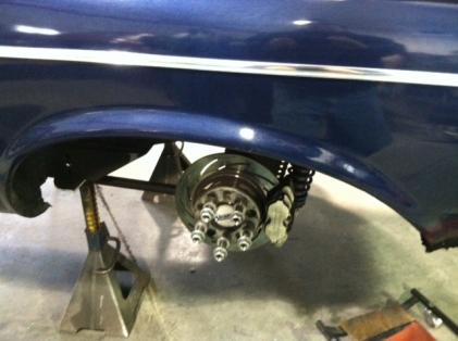

Just curious but why bead locks? Ease of tire change, or were you spinning the old ones. They always kinda confuse me. Some guys run wicked quick without em, then I see 10sec cars with em. I know traditionally used with the 10.5" stuff but usually on 14-16" wheels. Just curious, and I fricken love em.

Originally I was looking to get them for my black dodge but then these popped up for sale, New never used and I didn't have to wait 6 weeks so I bought them to try. What I have heard it hits the tire harder. I rarely spin but figured, let's try them and see if they improve my 60 foot. I might even put them on my 65 blue dodge. Thanks for the kind words.
