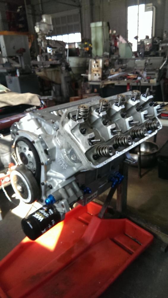

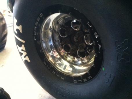

Bead locks are mounted with new 31 x10.5W M/T slicks. Engine is just about done. Just waiting on 2 Titanium intake valves and 2 exhaust valves. 1 hemi head is on lifters are in and valley cover is on. Valve job is finished.
Headers are all nicely recoated from Airborne coatings out of Hartford, Ct. Only place I will ever use.
One head is done.

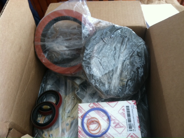

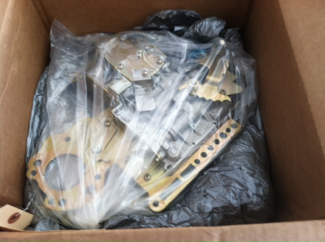

The parts keep arriving. A & A Transmissions custom free neutral valvebody, no Transbrake and clutch pack and a few misc. items for 2 transmissions.
Customer service is 2nd to none. ProTrans, not so much

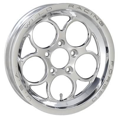

My Weld Magnum Front Runners are on their way. Should be here by Wednesday. Thinking of new Moroso Drag Special front runners to compliment the new wheels.
