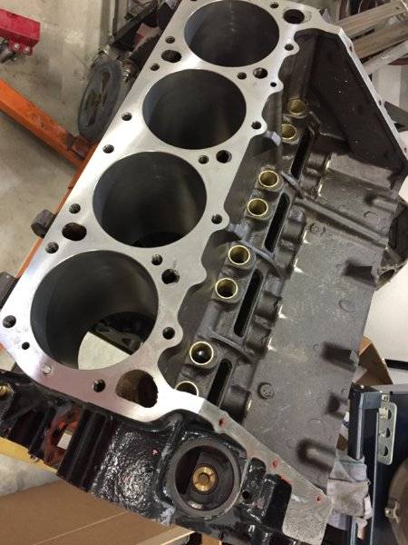

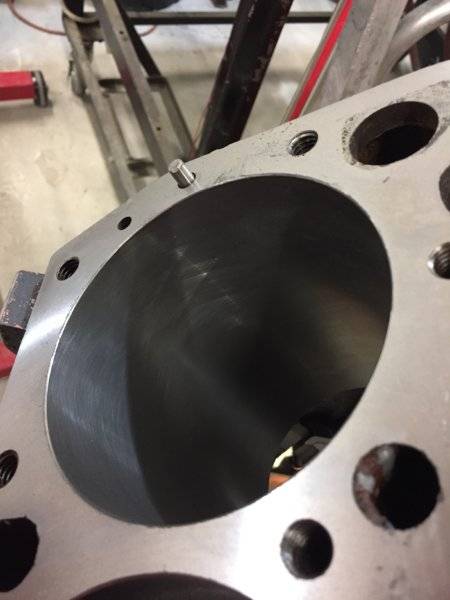

Hey Schober Motorsports - I'd like to ask you a few questions about the block pictured in your original post. I tried to message you but your in-box is full. Are you willing?

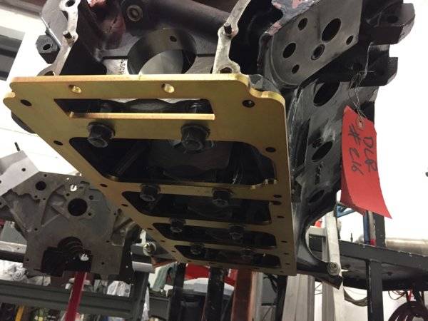

I am thinking of getting the 440 source girdle kit (using stock main caps) as it comes with the ARP main and oil pan studs and the 1/4" girdle will work great as a spacer to move the one piece Jegs windage tray/oil pan gasket (4.15" stroke version) away from the crank rods.
I appreciate your reasons for considering the 440 source girdle kit, "added strength and the bonus of moving the oil pan down a bit" but IMO the girdle should be chosen for its ability to add strength and longevity to a stock block that would be pushing the limits of a stock block or for added insurance.
This cap and girdle set has a unique design and I personally buy into the designer's explanation of what makes this one uniquely better.
http://www.bcrproducts.com/caps_and_girdle_system.html
As in my earlier post, I have the BCR kit on my low deck stroker, but on this 440 engine which is only making around 600 HP, I don't feel the need for the added expense and machine work of putting new caps in the block? What I haven't decided on is the oil pickup. I have always ran 1/2" internal pickup with enlarged oil passages in the block, but I might use a single external type pickup? I have the oil pump cover with the remote filter fittings and external pickup. The external pickup can be removed and plugged if I want to use the internal pickup.
I am using the BRC girdle on my current build - I agree it is a superior design.
