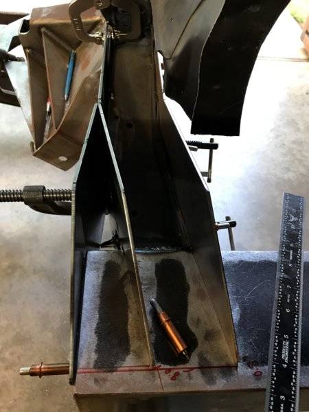

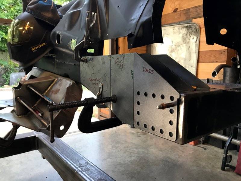

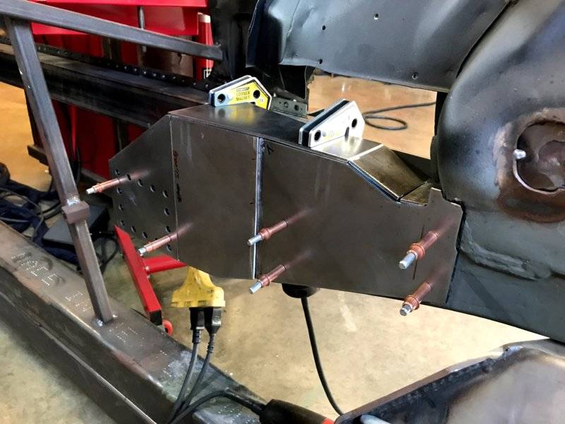

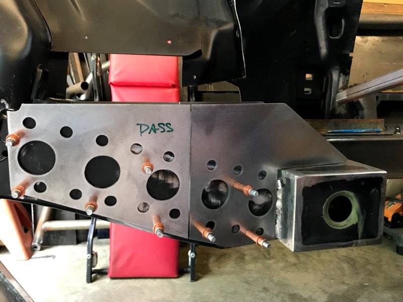

Passenger interior plate is fit and cleco’d.

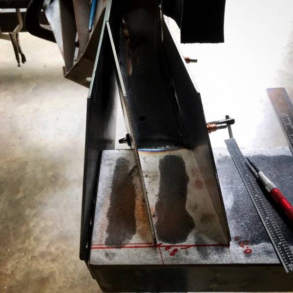

Rails are just a tad bit over 7” tall at the crease.

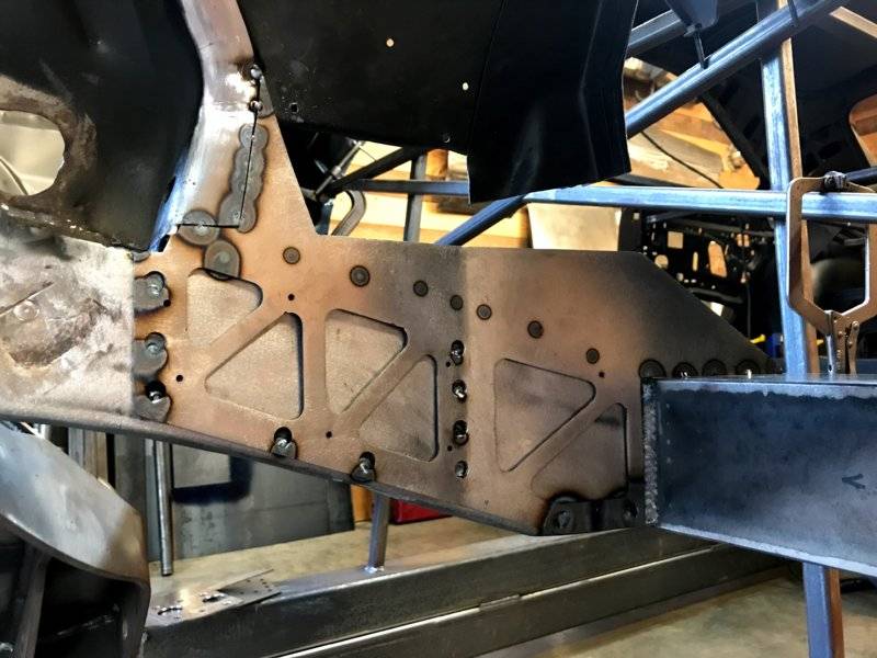

Third and final front rail plate getting mocked up.
It’s not overkill if you plan to drive it hard.
David

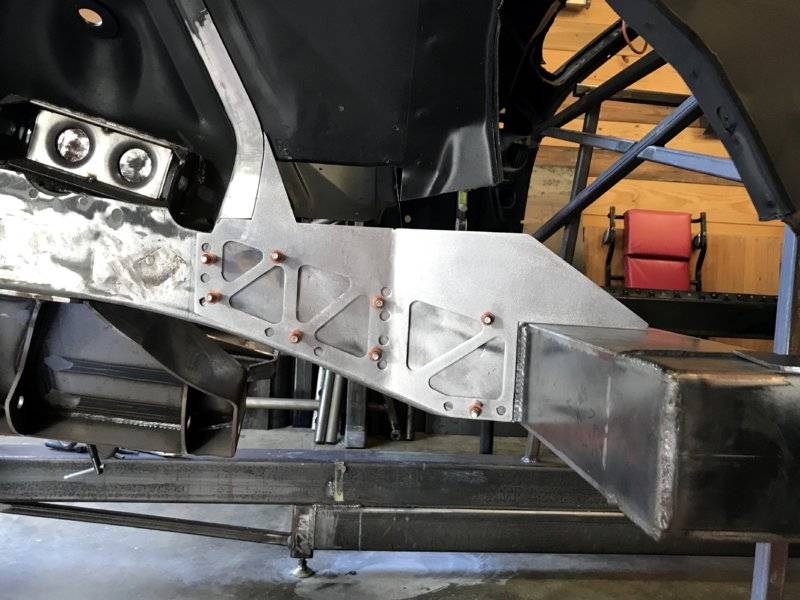

Made some adjustments to the inner and interior plates to simplify the overall design and eliminate a 9” section where two 1/8” plates were stacked. This adds about 1.5 lbs of lightness.
Now it’s just the right amount of overkill.

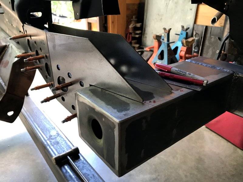

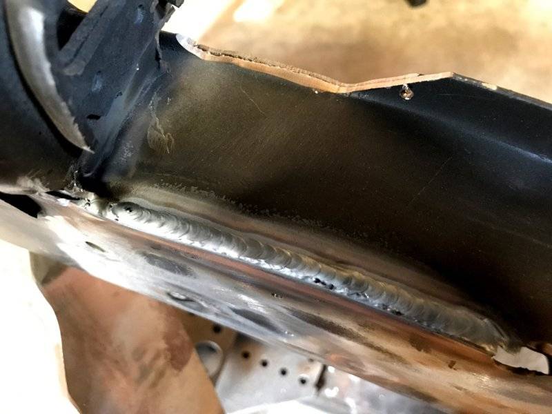

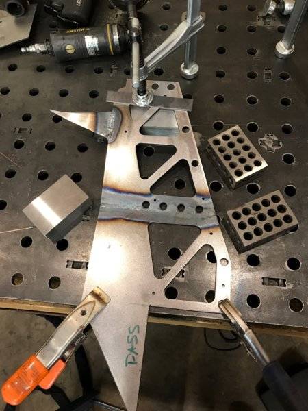

Tonight’s process:
Fine fitting the top plates, which consumes a crapload of time to get the open corner welds set just right.

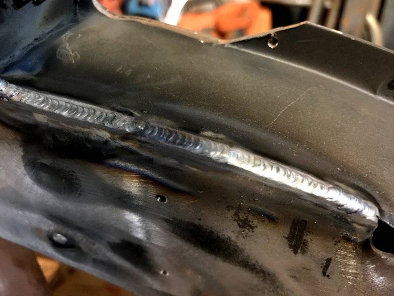

On the plus side, I did lay down some TIG welds on the passenger rail, and I’m very pleased when them. I’m really digging on the control and precision I can get with the Furick FUPA.
First pass with .045 wire.
Cover pass with 1/16
More to come. It’s only 105 tomorrow.

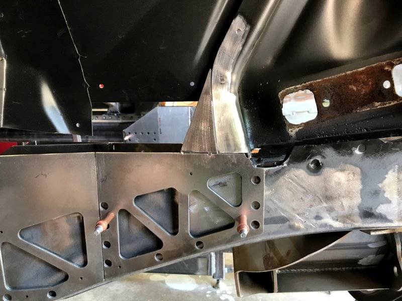

Added a shock tower gusset.

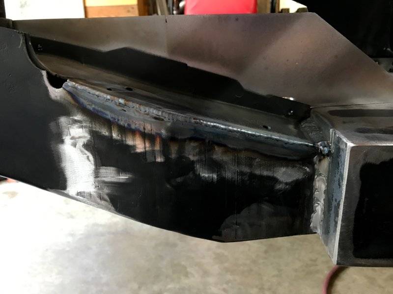

All the scored bend lines and tacked panels are now fully welded and blended.
Before
After

Thanks man. TIG welding is so sensitive to fitup, I really had to up my game before getting comfortable welding thinner stuff. While I haven't invested in a dual flow regulator just yet, I did borrow one to do some cutouts on a friend's CTS-V. Flooding the cavity with argon added quite a bit of puddle control. Also, I still struggle with torch angle discipline when I'm out of position, especially when I'm using the #26. Much easier with the #9. Keep at it, and practice on every piece of scrap you can get a hold of.

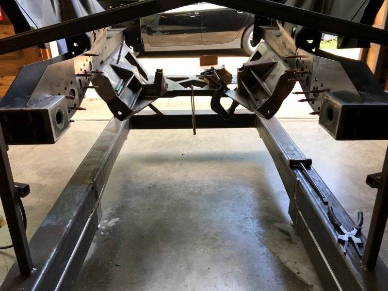

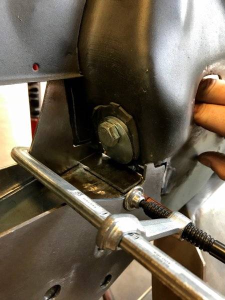

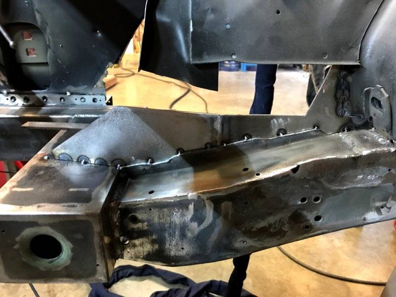

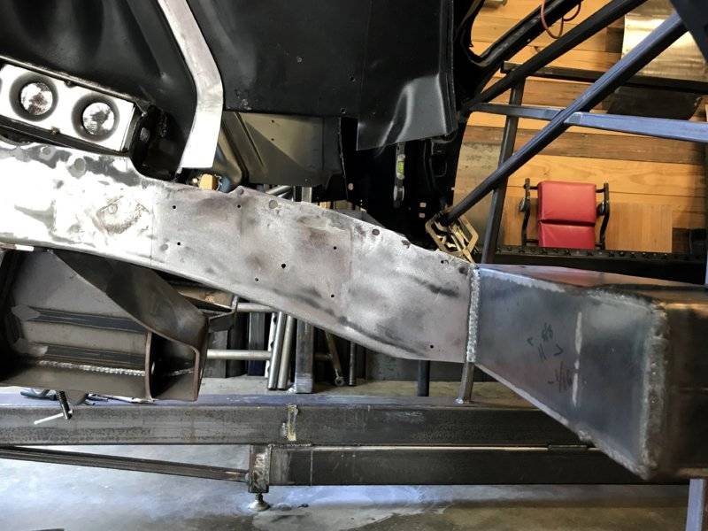

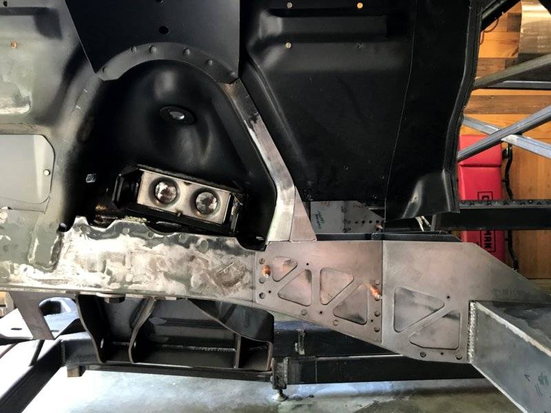

I spent a lot of time Sunday fitting up plates, prepping rails, welding closed the remaining flanges, and testing to make sure there wouldn't be any interference between the UCA hardware and the newly expanded rail section.
I'm just taking my time, fitting up, and prepping for a big weld day.
David
Milestone. One plate tacked. So much prep and fine fitting prior to this.
