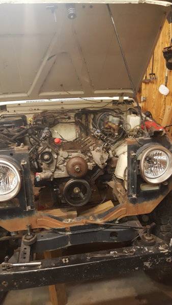

Being the unbiased car guy that i am, and the amount of projects that i have done, i can definately see the benifits of going LS-series with this build. For whatever reason (to me) Mopar engine builds seem to be a touch more expensive than the other makes. I have done a few LS swaps myself and totally understand where the desire, and ease of parts plays into this.
My other project power plant may look familiar.

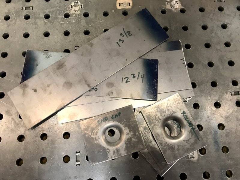

I drew up my plan for the front torque boxes, and since they don't make 5x4 rectangle tubing in 11ga, I'll end up fabricating my own. The local metal shop can shear the component plates pretty quickly, and that's time efficient since work is nuts this week. I should have it all in stock by Friday.

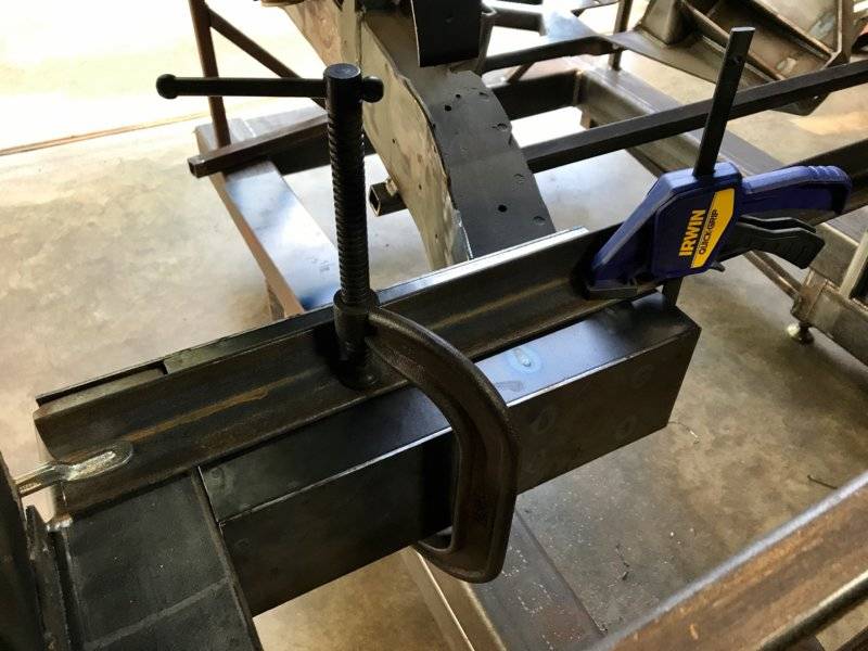

Front torque boxes underway.
Lots of fitting and integrating still to go. The heat index was 107F in Dallas today, so progress was a bit slow.

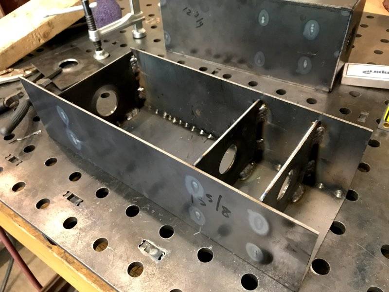

Number two torque box built, both rails trimmed. Here’s how they go together.
David

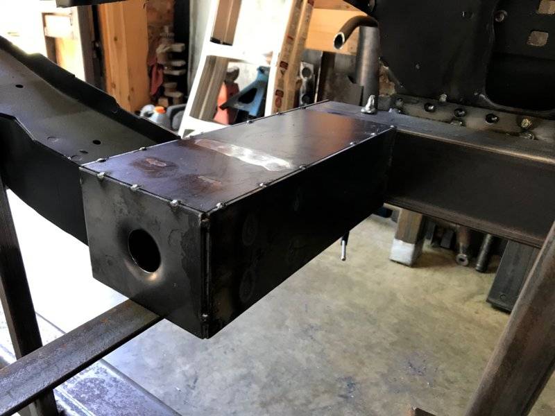

Torque boxes welded and blended.
Next up: square the rails and rockers; tack these in.

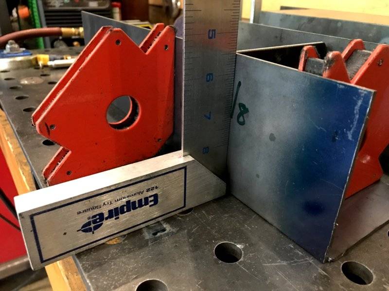

I spent the evening finely trimming the front rails so the torque boxes are square from the rocker to the rail and leave no gaps.
I’ve got some figuring to do on the plates and overlays that will tie the 1970 14ga frame rails to the new 11ga torque boxes. It will probably be 3 vertical plates - one on each side of the existing rail, and a third on the inside that will make a direct tie from the shock tower to the torque box. Got to put it on paper, and then bend tech.
