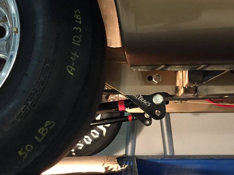

How do you have the caltracs adjusted? Preload or none? Instead of lowering the car, crank up the torsion bars and raise the front, this will put more weight on the rear. Then readjust the caltracs. I run zero preload on the bars, the pin just touches the spring on my car. just some suggestions that don't cost any $$$$
Great suggestion on the front ride height NSS, will do that because it is front low, and it makes sense to re-adjust the caltrac preload, as the rear of the car should drop some amount.
I normally run zero preload on my caltracs with me in the seat. The last time out though I did run some pre-load.
The cal tracs went to the upper hole today. It took some clearancing on the spring box so the bolt/nut/ washer wouldn't make contact. A harder hit but less downward force on the cross pin across the leaf. The hole spacing is 2.5" and 4" from the spring eye, so approx 40% less leverage. The rear shocks went another 1.5 notches to full tight now and the front rebound went up 4 notches too. A number of changes, all of which should firm up the rear and keep the weight rearward longer.

I have Cal Trac Bars, Mono Leaf Springs, Cal Trac (Rancho) Rear 9 way single adjustable shocks set on 1 for Trans Brake, One flat preload on passenger side and drivers side just touching (with me in the car). Bars in bottom hole, not top hole. Front is Cal Trac 90/10 front shocks, Torsions Bars are loosened up to "sag" and allow 5" on front wheel free travel....and NO PROBLEMS.

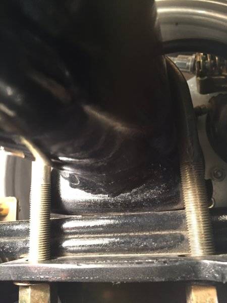

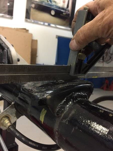

Today I decided to do a check under the car today, checked this and that, checked the leaf spring u bolt torque to find them somewhat loose on the right side. On closer inspection I noticed that the right side spring perch had an air gap under the front. Looking closer I realized that the perch was crushed towards the rear!
There is an 1/8" gap under the front of the spring perch..
The perch is crushed towards the rear and looking from behind it shows that it's bending over..
The perches didn't have any blocking on the fronts or rears, and that obviously allowed the crush. Looking at the pinion angle it appears to now be positive. Using my iPhone protractor on the back Moser cover it also shows 2 to 3 degrees up angle (positive).
The diff will be coming out tomorrow, perches cut off. Will pick up a new set on Monday morning and get it back together. What the hell though, all the bouncing and **** took it's toll on the perches.

Ours did the same thing. Call Cal Tracs they should send you new brackets.
Thanks ES. At least I'm not the only one who has had this happen. Running short on time so I'll have to just grab a set from the local speedshop. In hindsight I sure wish I would have boxed these perches, it would have been so easy to do right on the car even. The new ones sure will be..
Malex, good find well another note for me. Will box in the perches just to be safe. I'm assuming with the boxed perches that crushing affect will stop.
Just a comment Malex. I boxed the perches on my GTX many years ago, at the urging from my Dad. Surely you will get some positive results now. :thumbsup:
Bob :moparsmiley:
I run 4 down with my caltracs. Calvert makes a nice boxed perch. They should warn you that you need them when you buy the bars. I had the same thing happen on the dart, I folded both over.
Yes boxing, strapping them will do the trick. I have the perches in my Camaro boxed, but not the Plymouth of all things. Lesson learned.

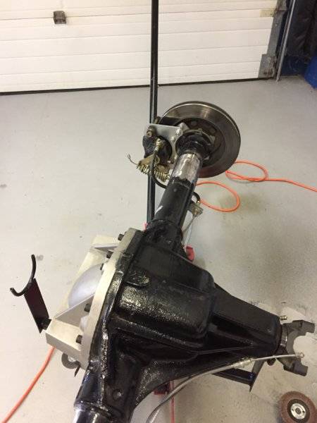

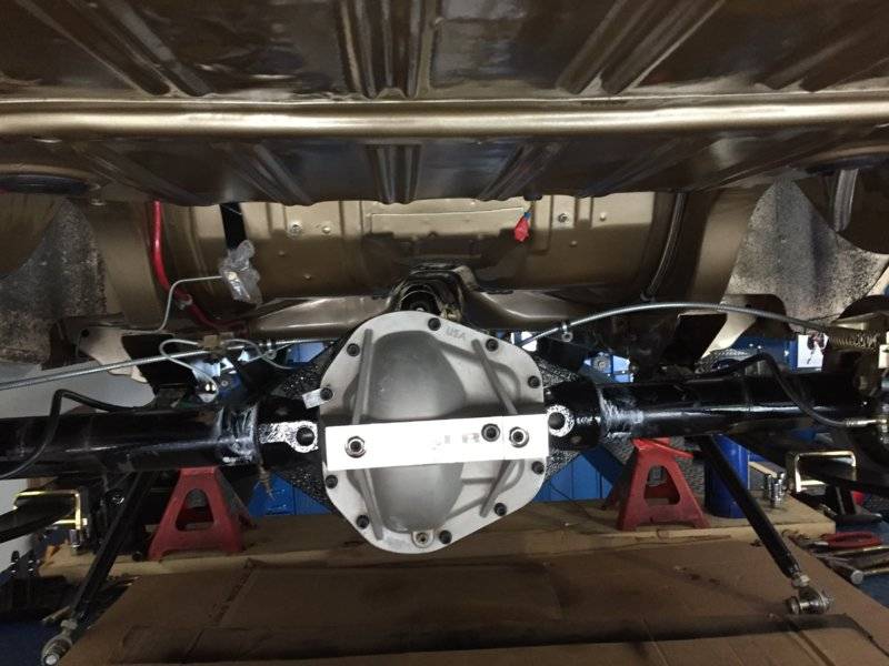

So the dana came out today, bent perches cut off and dana is back in place. Will pick up the new perches in the morning and get back at it.

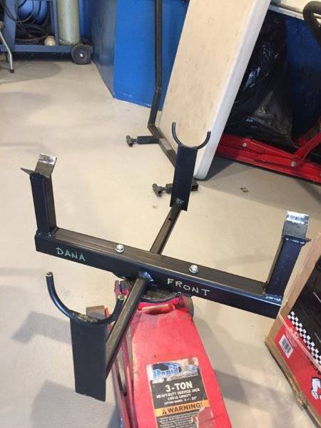

The first thing I did was build a bracket to hold the dana. Actually works great. Can spin it 180 degrees and work on the perches. Sure makes it easier when doing this stuff solo.

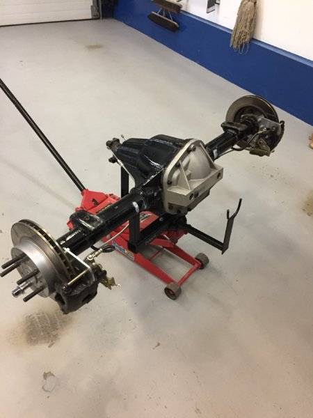

Dana out and flipped over, ready to cut the perches off.
Damn perches sure flattened out on the back. Both sides bent, the right side was worse.
Perches gone, ready for new.
Back in place, will slip the new perches under and get it bolted up, on the wheels, set the pinion angle, tack in place, then pull it back out and weld/box them good, but thats tomorrow's job.
