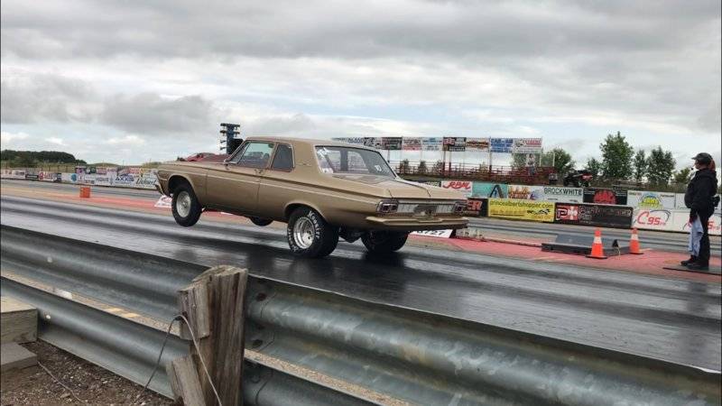

Thanks Bob. Yes it's working pretty good. Rear shock rebound on full tight, front shock rebound on 7R and 3000 RPM launch. I tried moving the launch rpm up to 3400 and the spin and bounce came back. I car is consistent now so I'll run it this way and start working on me. I went out in the second round today, barely got into the second stage and the lights were coming down right away. I had a terrible light. I took lots of time turning on the second light, I don't know if that is why they came down right away or not.

You can't tell there's any difference at all, other than the rear of the car sits down about a half inch. On my car it also increased overall travel by over an inch. Unhook the rear shocks and give the car a bounce, smooth as silk free movement.

Malex have a question, wheel stands how much is too much? Just curious.
If I could, I’d like at least this much and a little more , run 10.0’s and not have the front wheels doing the bird dance when it settles down.
