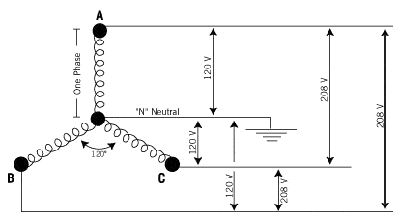

How would you get 220 or 240 out of Y system?

That is a standard Y configuration that would net you 208v from phase to phase
The sum of 2 windings
and 120v phase to N.
