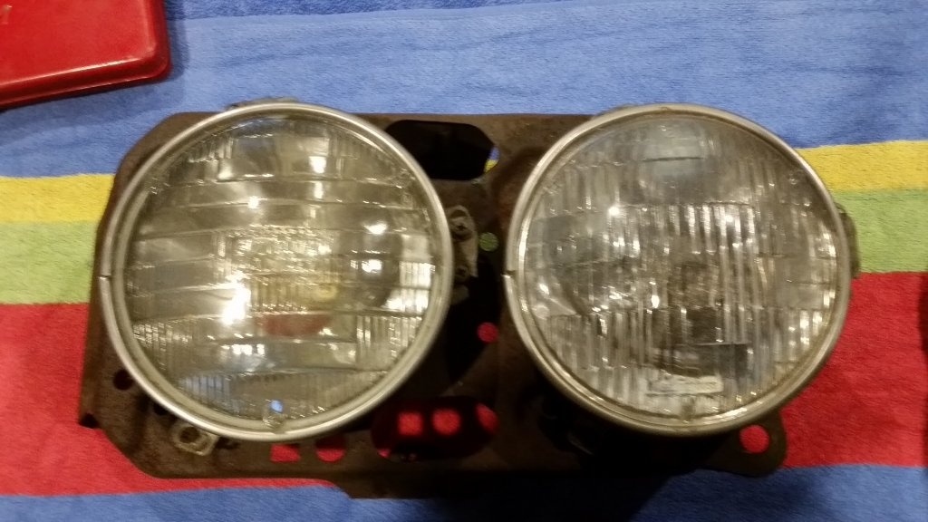

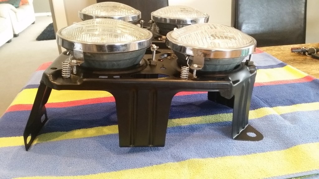

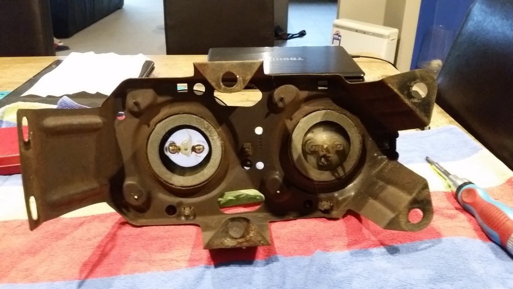

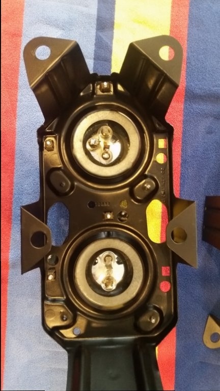

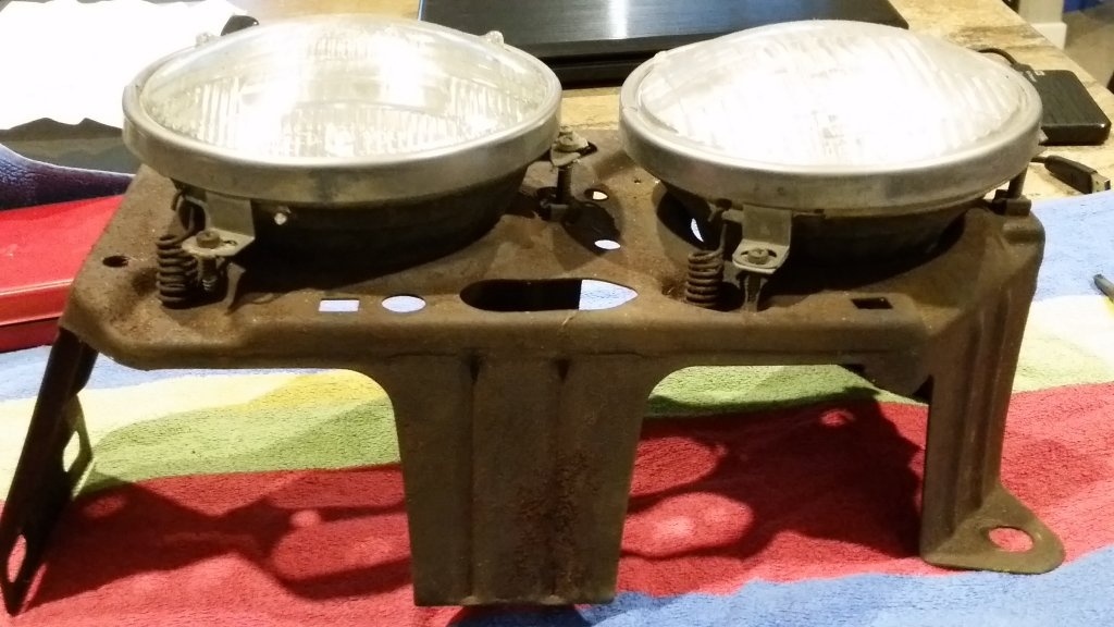

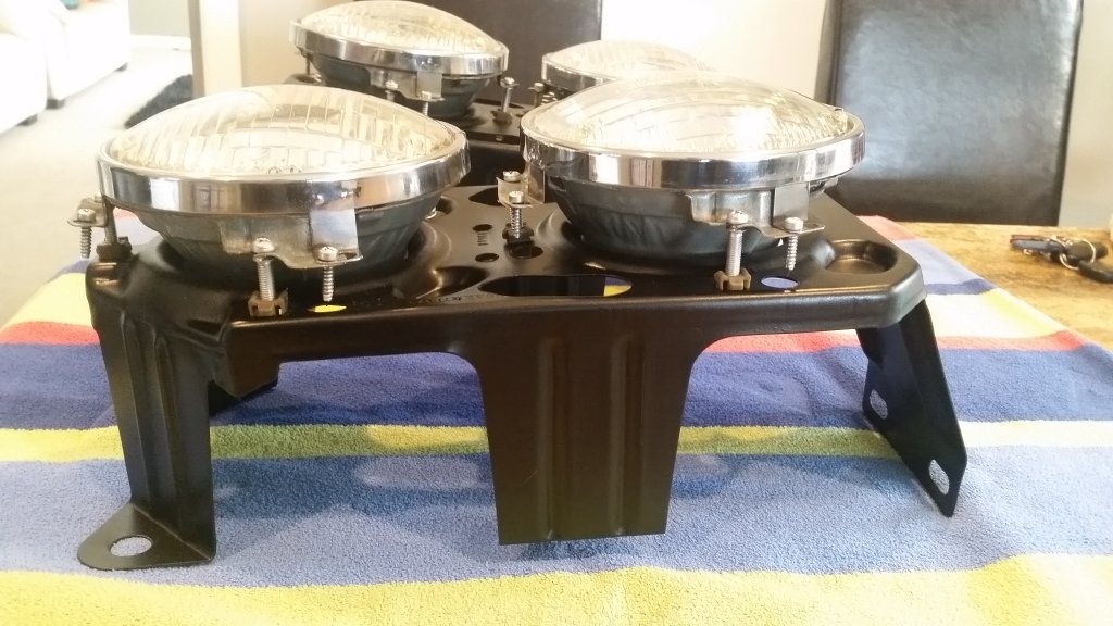

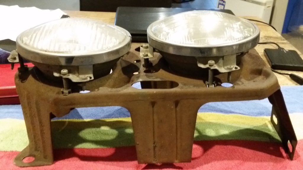

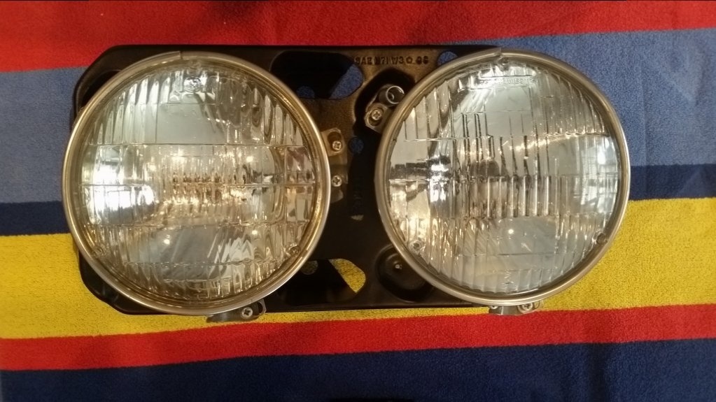

Restored my headlight assemblies. Massive job, took about 12 hours work, but well worth it.
Before and after;

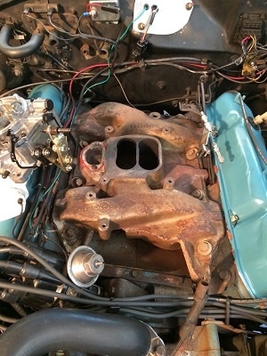

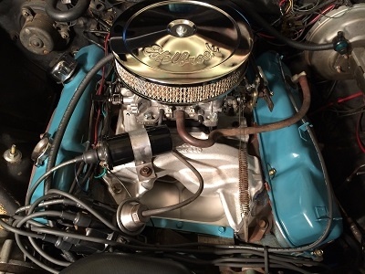

I removed the 1970 intake, confirming the original valley pan was allowing oil seepage into the intake ports. So after scraping, cleaning, and degreasing I installed a new valley pan (with blocked cross-over) and a nice used Performer 440. Weight of cast iron intake = 39 lbs, Performer = 15.5 lbs, 40% of the original.
Before:

After:

After a 24h wait for the RTV to set, we took it for a test drive tonight. It ran a lot better without oil entering the combustion chambers!
I'm also testing the Permatex version of Hylomar around the intake ports, which is supposed to hold up to gasoline better than RTV silicone. Ultra Black everywhere else to seal out the oil.

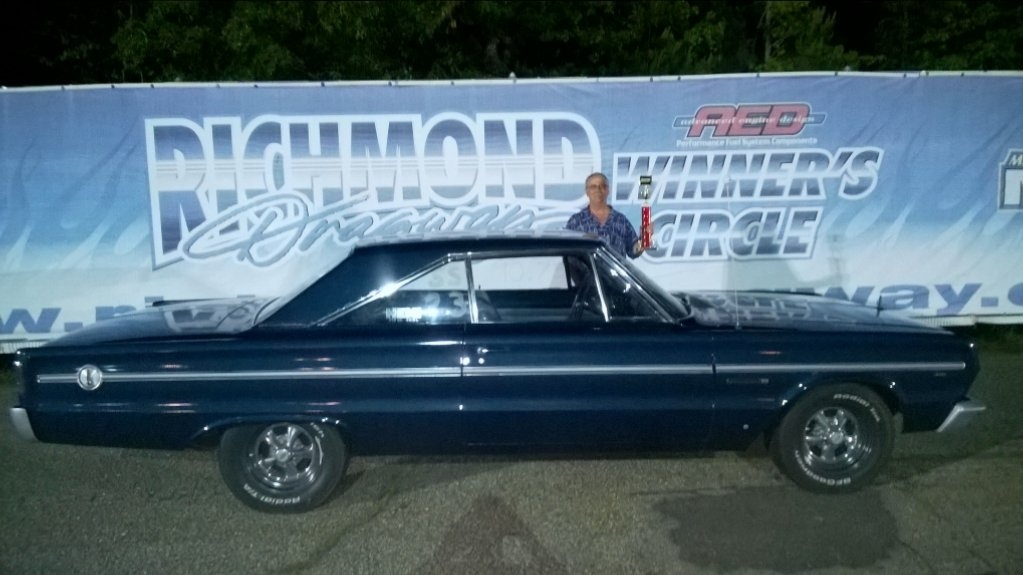

Friday, I drove the Bel 60 miles to the drag strip, took runner up, and drove it back home. Today I'm getting groceries.

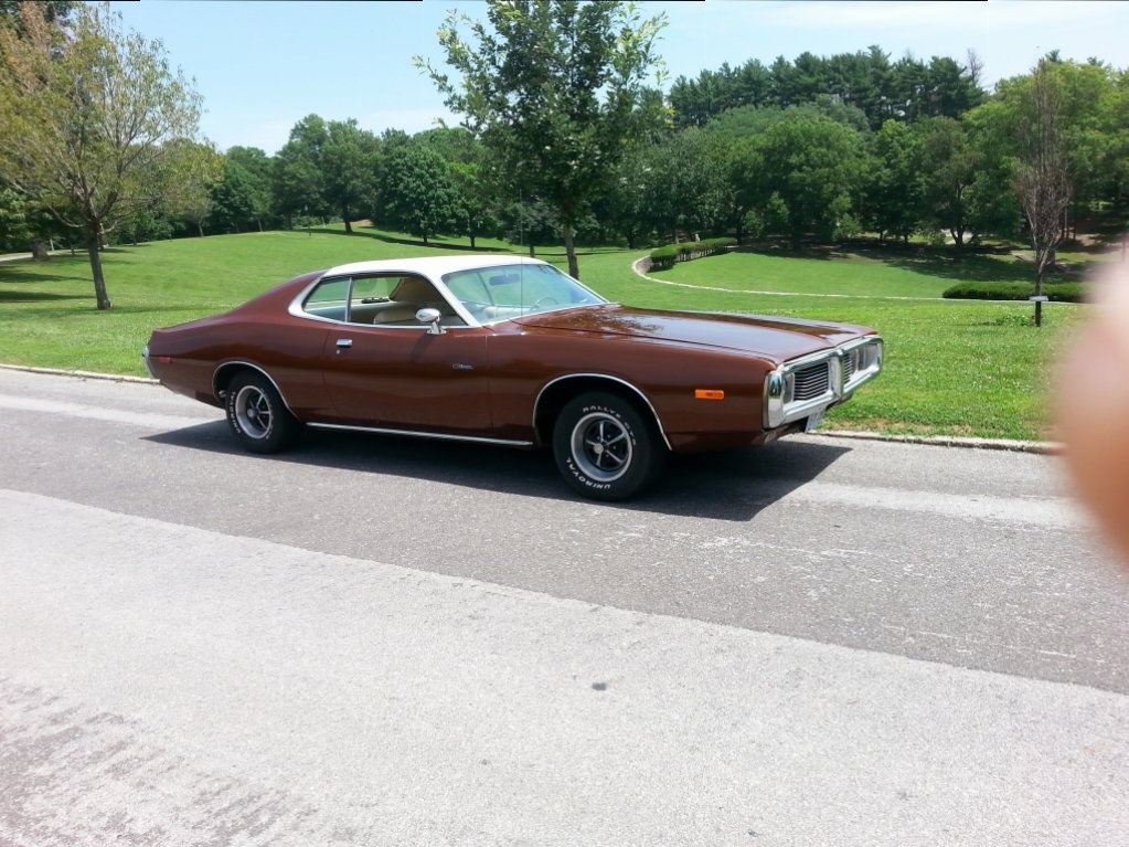

got a wheel alignment done today after a long winter and a complete rebuild of the front a rear suspension so nice to get out and cruse old photo but that's my baby
