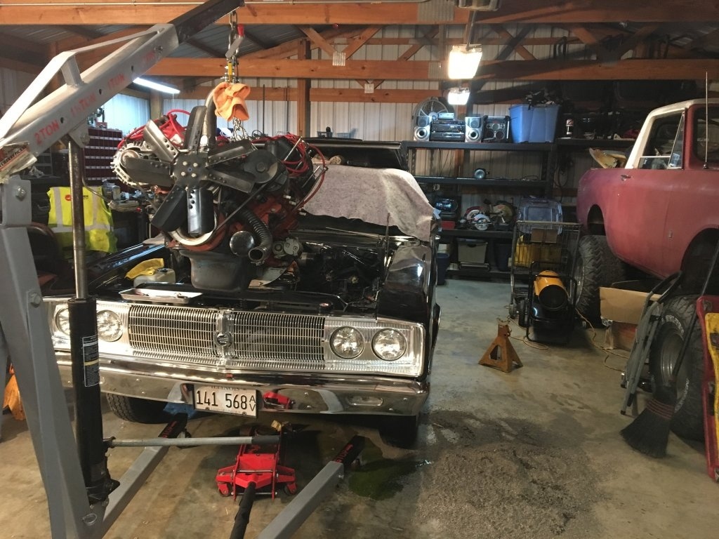

Last night I pulled the motor and trans on the coronet, anticipating the arrival of the 505 short block. Going back to the garage shortly to drop the rear end and suspension to prep for a street lynx 4 link.

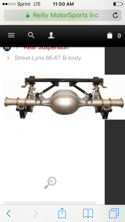

Who did you go through for the street lynx, gotta get mine ordered soon also. Thanks

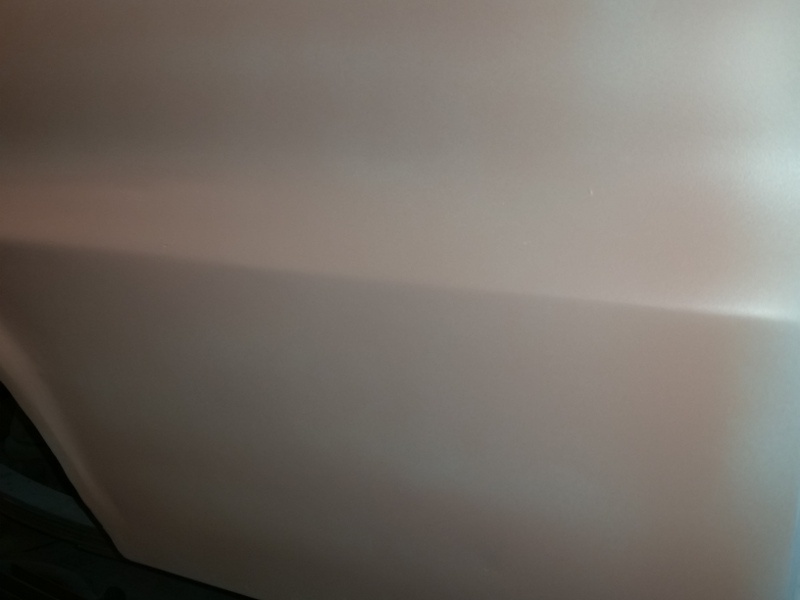

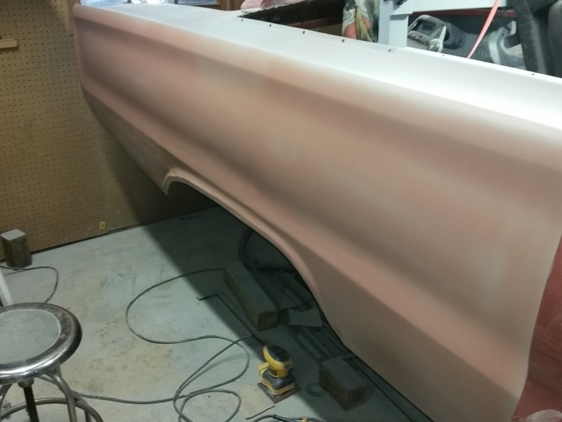

Yet another round of fighting with this quarter panel ( it feels more like a 7/8 panel - dang it's BIG )
Even made some good progress on getting this body line looking more uniform . . . finally . . .
Still got the wheel well lip and behind the wheel that needs a lot of TLC . . . UGH ! ! !

Hey Kahn, that.s looking very good. Props man..

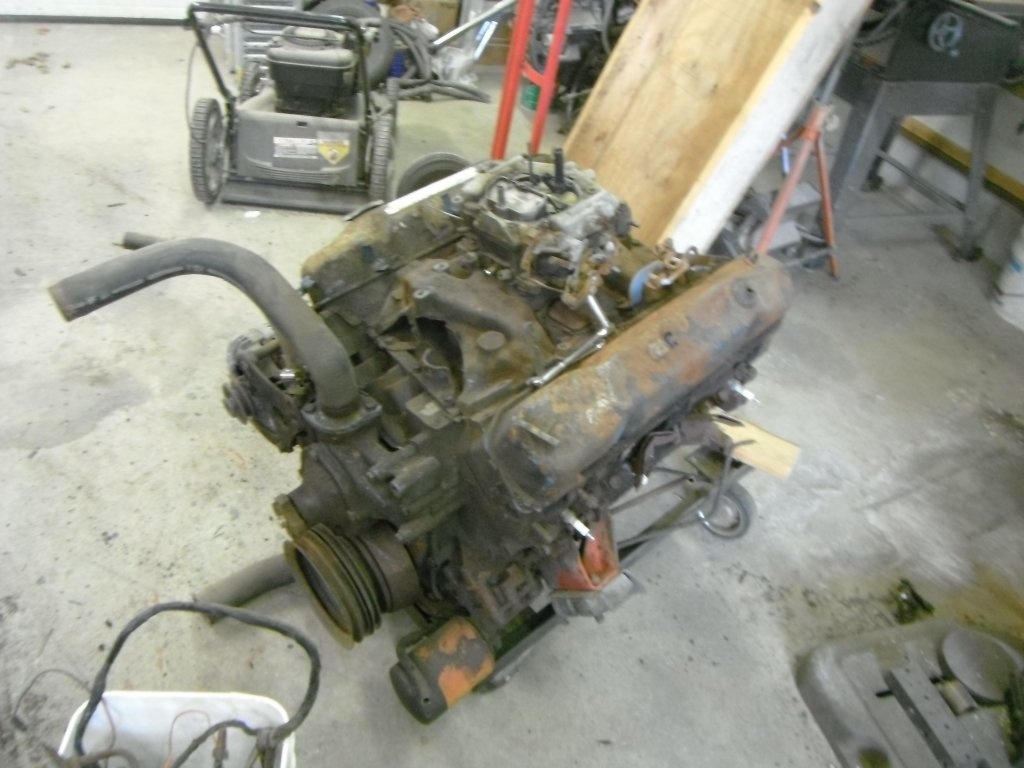

Wire brushed the dirt off that 78' 440 motor home engine, I bought last year. Dissembled the upper end, and was pleasantly surprised to find no ring ridge on any cylinder walls. The guy I bought it off said it had only 24K on it. This considerably reduces the amount the rebuild will cost me, as I was counting on piston replacement. I'm going have her hot tanked, re-ringed and all the bearings replaced. The machine shop I deal with, suggested milling the heads down thirty thousands, and put in a mid cam. I'm building this engine just to have some fun with it. I'm going to take her to the strip a couple of times, but no reason for me to get into any serious racing. Any suggestions on a cam shaft ? I was checking several after market sources, and was surprised that stock camshafts are all the same grind, from the 361 to the 440 applications. I expected different for each CID. Later next week, I'll get oil pan and front cover and pump housing off.
Who's doing the machine work? Your very mopar limited around here.
A machine doesn't know what brand parts are on it. Find a good machine-shop, and have the dimensions ya need. They're all just air-pumps.
I worked for over 10 years as a machinist, true engines are all the same but some guys have a serious hatred for mopars. And just because you have the equipment doesn't mean you know how to use it.
I said find a good machine shop. My parts go to different people, who do different things well. Professionals don't care what they're working on....they want all their stuff to work well.
You haven't had anything machined around Toledo... that's why I said around here. I drive my stuff an hour north just to get good work
Good builders/machinists are scattered around, and usually not where you want them. Other than my heads[10 min from home]...all my stuff is done in a 2-3 hour radius from home. Different parts in different places.

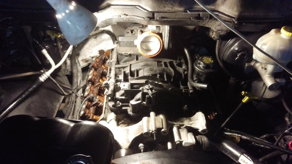

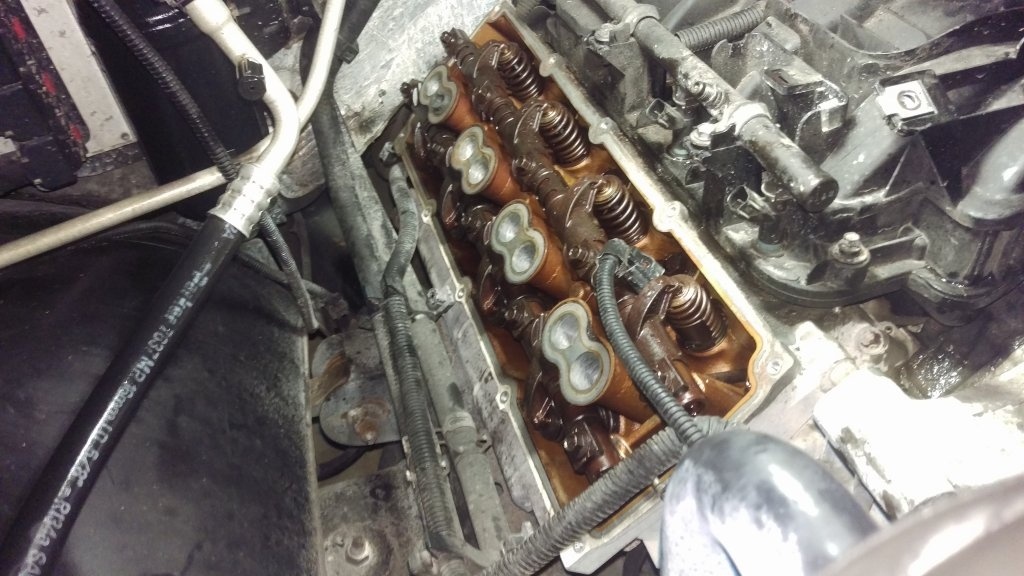

started pulling top end off the 03 ram 2500 5.7 hemi.
It broke a few valve spring s awhile back it's finally time to fix it. What a freaking nightmare of a job! All I have left is find who made off with my drain pan if I had one I could of had them off tonight all I have is one that catches the fluid but it let's it drain threw all the cracks in the bottom !
