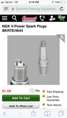

Nice price on the brk7e, gonna try these out.

Now I'm curious, is a BKE 7 hotter(?) and why go there with higher compression?
Resistor type stop 'popping' in radio & the same for everyone near you, including TV's going crazy when you go down the road(at least back before cable)!
7 is colder than a 6. Ngk numbers are opposite of say a champion.
