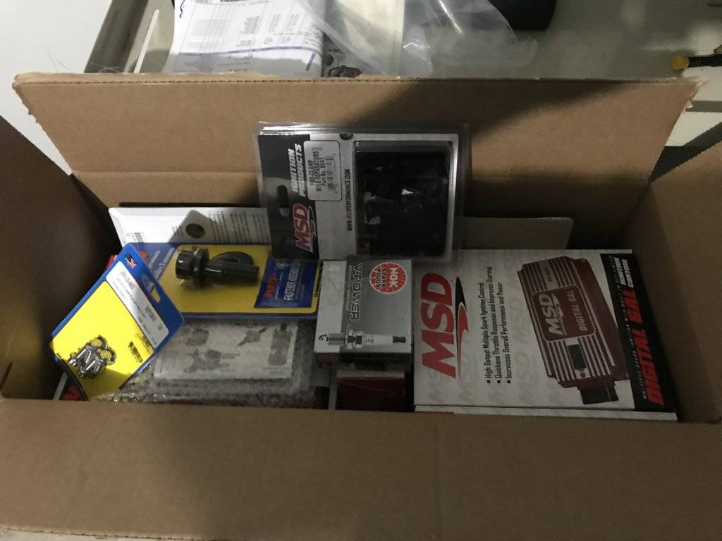

Ok got me some NGK plugs, 180 thermostat, digital 6AL MSD box, plug wires, msd2 coil, header gaskets, ARP 12 pt crank bolt, water pump pulley bolts. That sure escalated quickly
Those NGK 7s should be good. I am using the next step colder 8s in the 500" stroker engine, and 6s in the mild 505" stroker. What fuel are you running?
