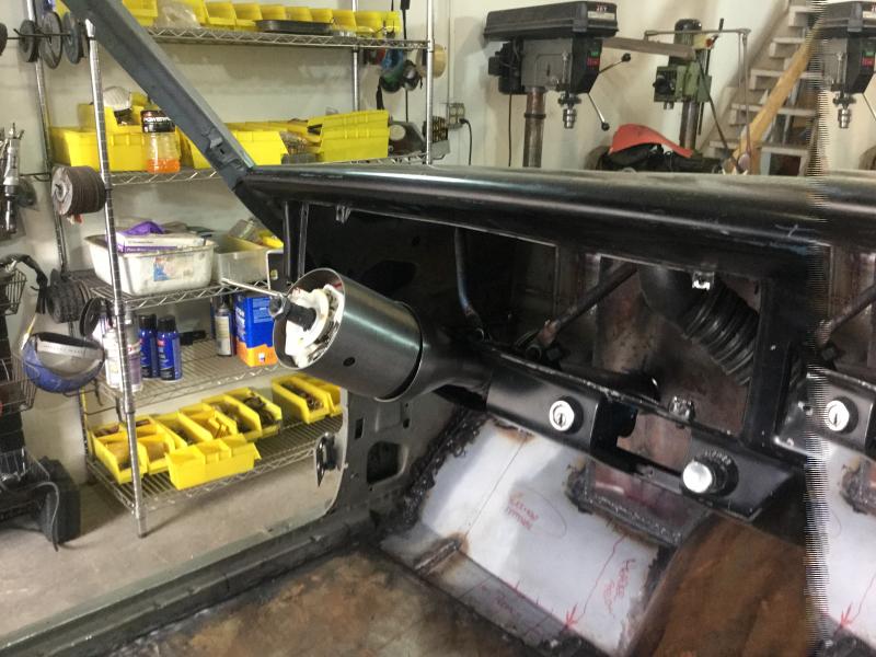

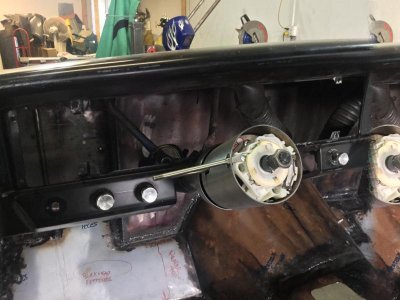

My new Ididit steering column arrived and save for one thing it's a really nice piece; solid and well made except for the cheapy self-tapping screw they use to hold the turn signal in place. Considering what you pay for steering columns I would have hoped for a sturdier solution, but then again how many times do they expect people to install and remove the turn signal arm, that is unless somebody (read: me) is building a car from scratch which means numerous times.
I got real lucky and was able to re-purpose a couple of the under-dash supports that held the original steering column, which may seem logical except I've removed the original clutch and brake pedal assembly along with all their structure so there is very little left under the dash (TONS of room to work under there!!!). Here are some shots of the column in place:

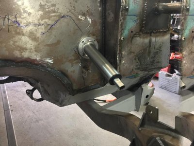

I picked up a Borgeson swivel mount for the firewall; a great piece I'd definitely recommend.​

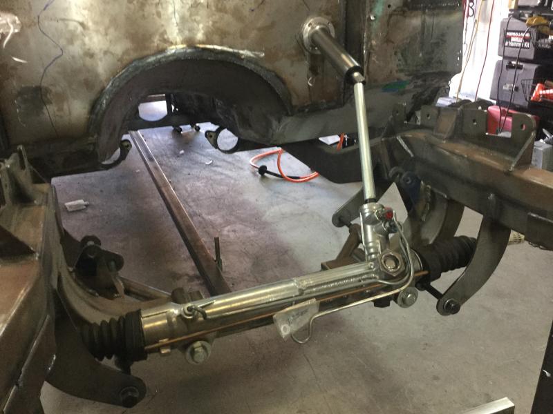

I tossed in the steering rack so I could calculate what length steering rod I'd need; turns out it's pretty short (under 12") so along with the DD rod I'll pick up a couple U-joints and the steering will be done. Not sure if I'll pick them up now or not; there are other more pressing things.​

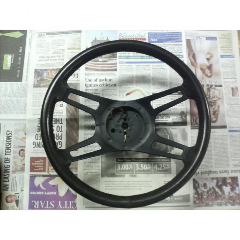

Now that the column is in place its led to some other unexpected issues. I was planning on using the steering wheel that came in the car; it's from a '92 Ramcharger and I love the look and size of it, but with its approximate 5 1/2" depth (measured from the mounting surface to the wheel itself) it really intrudes into the seating position, which in turn forced me to move the driver seat farther back than I'd planned, which meant moving the roll-hoop farther back than I'd planned. Whew, that's a bunch of "farther back".
Here's a shot of the Ramcharger wheel:

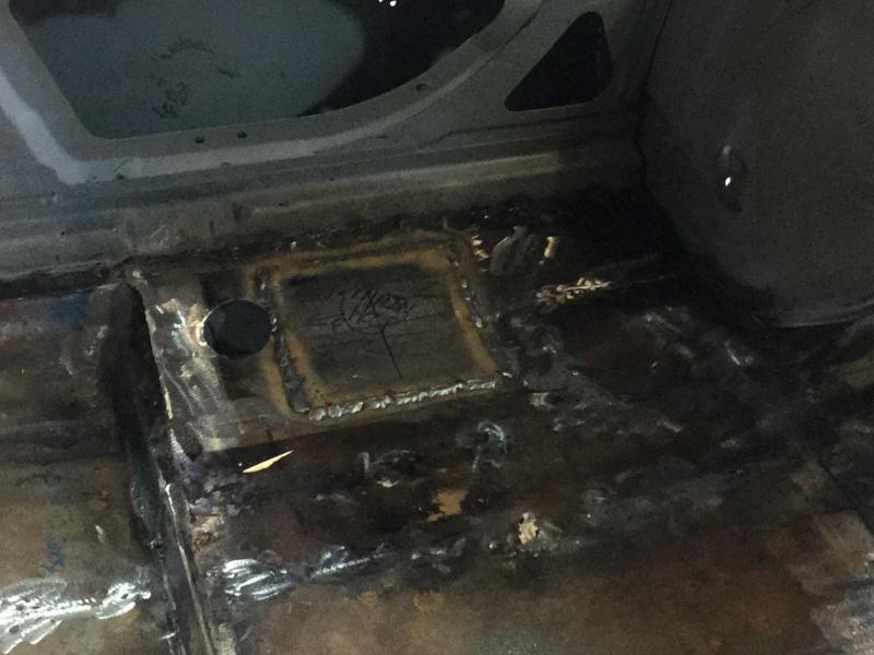

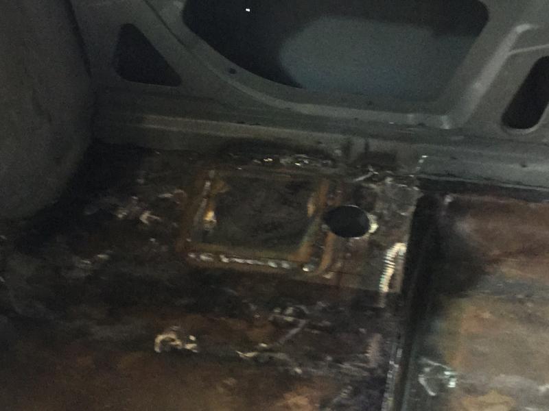

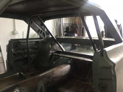

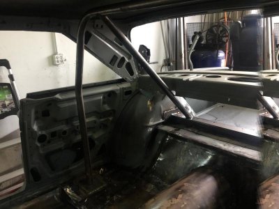

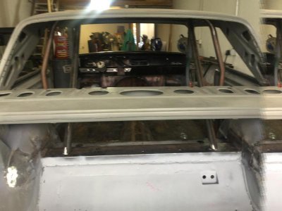

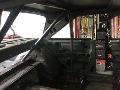

With all that "farther back" going on I went ahead and mounted the roll-hoop pads, which you'll notice are 2 1/2" behind the holes in the floor, which the pads were originally supposed to cover. In case you're wondering, the holes in the floor make test fitting, installing, and welding the roll-bar a BUNCH easier since it allows you to lower the top of the hoop away from the roof.
It's kind of tough to see but here are some shots of the roll-hoop and the two rear bars mocked into place. I'm going to hold off on the permanent install for a while to give myself easier access. I think it will pay dividends in the end but I had to mock things up now so I could figure out the seat location, which then allows me to figure out the pedal position as well as which steering wheel I'll be able to use. Dayammmmm, building this thing is like a puzzle; until you figure out one thing there are three other things that have to wait!

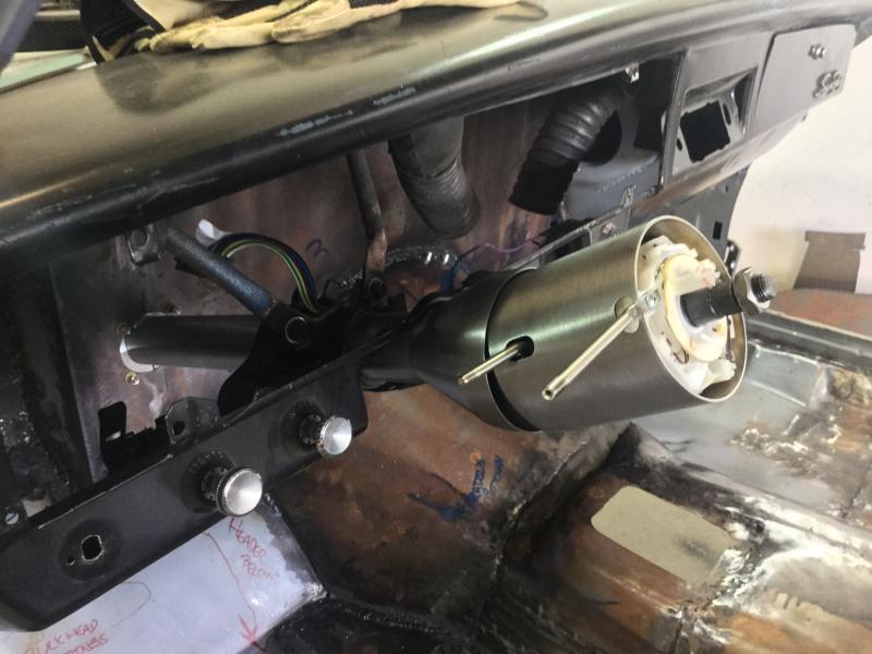

Here's the column locked into place inside the cabin:
Here's the view from the engine compartment:

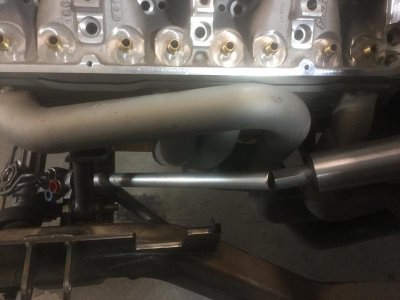

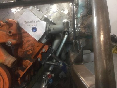

Once I got the column in and mocked up with the steering rack it looked like it was going to be a tighter fit than I'd originally thought, so I decided to put the engine/trans back in along with the head and header.
The first thing that became obvious was the need to slip the header in from the bottom, but no big deal. Once the header was in I bolted it up tight and while it's a little tight there is WAY more room than I've had in other cars so I'm good to go. Here are a couple pix of it bolted together:

Want to say that I have used several Ididit columns and learned quickly that the wiring is not covered along where the column tilts and will wear through and short out. You may be wise in unscrewing the turn signal switch and checking this before further assembly. My 02 cents.

The column is still apart so I will definitely pull the turn-switch out and take a look, but just so I'm looking in the right place, are you suggesting to trace the wires down inside the column to the tilt area and check for problems down inside?

On a factory GM column, it has a plastic sleeve over the wires to keep them from rubbing on the column. Unless Ididit has changed their ways in the last couple years, the wiring is w/o this sleeve and rubs the wiring raw in a few months. Yes check the wiring down where the column tilts. Currently, I'm not building a car as my mother is elderly and failing in health. I do have a nice original 64 Sport Fury but isn't anywhere near a show car........just a nice original. Also, I'm sure these Mopar folks don't care to look at my Sevenlitre Ford!

Thanks for the heads-up; you'd think Ididit would include the proper sheathing to protect the wires, and if they haven't I can't imagine this is going to be much fun :-(

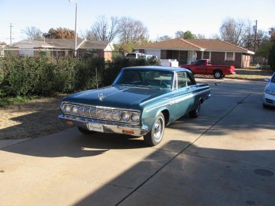

Terrific looking Fury; what's the drivetrain?
361,727,8.75
You should be able to tape the wires or find the plastic covering from a factory GM column.
In looking back, I have installed at least five of these columns and have yet to see one that had the covering from Ididit. After the first one, I have always looked and repaired before the car left the shop.
