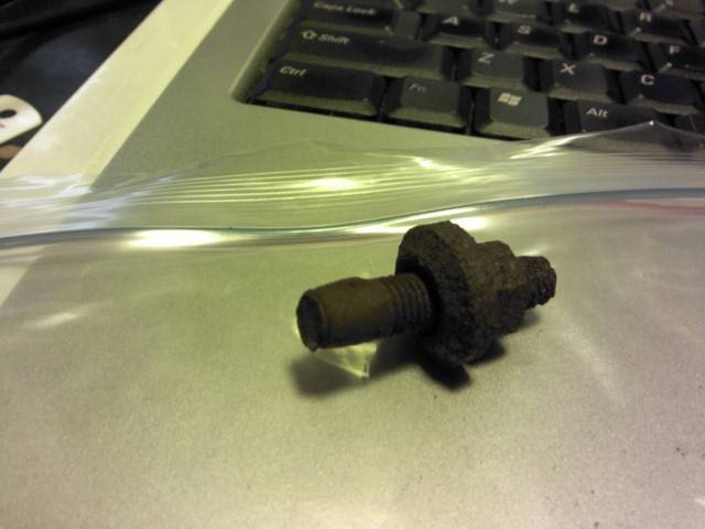

So, I stuck my hand around the back side of a header and sure enough there is an exhaust manifold leak, But it gets worse... The bolt, Or should I say Bolt HEAD is wobbling around and I grab it with pliers (Hot!) And pull out the broken bolt head...
Needless to say I'm not looking forward to do a whole upper rebuild just because of a stupid broken bolt. And who knows how many more could break if that one did randomly...

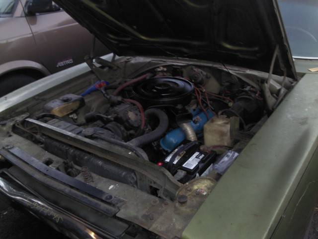

And I leave you with a engine bay pic:
Cleaning up real nice. Sounds like you have a weak spark plug wire or a broken wire back there arcing. Looks like that hood insulation has seen it's better days. Broken bolt issue,yeah I've had those. All you can do is try and take the rest off them off to get it out. Hopefully they all won't break, but if they do you know they'll be new going back in and last awhile.
Really pretty bummed about the Broken Bolt.
With how much length is on the broken bolt head it's probably going to be flush or down inside.
Had not planned on taking the heads off any time soon, But Looks like I'll have to... Anyone know any other options? I'm sure there isnt unless it has some sticking out, But thought I'd ask anyway.
I'm gonna "spray soak" the bolts in wd-40/break free stuff for awhile before I attempt to remove any others.
Here is the culprit:
Sure looks like it broke off right at the head. About all you can do now is spray, soak, wire brush the threads, repeat for the other bolts/nut. For the one that is broke off, you might have to drill into what's left of the stud and try and use an easy-out to get it.
