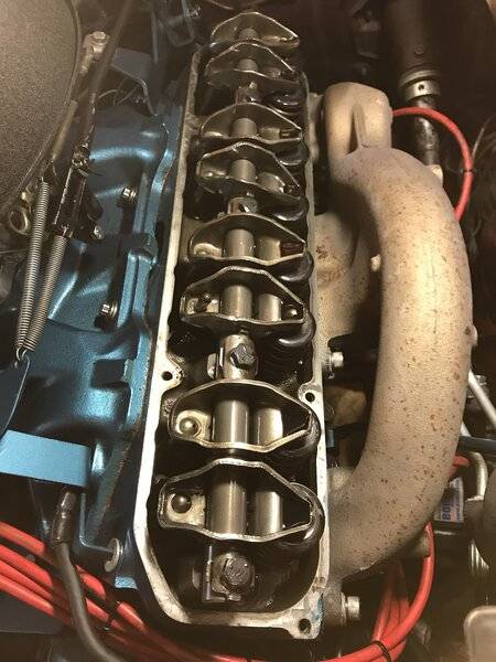

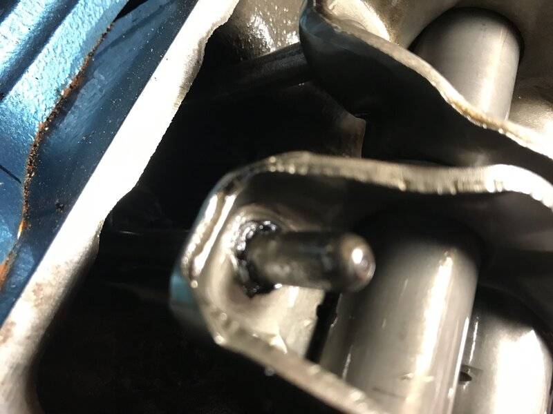

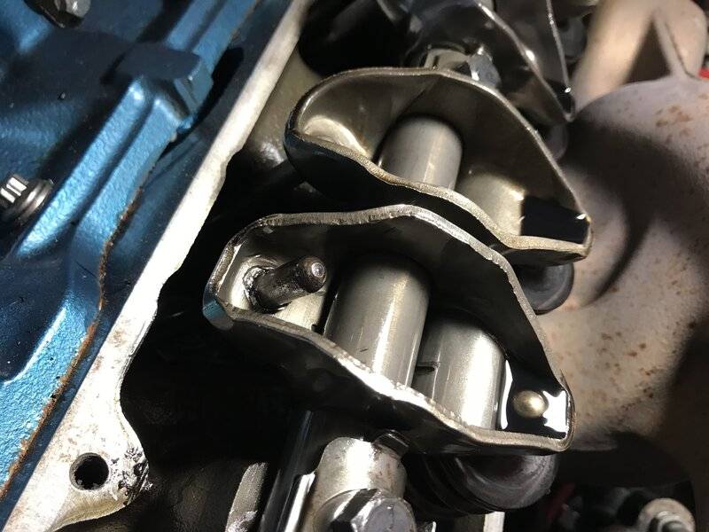

Hello. Greetings from Scotland! New to this site and wondering if anyone can shine some light on why the pushrods on my recently rebuilt ‘68 Charger keep punching through the Melling rockers? The car has done 2500 miles on the rebuild and popped a rocker on cylinder #5 six months ago. All 16 rockers were replaced and last month a rod pierced the inlet rocker on cylinder #5.
The pushrods have both pierced rockers on the inlet valves and the first time on cylinder #5 the exhaust pushrod was also slightly bent. I haven’t manage to check the exhaust rod this time.

First, I would check that you are getting oil to that rocker, then I would make sure
that the valve isn't hitting the piston ever so slightly. There's no discoloration, so
I'm pretty sure the oil is O.K. The next thing is to check the hardness of the rocker
arm. You can half-*** do this by trying to file the area closest to the pushrod cup.
If you can file one or two, but not the rest, it's a bad heat-treat. Try filing an OEM
rocker and see how hard it is! Hope this helps!
What's the cam specs?
I'm wondering about coil bind, guide to retainer clearance.. things like that
On a 318 I put the rocker shaft in up side down not enough oil. Above posts are good advice
Young man came to me many years ago with the same problem. Said he was in the next town over the other night and the engine developed a miss.
So we pulled the valve cover and there was the pushrod sticking through the rocker arm.
I asked, "Did you win the race?"
"Yes", he says and smiles.
"Well quit racing and this will stop!"
Coil bind or soft rockers. If it was lack of oil there should be heat discoloration.
Have you changed the cam and lifters? If so, do you have the correct length pushrods to obtain the proper lifter preload?
As said coil bind, excess spring pressure, excessive cam lift.. I assume all 16 valves have the same springs. Any ideas on closed and open pressures? Were the guides new or knurled. I ave seen knurl jobs go bad and bind the valve stem.

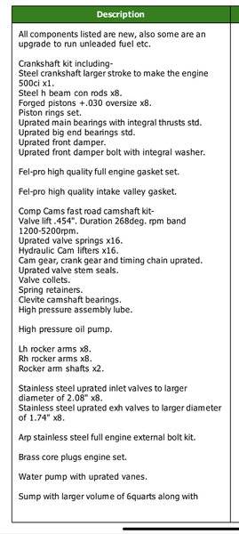

As I said, I’m no mechanical expert…in fact I’m not even novice standard…but here’s some info the rebuild engineers gave me:
Bore: 4.350".
Stroke: 4.150".
Gasket thickness: .048".
Gasket bore: 4.420".
Piston: .008" below deck @tdc.
Piston cut out volume: 6cc.
Combustion chamber volume: 78.6cc.
Head casting No: 4006452.
Valves: 2.08 inlet / 1.74 exhaust valves.
Static comp ratio: 11.24:1.
Very grateful for your input.

Thanks again. Can you establish any more from this list of internal components please?
What fuel are you using in this engine? I think you are lucky that the only problem so far seems to be pushrods punching holes in rocker arms. The cam, compression ratio and cylinderhead combination is.......uh.......politely........not optimal.
2.08/1.74 valves are factory stock sizes for that 452 cylinderhead.
