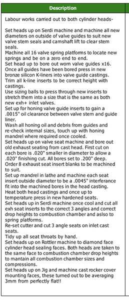

For anyone curious as to the modification of the 452 heads please see the description in the photo and feel free to comment.
