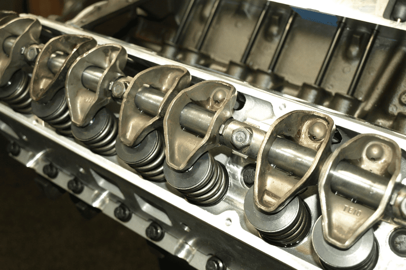

I believe they are correct.
440 Source had no answer for me. (They are usually very helpful)
Are you talking side clearance? You can clearance them to center them on the valves, but Im not aware of any spec for side to side

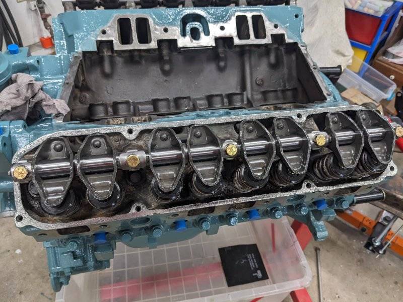

My point exactly. There's no reason at
all to be grinding anything on a stock
engine setup.
Just did this on a 440. All new rocker
arm assemblies, stock pushrods, and
lifters.

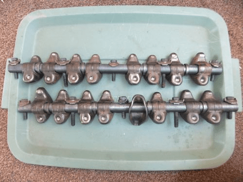

1968 383. I did not have the original rocker assembly so I decided to buy new.
No pushrods installed. The new rockers rub tightly to the spacers.
Thanks
How I would deal with it……..
Grind a little off the tabs on the hold downs until I had .010”-ish clearance for each pair.
did you oil them a bit before installing them? I'd rather have them a little tight than loose to start with, IMO. if so check your spacer's orientation, then clearance the side a bit as stated above.
