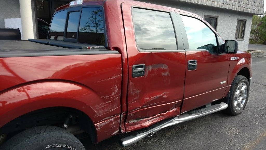

My turn today
it should be at the shop of YOUR choice...... and they work for YOU, not the ins co.
14g's. lots of cab work.
I bet that cab corner is less than 400 bucks, and about 10 hours labor....... I'd say it occupies less than 1500 dollars of the repair including paint and minor door jamb and rocker BS
I bet that cab corner is less than 400 bucks, and about 10 hours labor....... I'd say it occupies only about 1200 dollars of the repair including paint and minor BS
plus a new bed and 2 new doors plus labor and painting...
The front door only has a 3" crease, so that can be fixed, but I wouldn't be surprised if the quarter panel on the bed has to be replace.
I guess we shall see...... I ran 2 collision shops, insurance companies are reasonable, but they don't give away money for what is unnecessary....... that bedside is a straight forward replacement, about 3K....cab corner 1500...... 2500 tops to repair a door and replace a door......add in some bullshit and sales tax get you to 10K tops......
unless labor rates are significantly higher in his area, and I am missing something major
just my opinion based on a picture and my experience, getting it to a quality shop is the most important factor

Here in Cali, flat rates are highest in Country & Nor Cal higher than So Cal. Hard to make an accu judgement off a couple pix. Plus i think that with that color, if bedside is replaced, a blend in base color & overall re-clear will have to be done on tailgate & ditto on front right fender,(butt match no good)effectively a complete repaint on right side of truck. Out here, that alone would put a healthy tally on the sheet.
The rocker rail is most likely a replacement too...though it doesnt look it, the center pillar/door post may have gotten a push too.

yup, you don't really know until you get into it....... the adjuster will only write what he can visually see....... supplements are easy and usually only require pictures of labor and old parts; and receipts for new parts.......
a good manager will make sure every job is worse than it actually is...... :D
